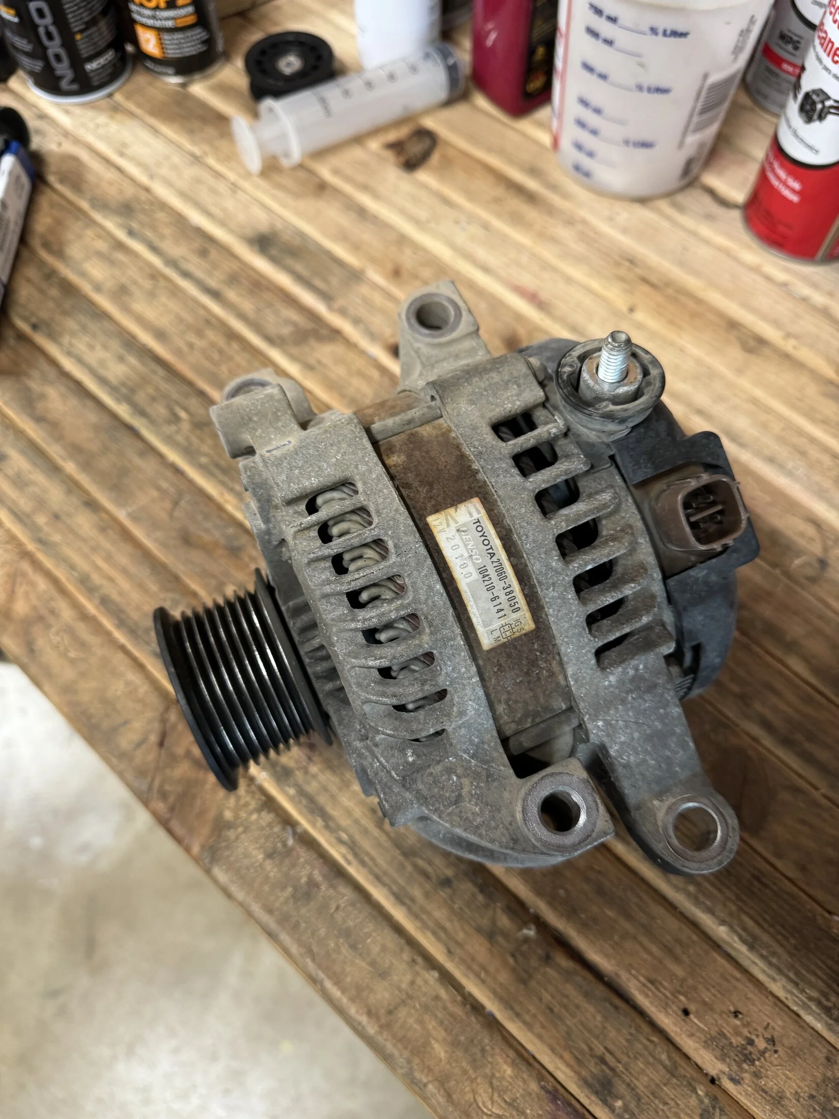

When I did my engine, I also did starter, radiator, rear main seal,,and belt/tensioner. The valley plate had to be swapped over anyway so it took care of that and I elected not to mess with the cam towers. Should have done the alternator too since it went after another 2 years and is a bugger to do.
If the alternator bearings are in good shape (which is usually the case for us) you can change just the brushes and get a lot more life out of the original unit for a fraction of the cost of a full replacement.
Unless you've been beating the crap out of it pulling big amps at low RPMs, which could stress the diodes..
