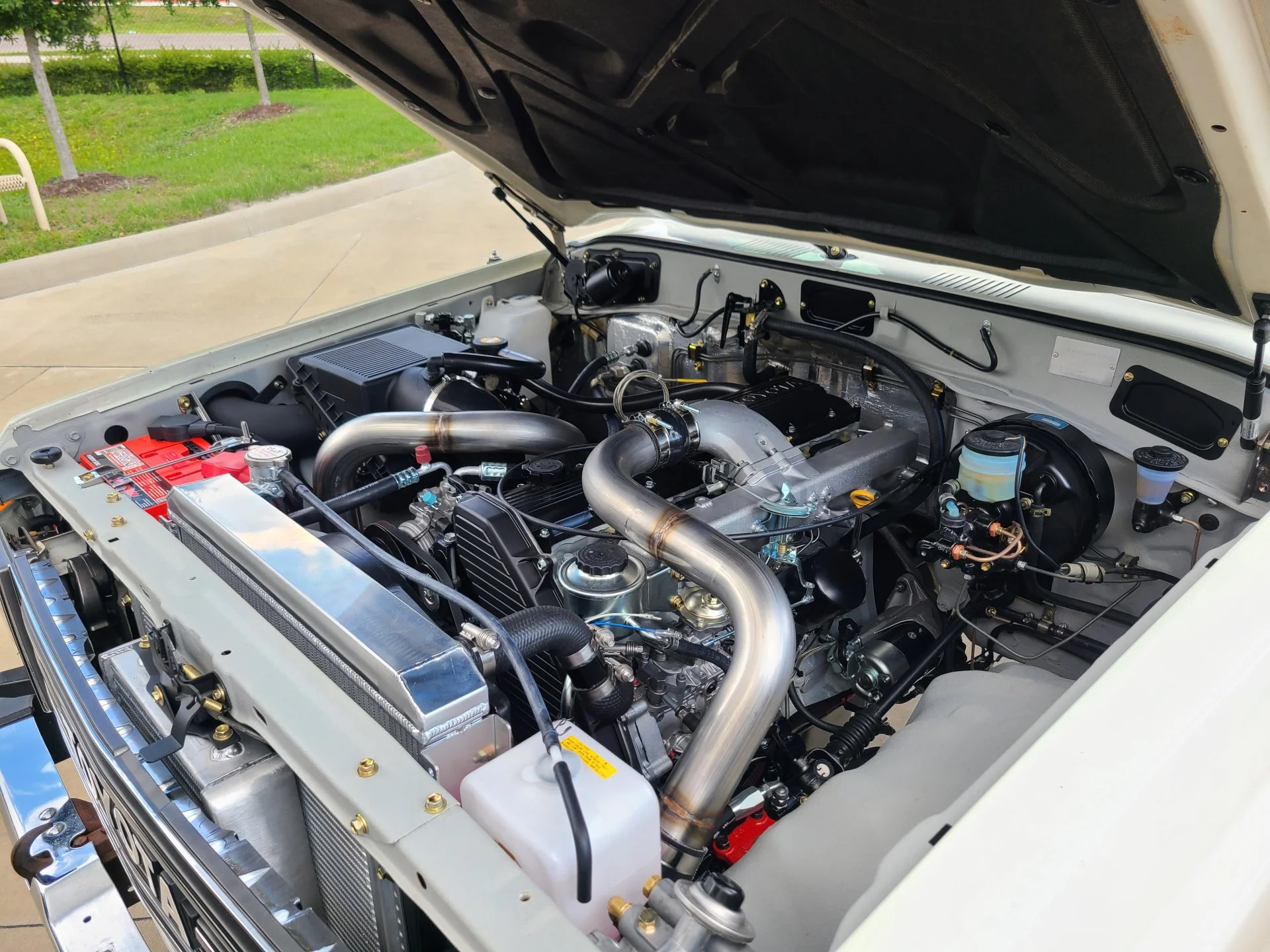

Fixed my fuel leak, got my AC all set up.....painted the airbox lid(added some different clamps to the inlet side of the air box) and started the downpipe. Next week is going to be devoted to the exhaust and then it's time to start driving this thing :)

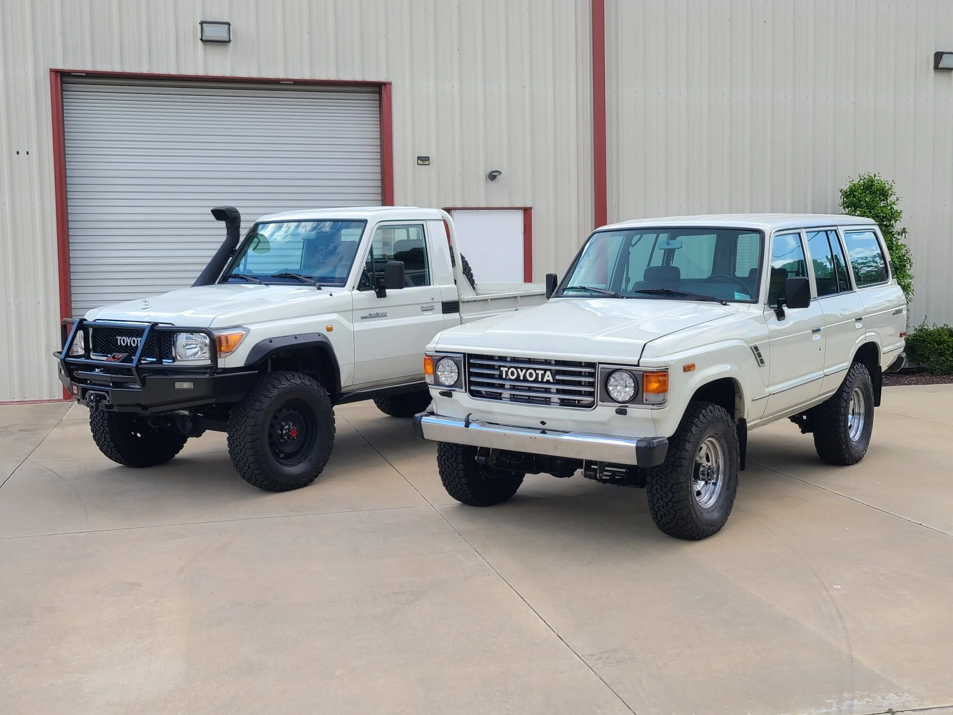

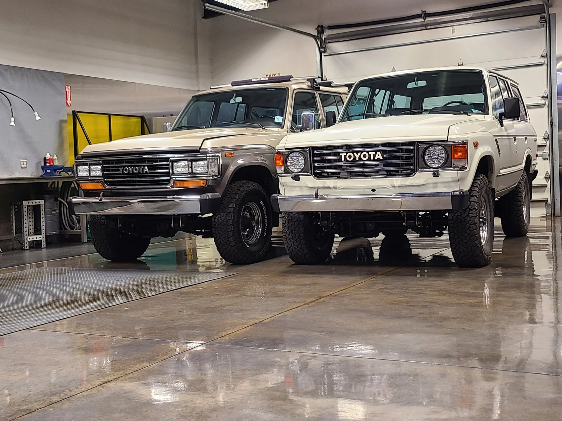

Had the 79's paint corrected and then ceramic coated.....grabbed a quick pic with it. Need to adjust the hood on the 60...and we need to get our brackets built so we can start selling our hood strut kits.

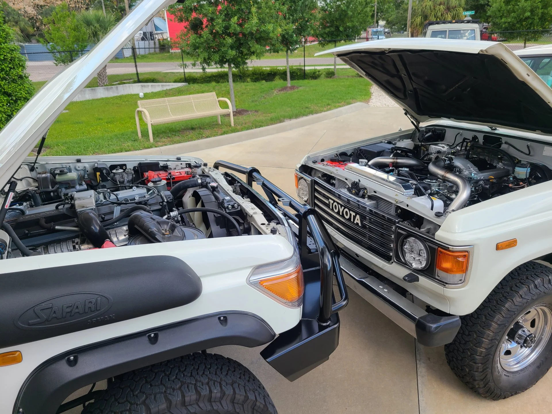

Nothing to see here but a pair of 1HZ turbos

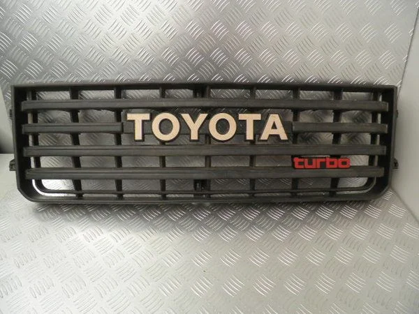

Are you going to put on one of the 60 series grilles that has the diesel or turbo badge on it?View attachment 2982901
I think I have a diesel badge on a shelf.....I also think I had to grind off the mounting spots for it off the grill to clear the IC. Pretty sure I can figure out a way to mount it. OR....not mount it and keep it a sleeper :)

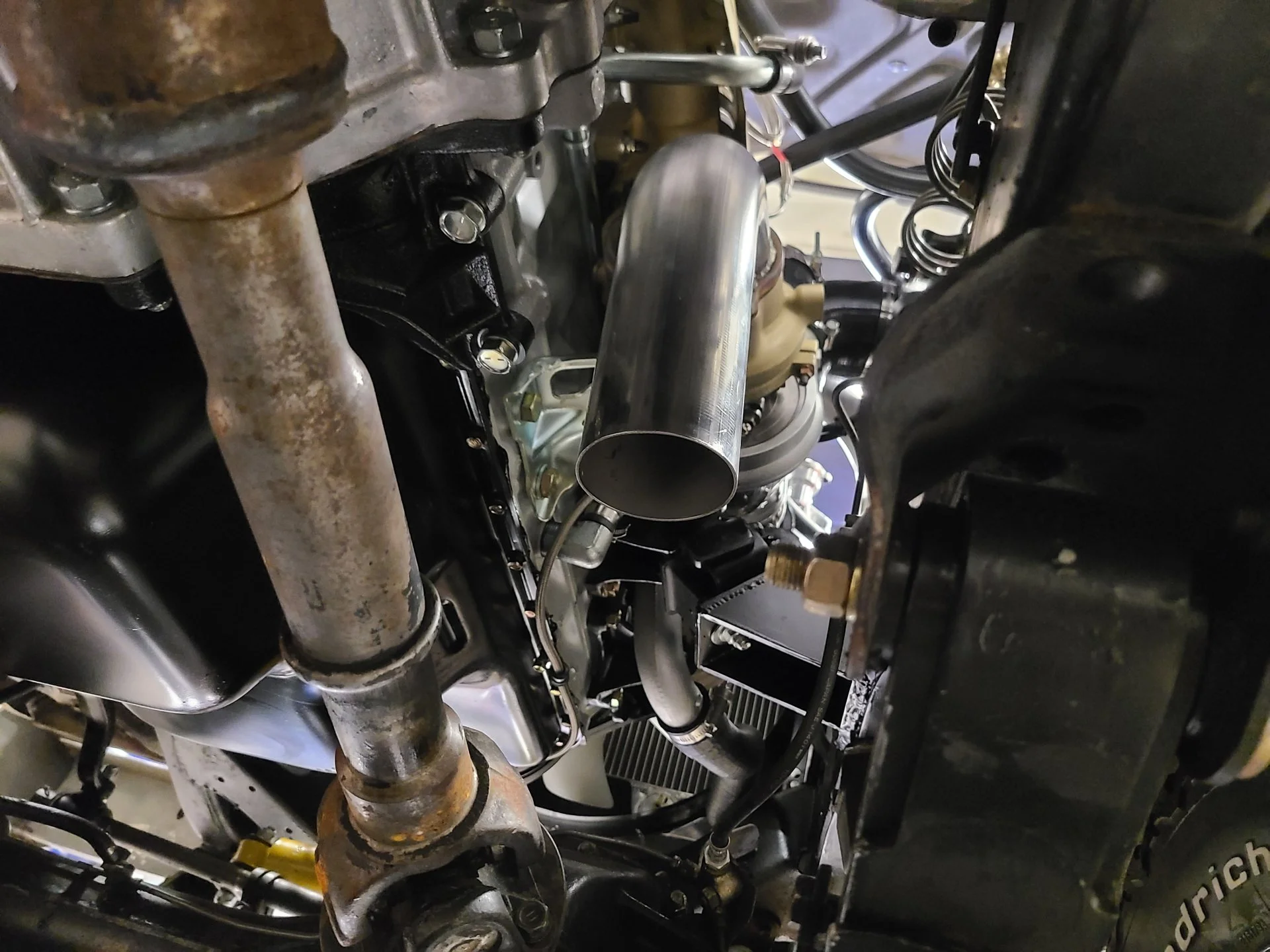

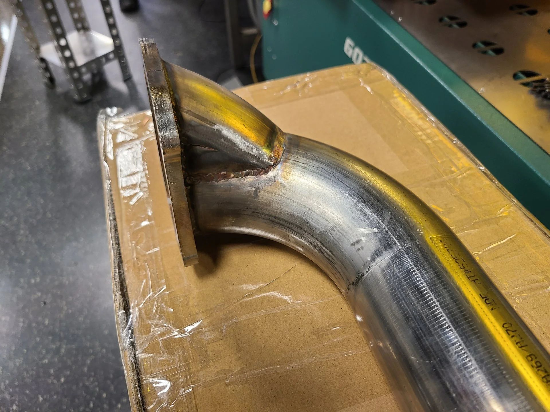

Had my lead downpipe fabricator fab me up a downpipe today....same setup we have used on the other trucks. I think this was a Mamba flange. Tomorrow we'll start the process of building the exhaust.....will take some time but will be beautiful.
The start
The lead downpipe fabricator
Missed some in-between steps.....here's the final product.

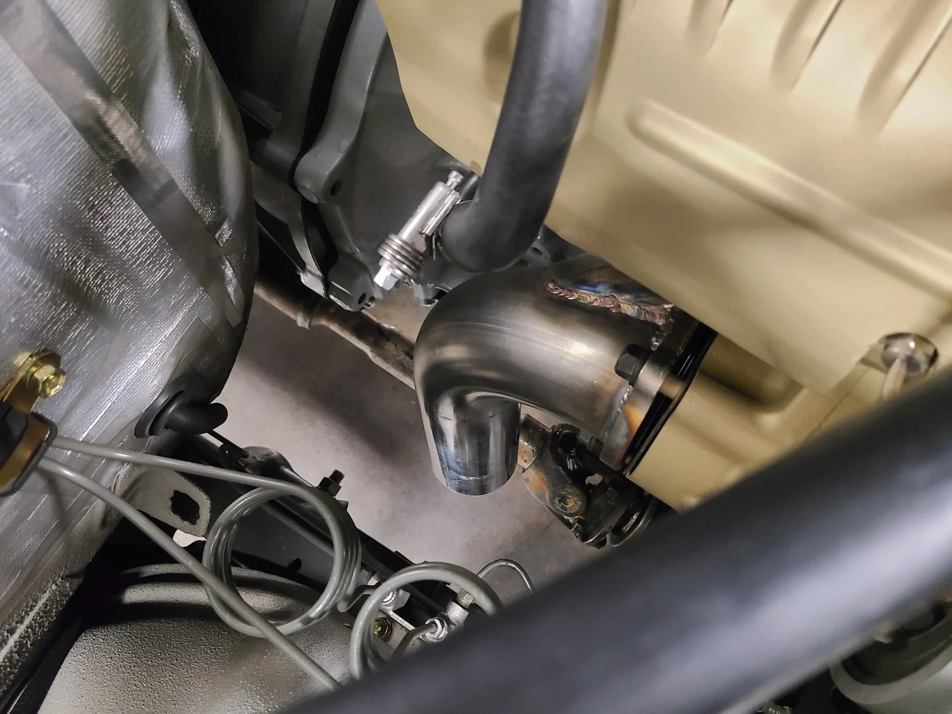

Pretty easy routing on this motor....straight down and then a 90 will take it thru the spring hanger to get us down the rocker.
