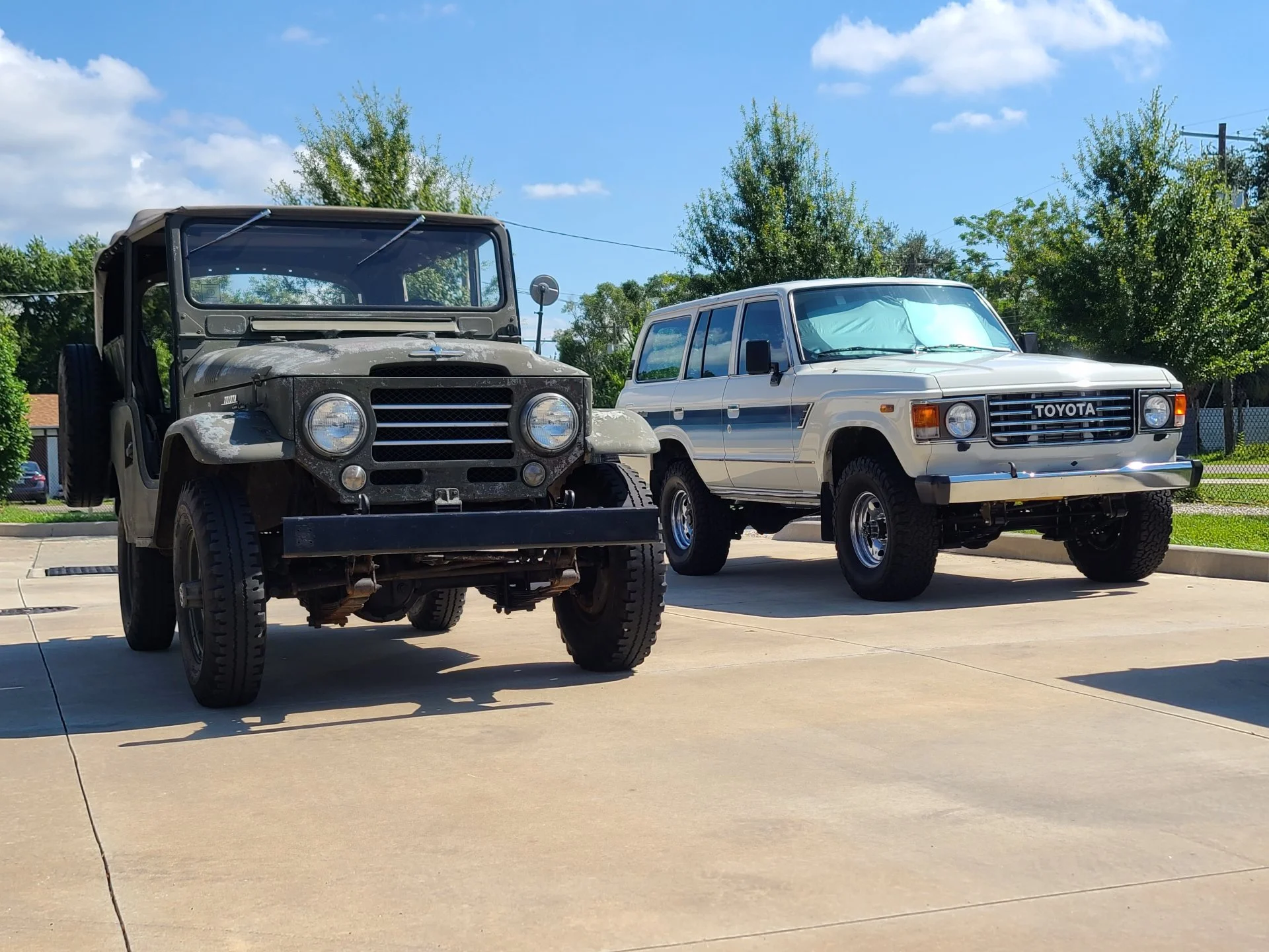

The 60 got to be a shop truck today.....took it to go pick this thing up at the alignment shop. Kind of funny......we started the 60 project the same time we started the McLaren build....today they were both on the road for the first time....out of the safety of the roads around the shop :)
The 60 kept up with the McLaren no prob. Kind of.

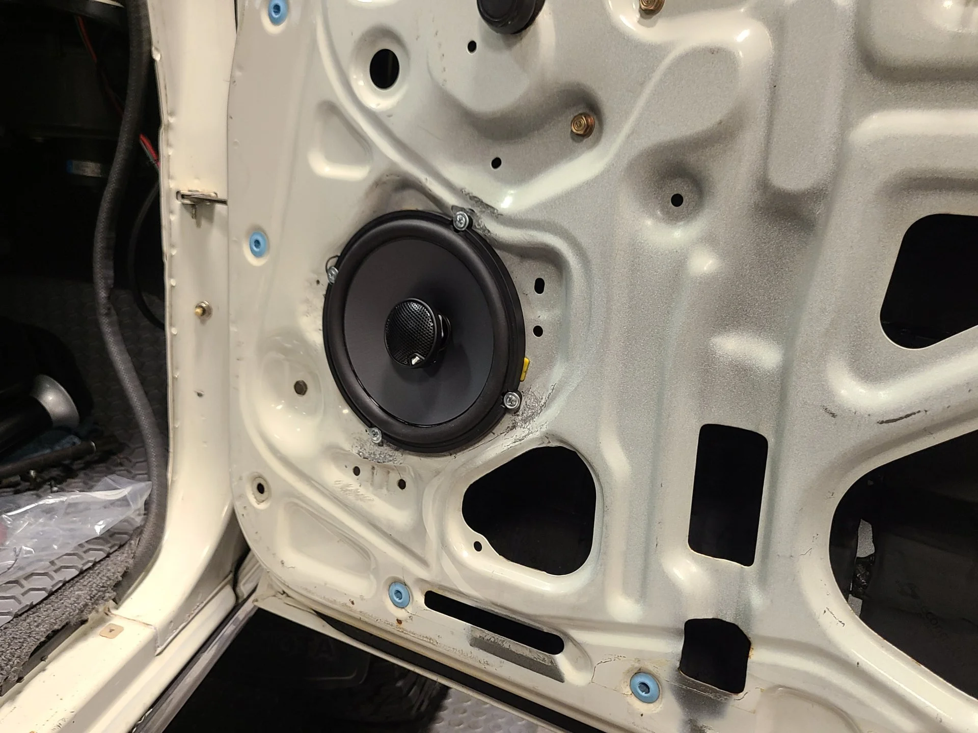

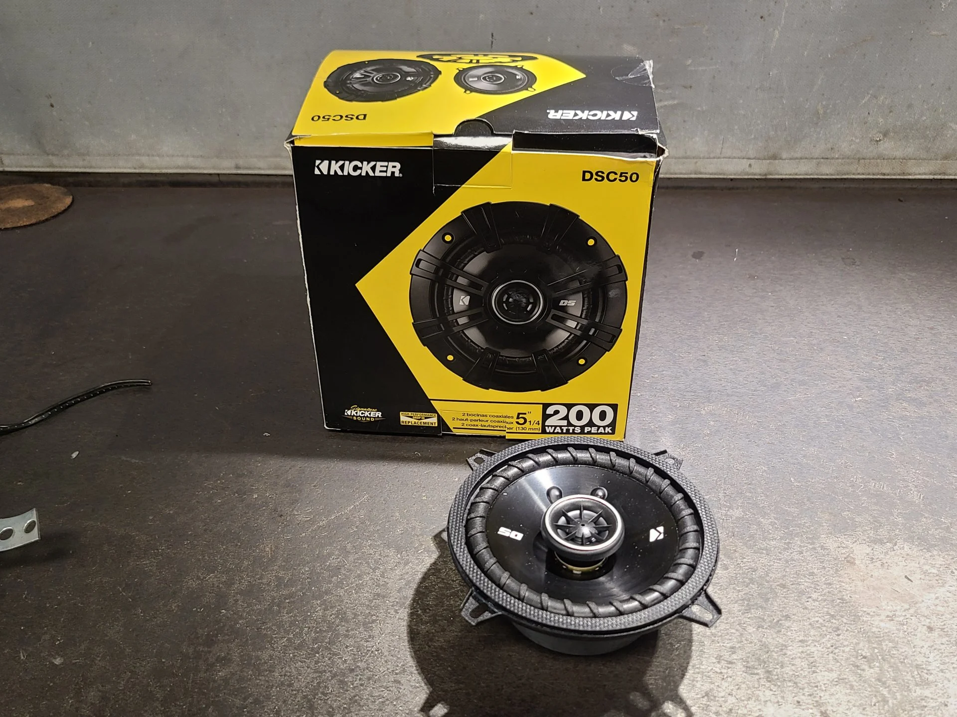

Minor stuff.....played around with adding some better front speakers. My truck had some old component stuff that was bothering me. Thought I'd do a 5 1/4" speaker like others have. Would have been easy. Somehow I don't like easy.
This is what I was going to go with
This is what I went with....6.5" JBL GTO shallow mount speaker. I run these in our other trucks and I think they sound really good in them. Had a set so I figured I would try to make them work. They are almost exactly as deep as the Kickers....very very shallow.

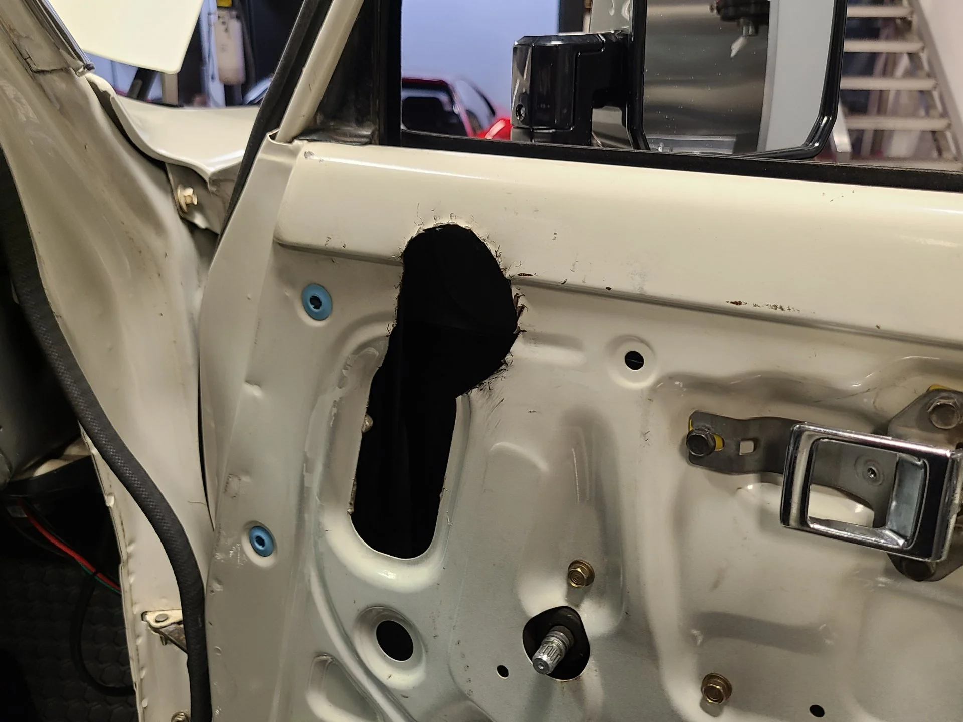

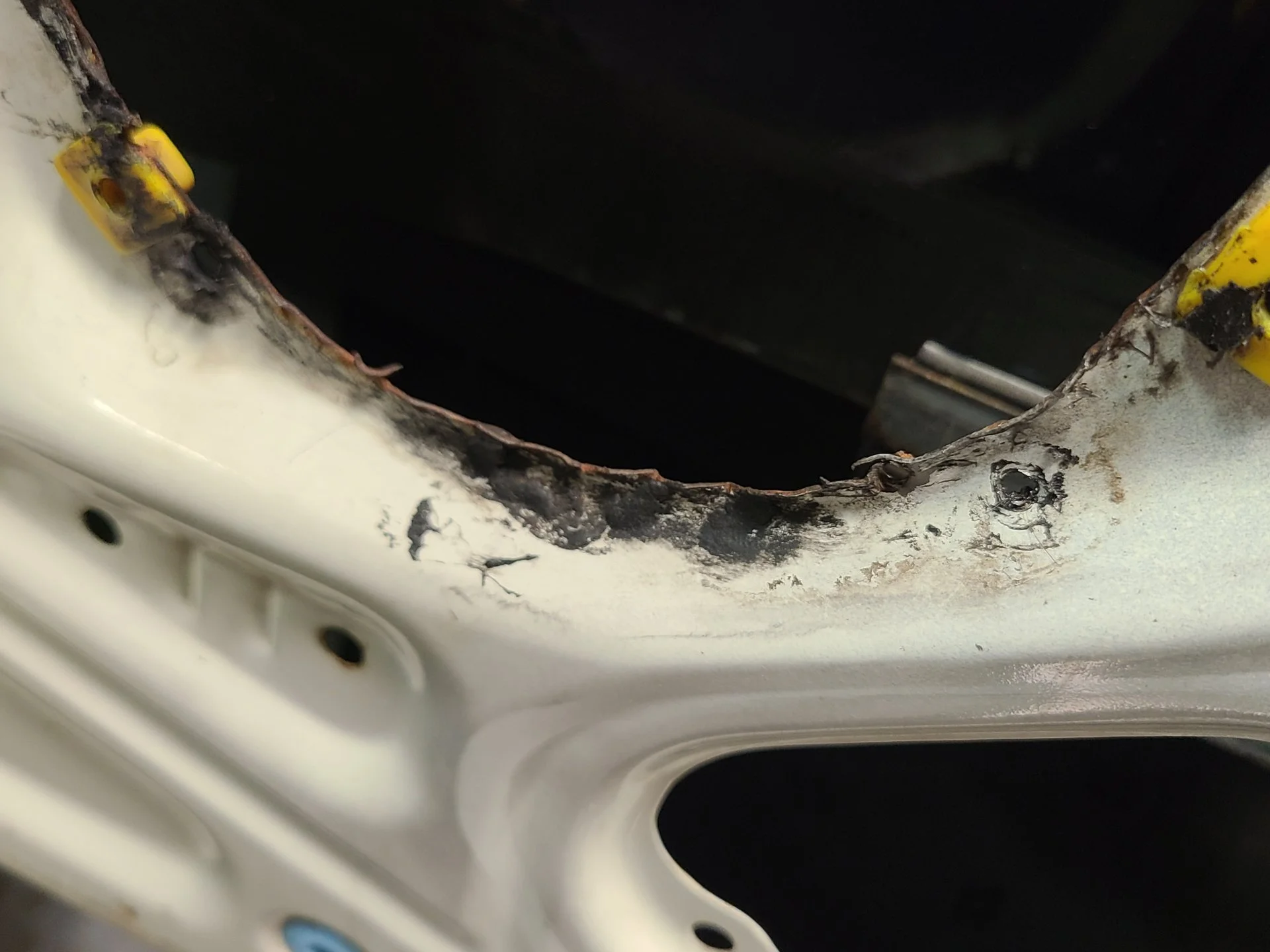

We think whoever installed the speakers before used a piranha to cut the metal on the doors :)
Look at this mess.
So we cleaned the hacked up speakers holes........had to get them opened for the 6.5" speakers. Also had to use a hammer and dolly to flatten out some of the sheetmetal so the speaker could mount nice and flat.
Installed. NOT proud about how we had to install these.....goes against everything we do :)

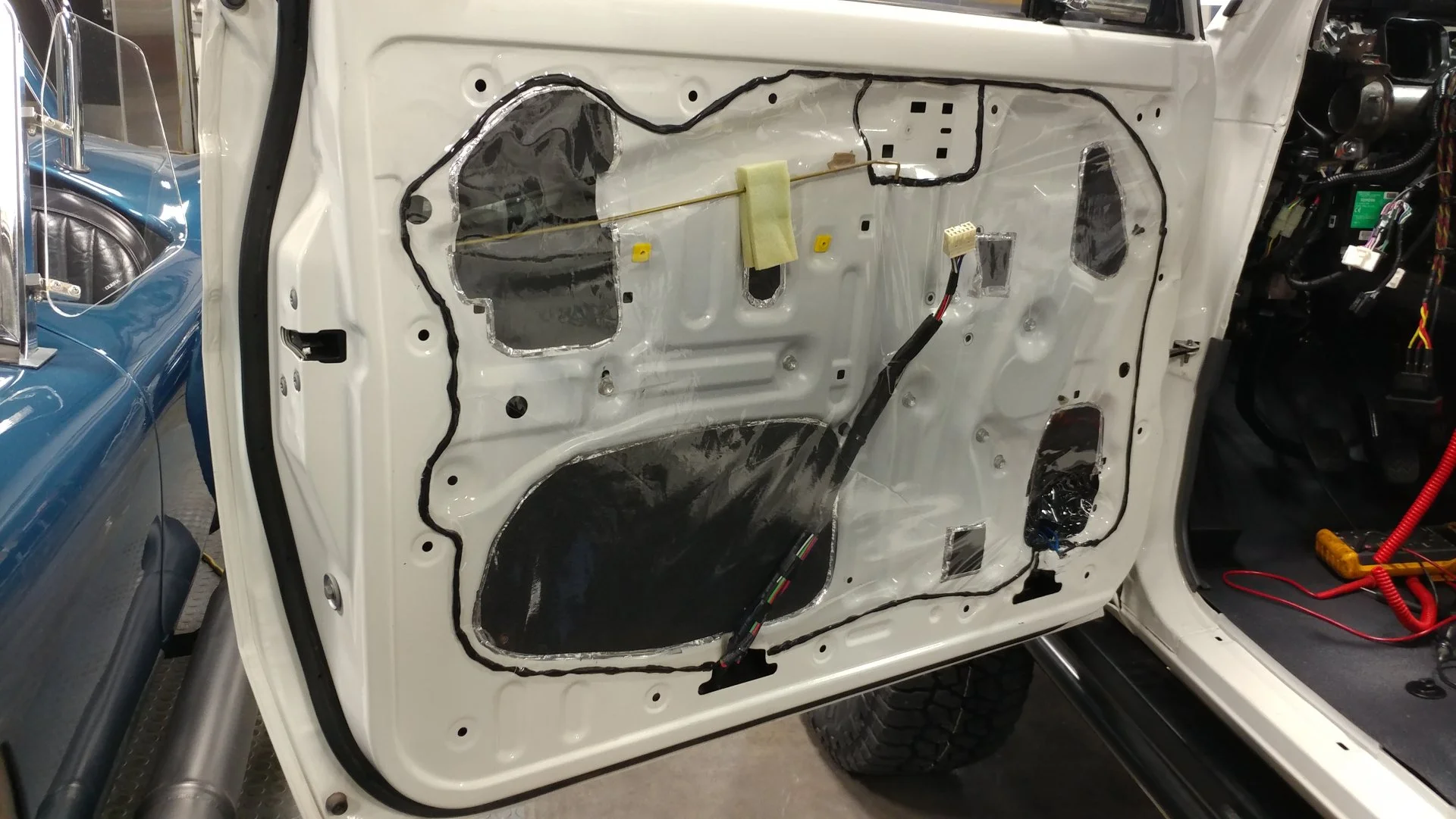

We have been sealing up our doors with both panels for the big areas and straight sound deadener for the small ones.
I remember a stereo guy who worked for me would just slap on sound deadener on the whole door closing all the holes. Great idea that ended up being a really bad idea when you had to work on the door. Unless of course you like dealing with butyl all over everything.
Our method works WAY better.
We usually always make new vapor barriers for the doors. One of the better tricks I read about somewhere was to use clear shower curtain liners for vapor barriers....the beauty of using the clear is that you can trace the pattern you want with a Sharpie on the material then cut it out. Works perfect every time. We use butyl to stick them on.
This was one of our 79s doors.....didn't get any pics of the 60's doors.

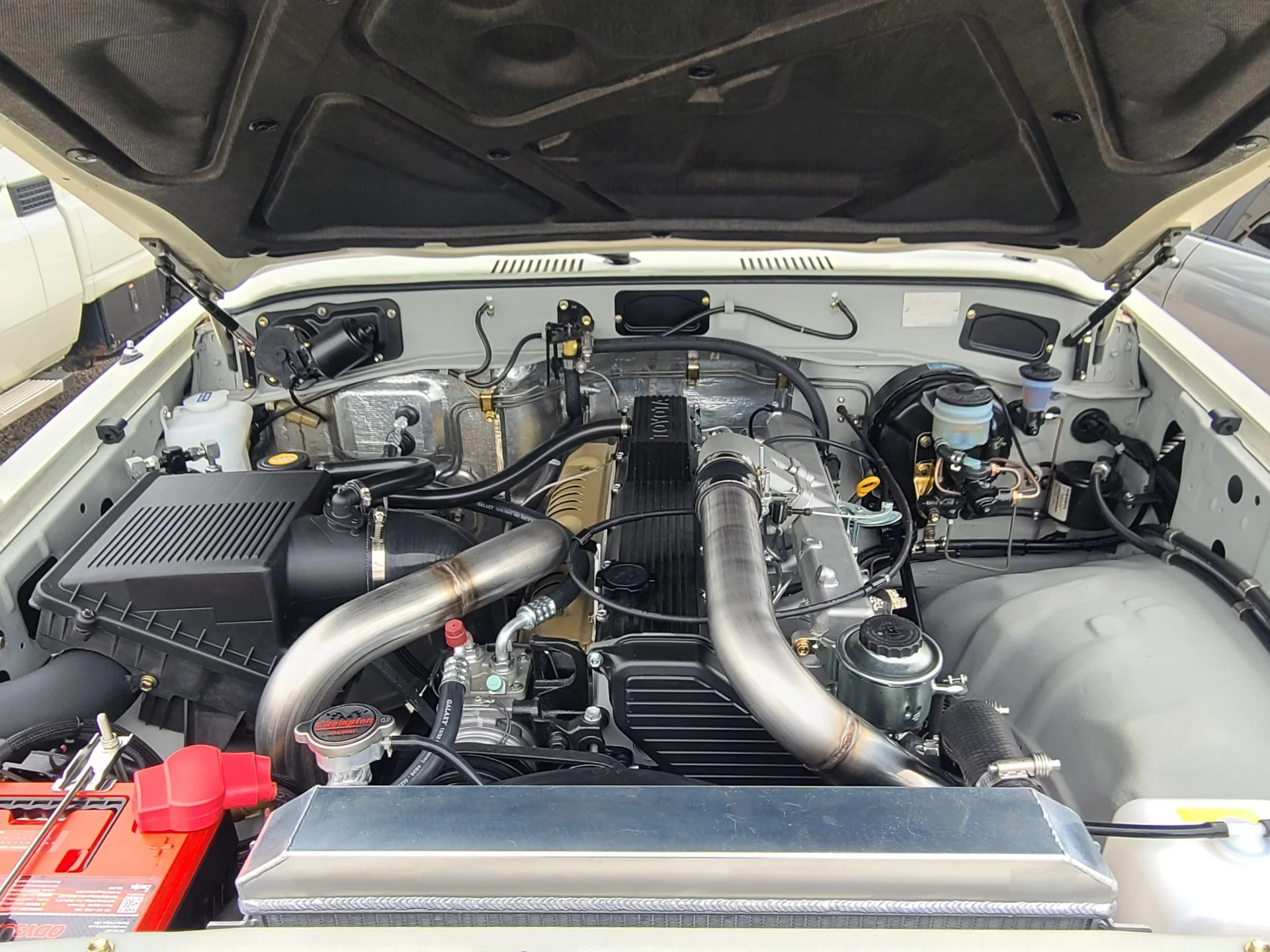

I disliked my cold side intercooler pipe.....looked awkward......so I built a new one. Way better. Now I need to figure out a color for them. Maybe we'll play with some Cerakote on them :)

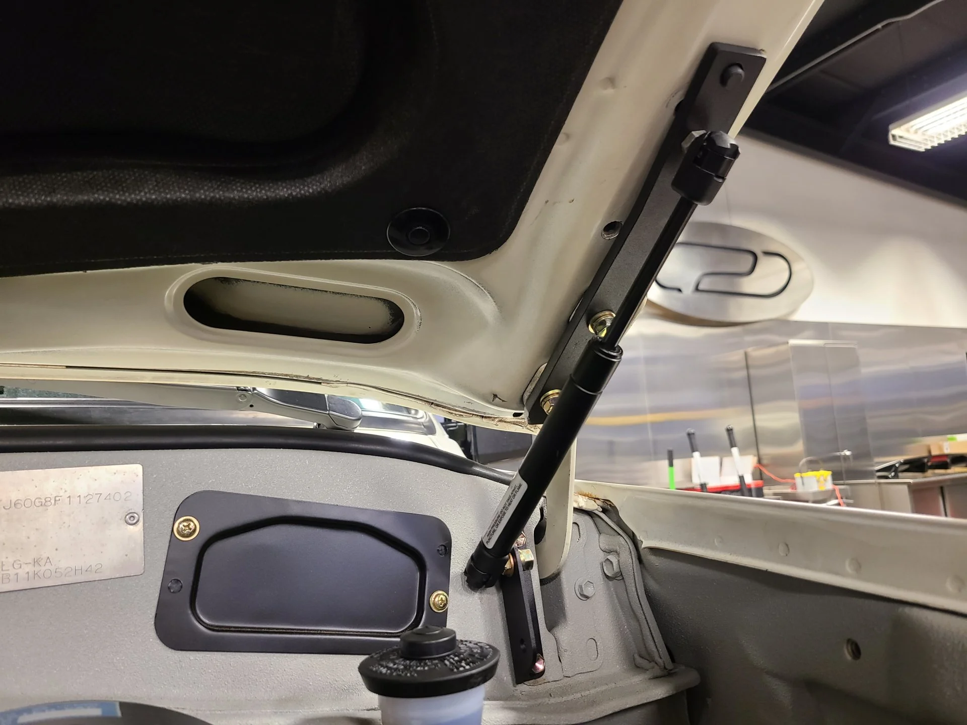

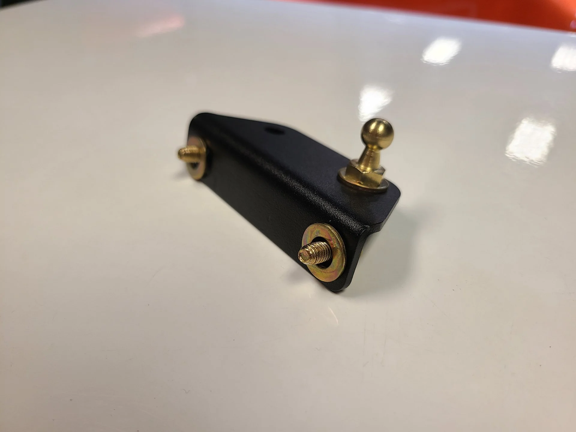

Finished up our hood strut kit....had the cowl supports cut and bent. Getting ready to put kits together next week.....we've been waiting on hardware to get re-stocked. We like using yellow cad stuff.
Turned out great :)

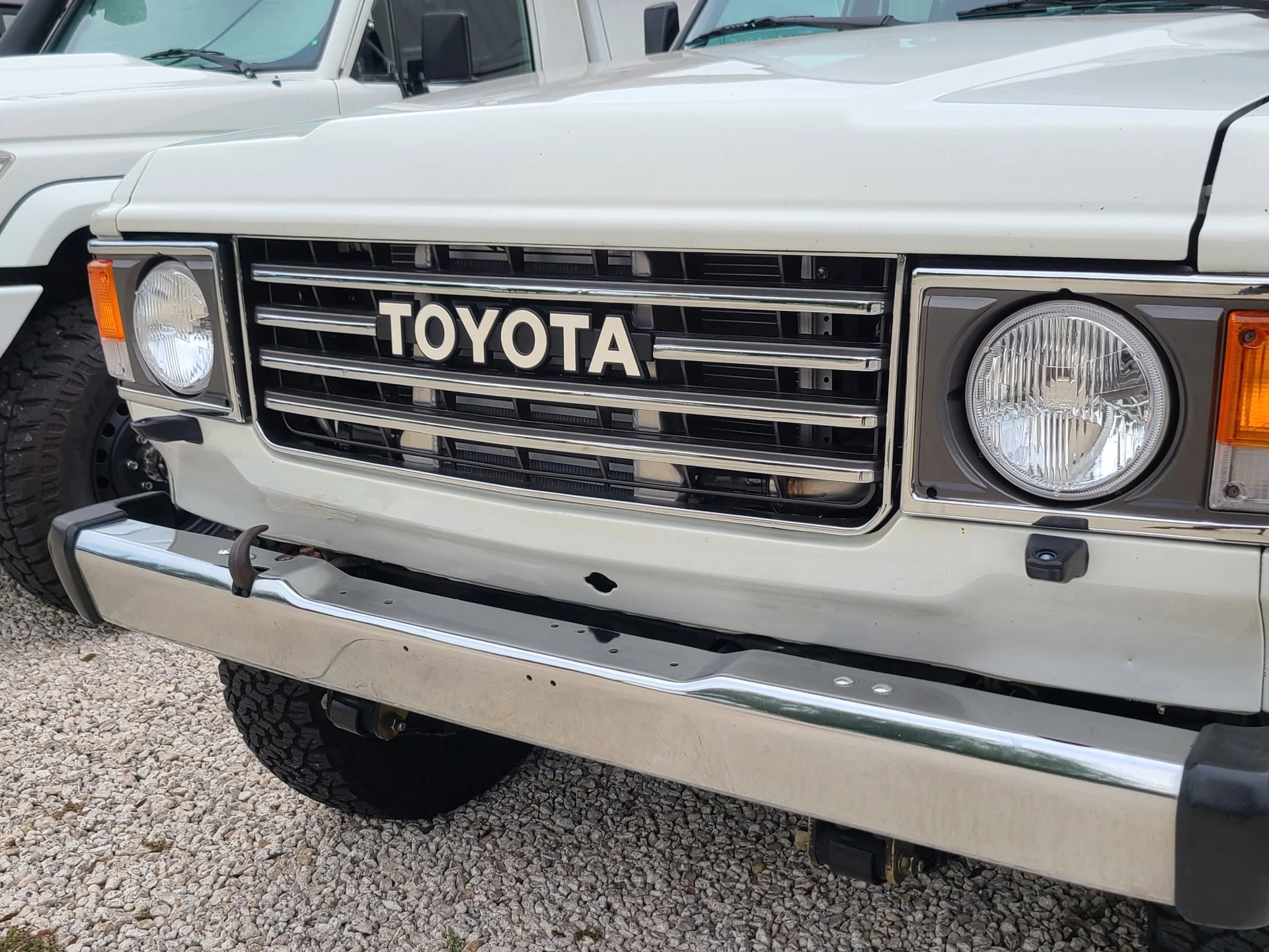

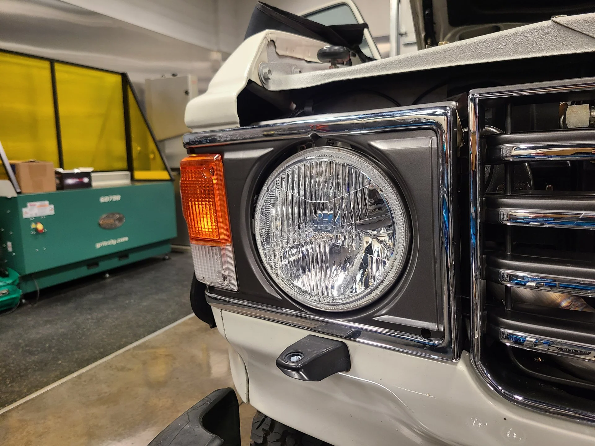

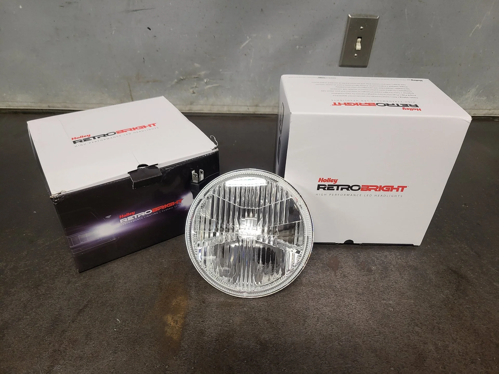

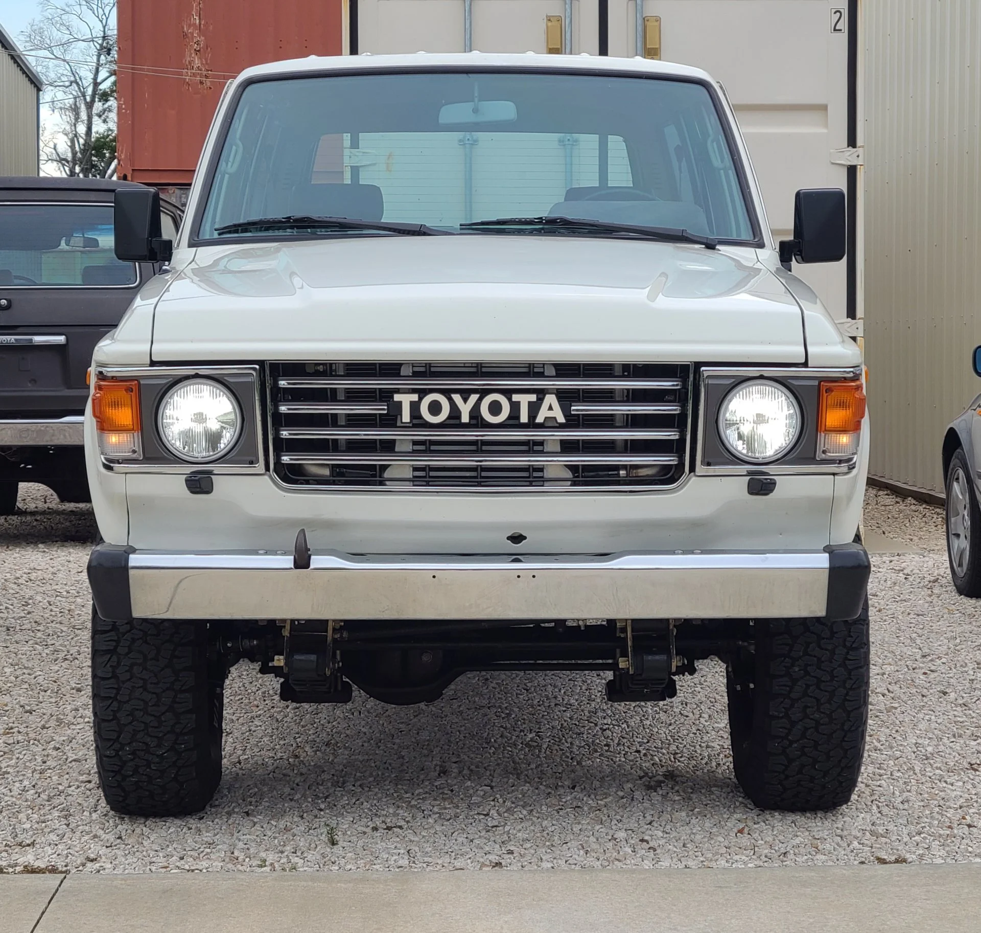

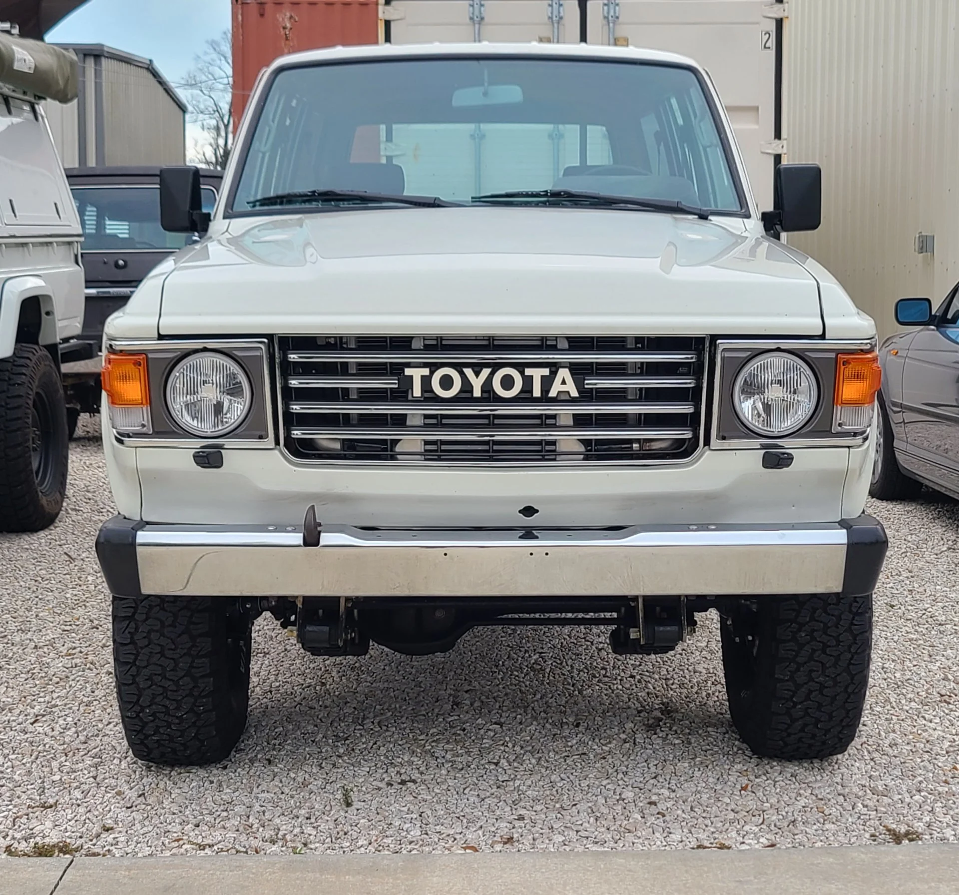

After years of searching, I think I finally found the perfect headlight......ones that don't look goofy but pump out serious light.

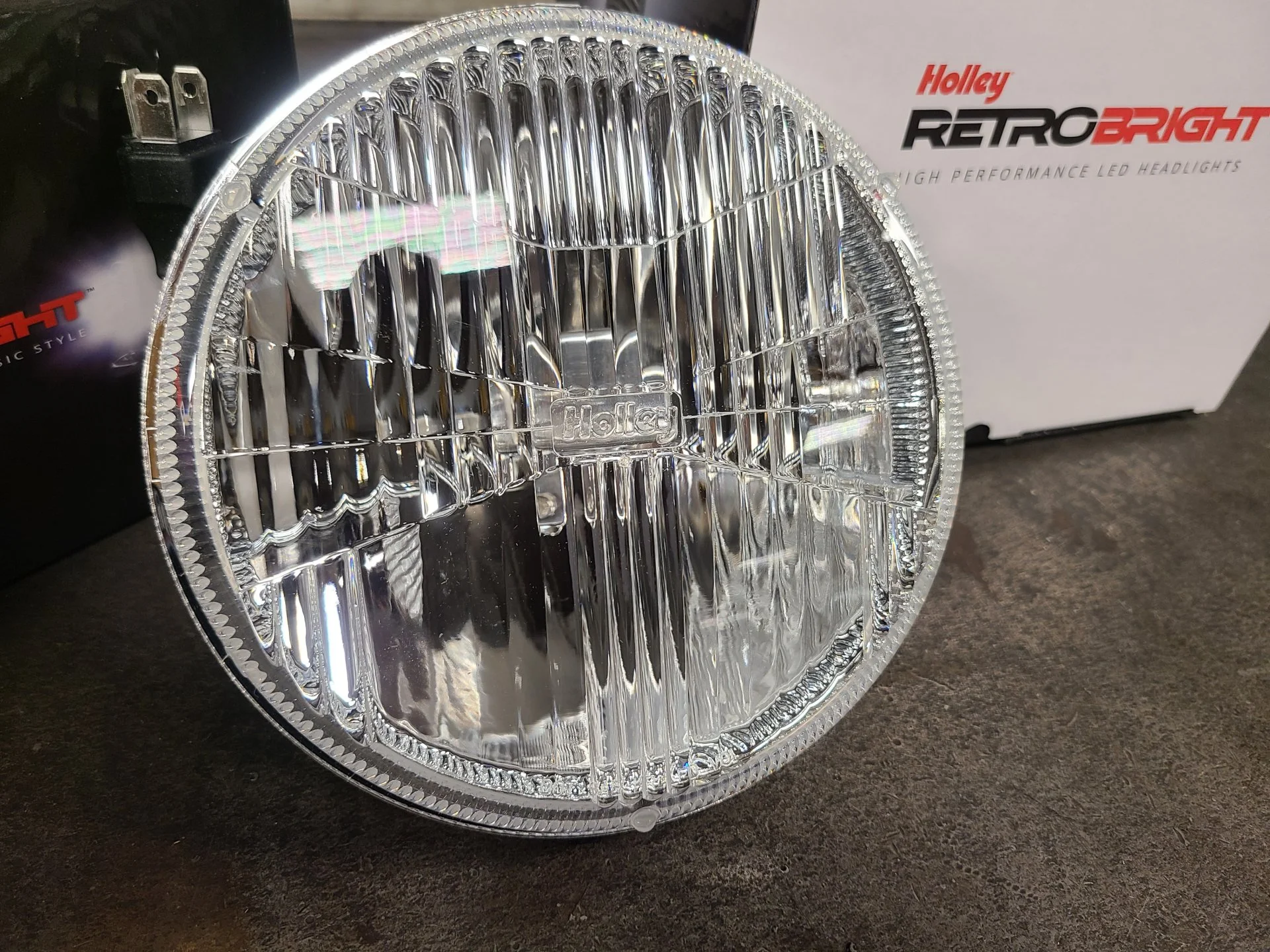

These are from Holley.....I believe they are made by Morimoto which has been in the lighting game a long time. Holley RetroBright lights....available in round and square. They come in cool white, warm white and amber. I went with 7" round cool white.
We've used all kinds of lights over the years.....these seem to have the right optics and look 100% like a halogen headlight. So a little different than popping LED bulbs in a Hella or Euro style light and certainly different than the more modern style LEDs. Pretty sure I'm in love with them :)

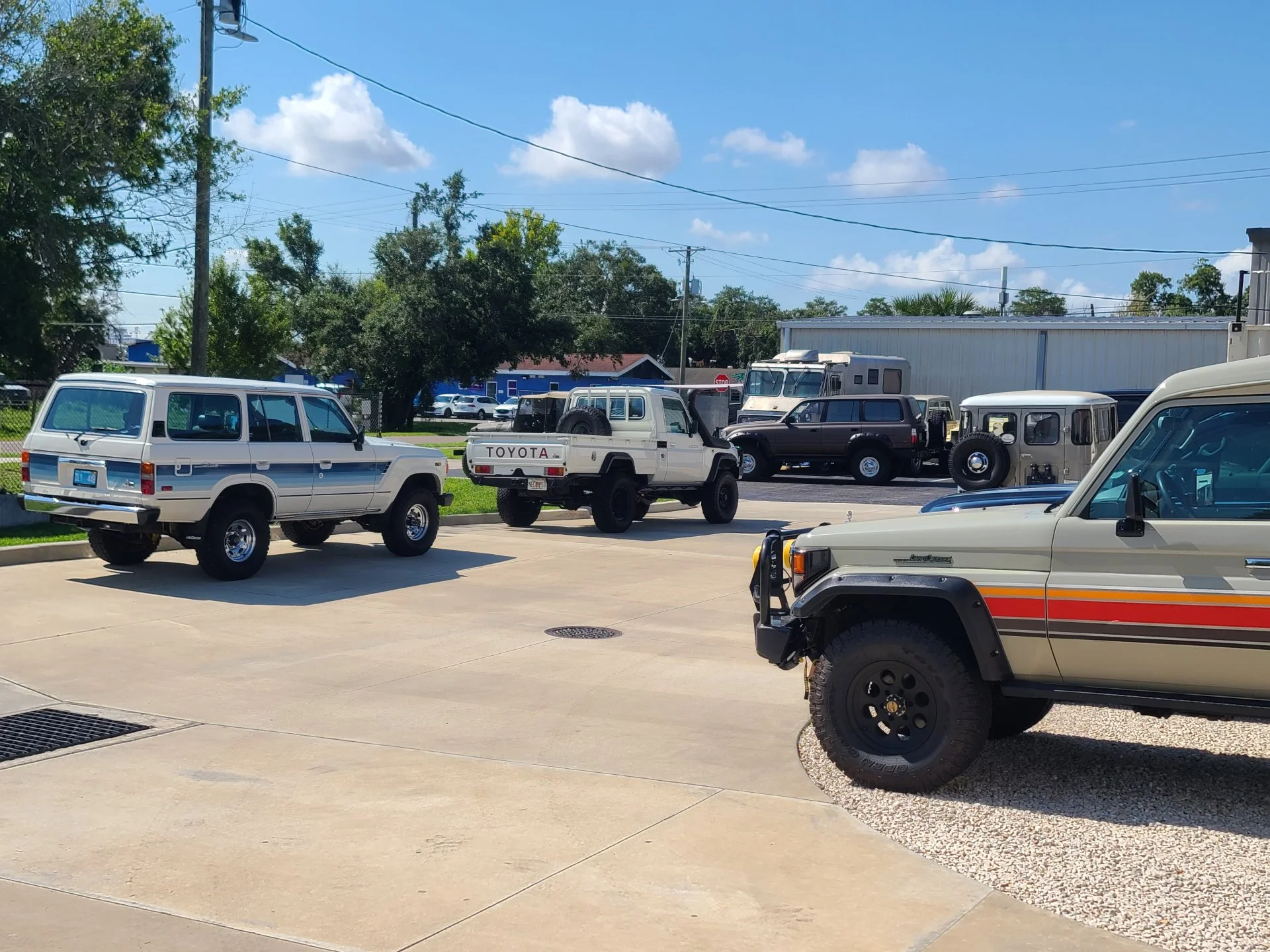

Vehicles with stripes park on this side of the shop :)
I had no idea these headlight existed. I'm using the OEM Toyota upgrade kit and it's good, but I'm betting the holley units are better. One of my biggest peeves with almost all the the LED's available is that they just look too modern and high tech to look right in the 60. The holley ones look perfect though.
I didn't know they existed either. I'm guessing they are pretty new. I've had some square ones on order for a 62 build and we still haven't seen those.
Not real sure how I came across these lights but I'm glad I did(and we're a Holley dealer so they were easy to get). I kind of wish I would have bought the warm white ones.....I think they would have looked a little better on the truck. In any event, I'm thrilled I don't have to have LED looking lights on the truck....they look so out of place on these trucks in my opinion.
Just looked at these online as an upgrade for my 62. This seems like a great option but $180 per bulb felt a little steep. Am I seeing that right?
Unfortunately you're seeing that correctly :(

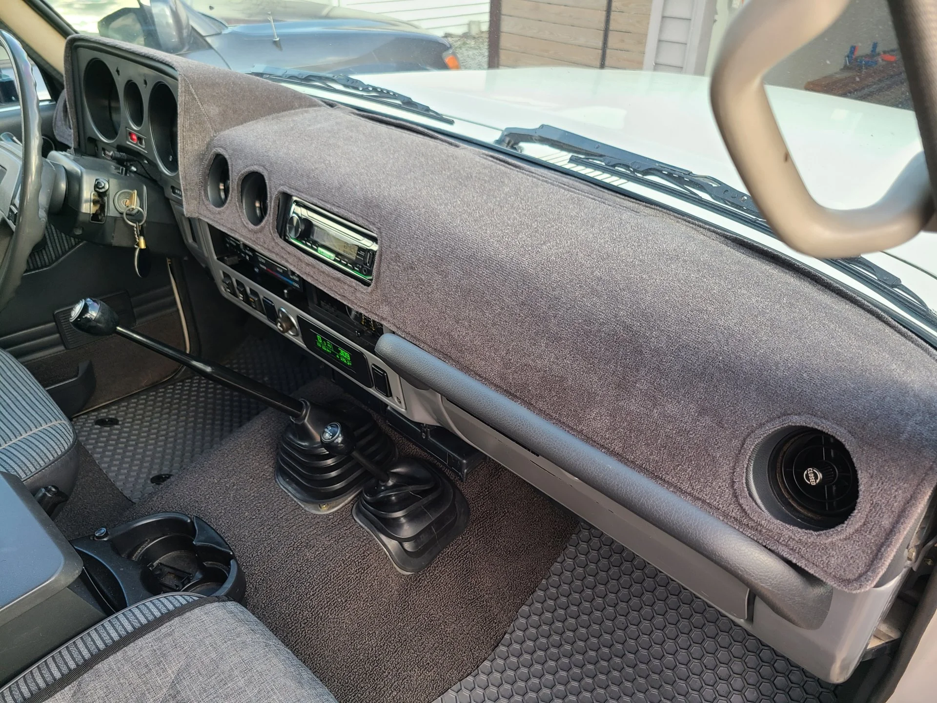

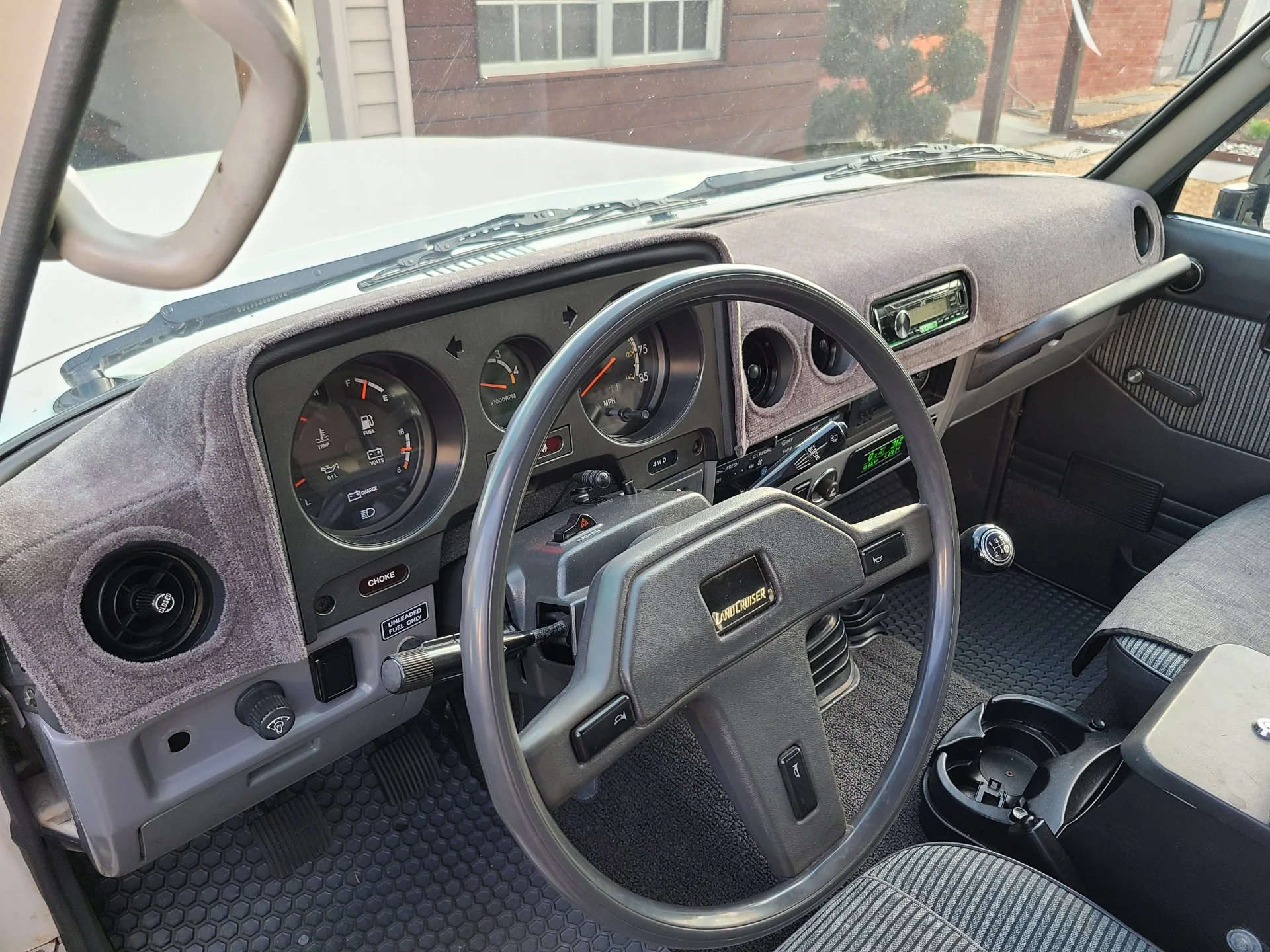

Added a Specter Off Road dash cover to try and protect this dash.....even with the tinted windshield I figured keeping the heat and sun off it would be a good idea. Looks pretty cool too :)

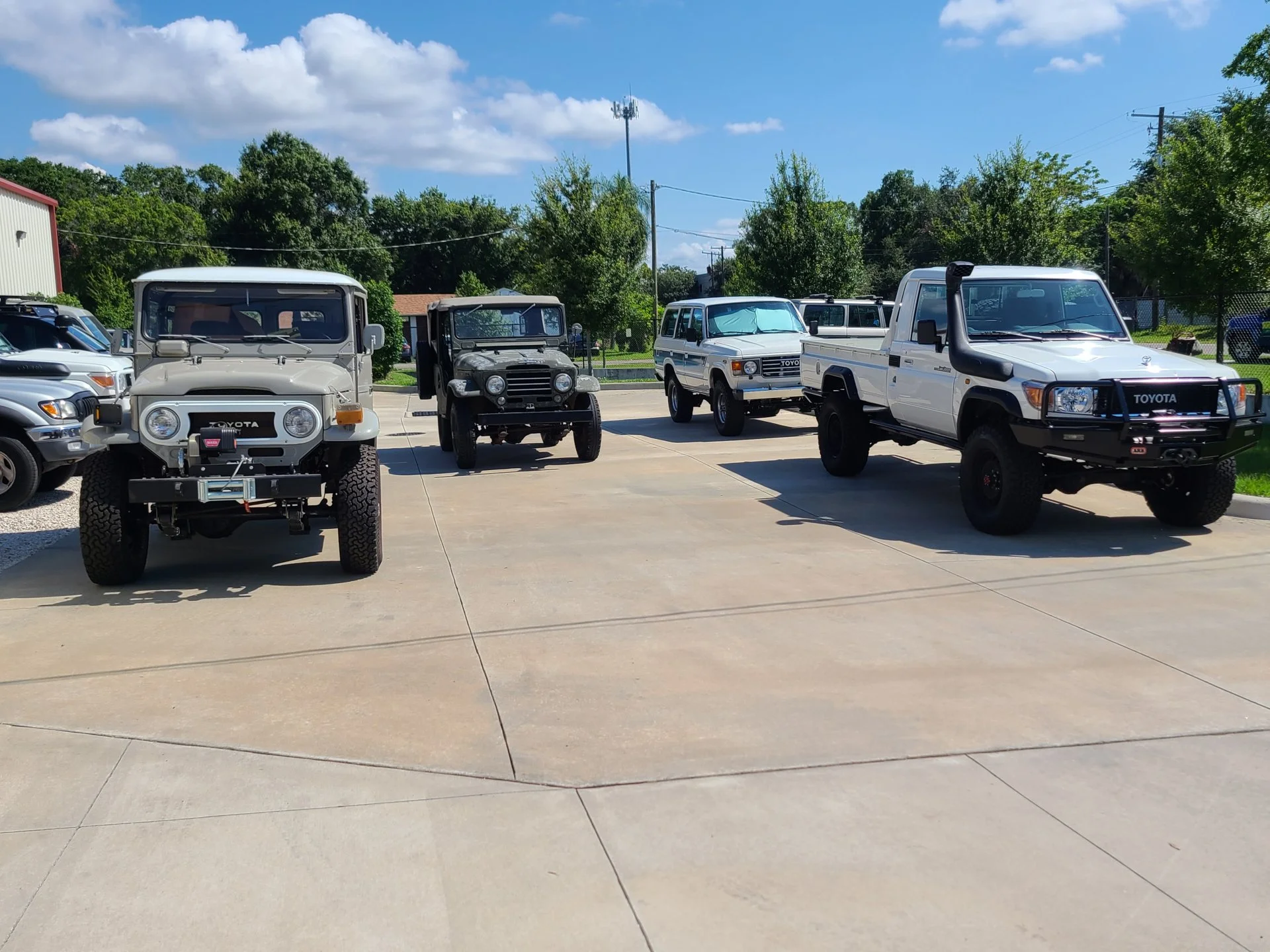

Had some of the 60's buddies out the other day....even the old dog 1959 FJ25 made an appearance. Remarkable old truck.

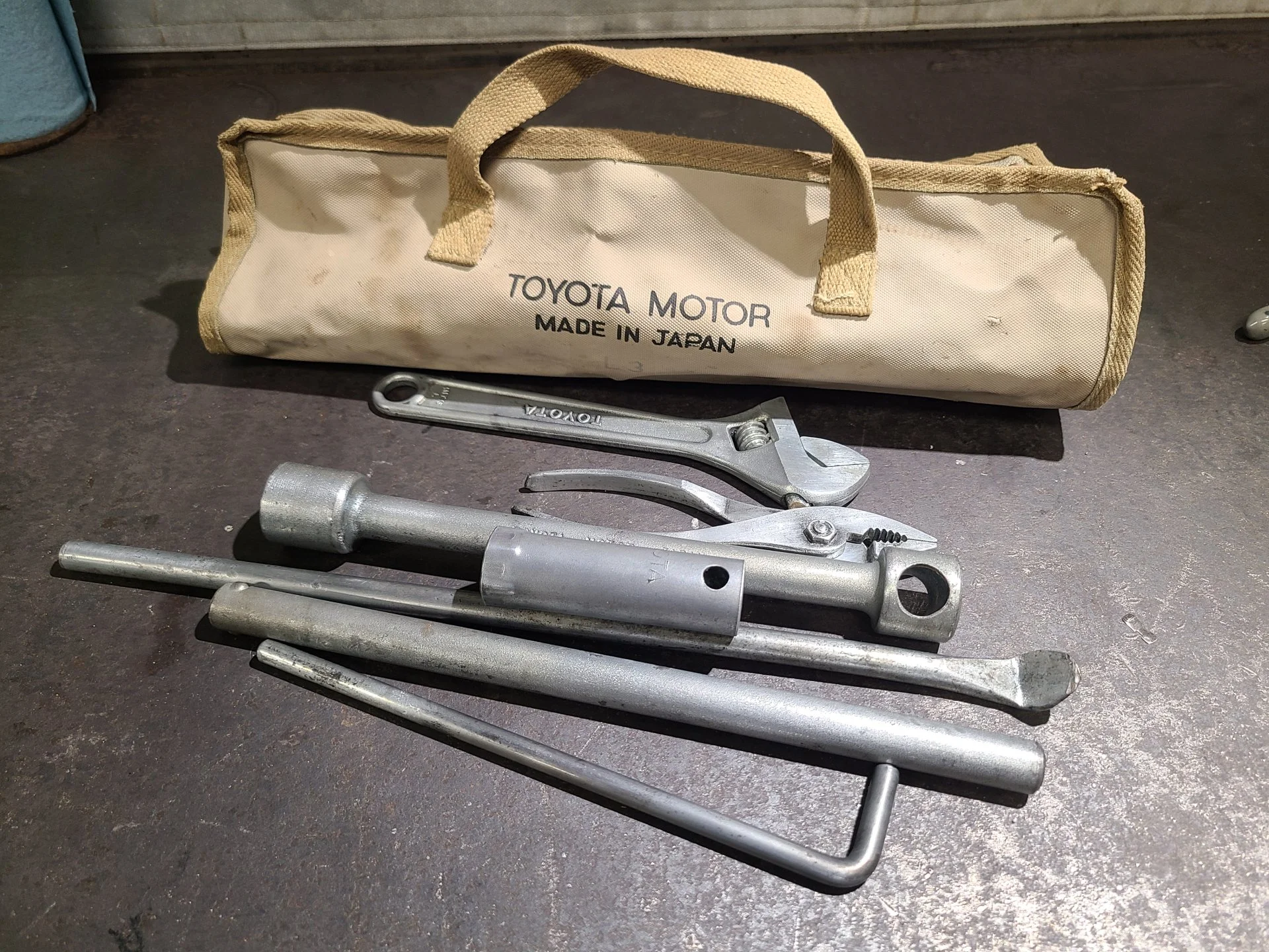

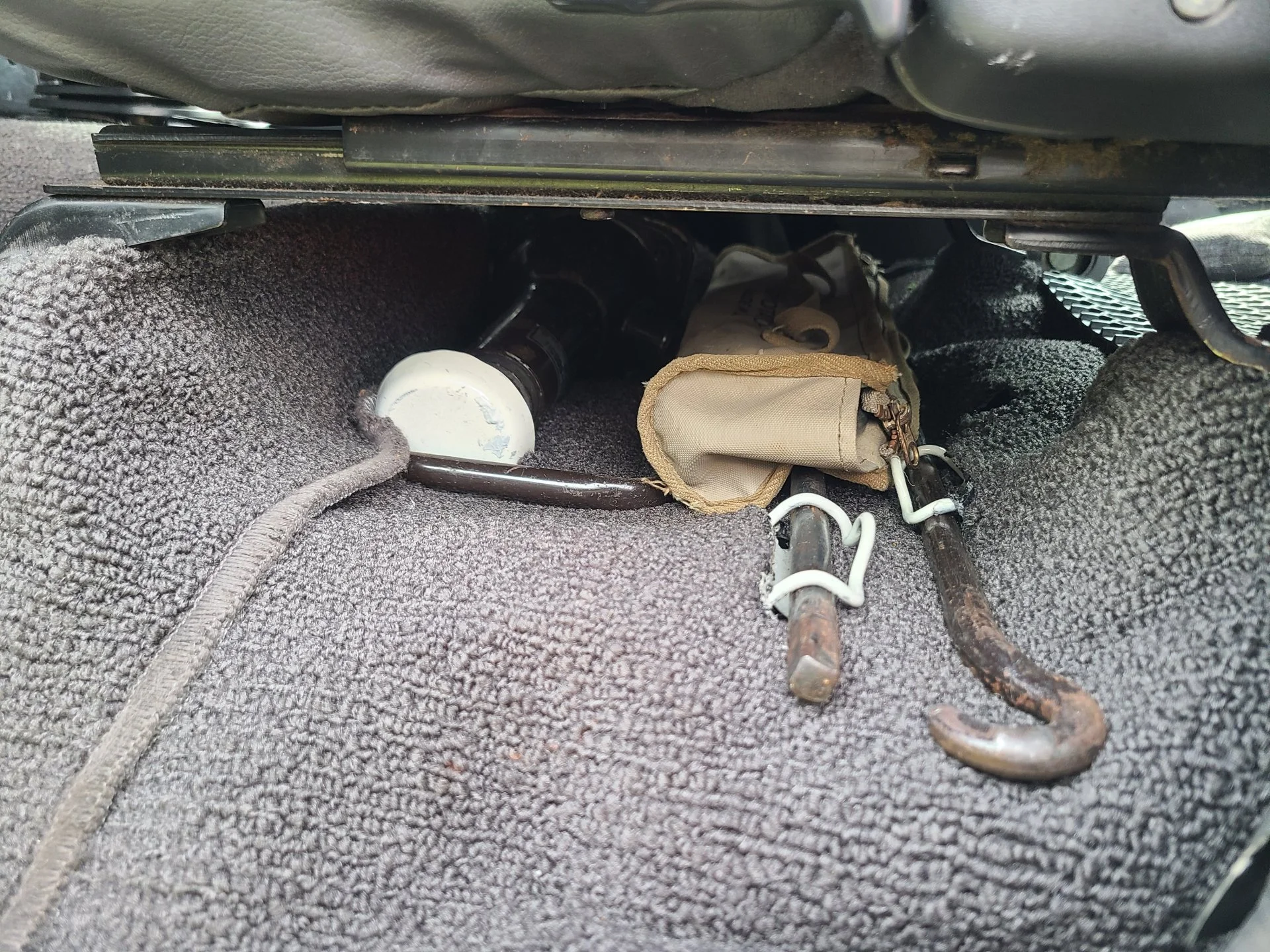

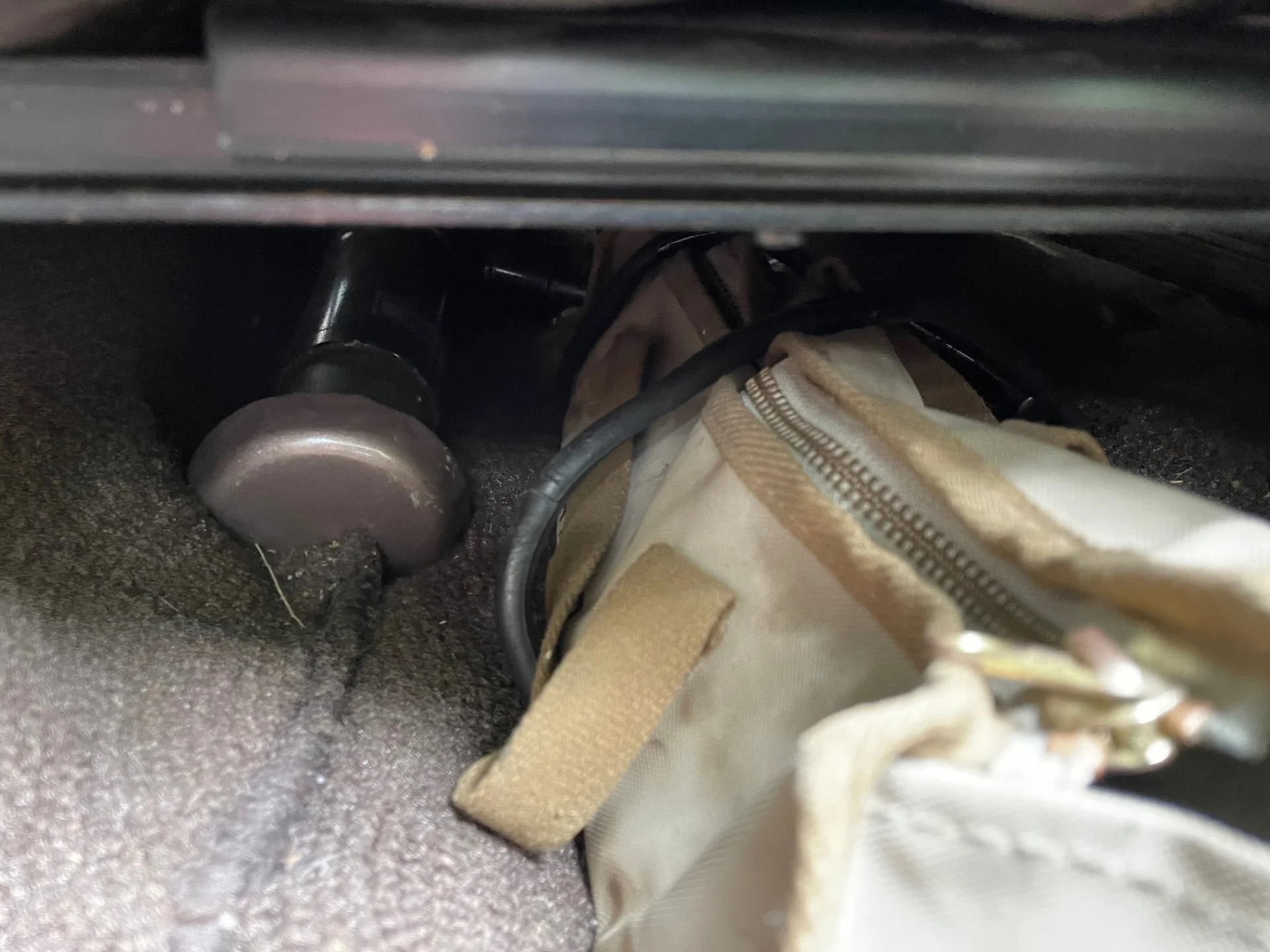

And maybe one of my favorite things......I bought an old dirty tool bag with all the tools in it, cleaned it in my ultrasonic cleaner(bag and tools) and stuffed it under the seat. I can rest easy now :)

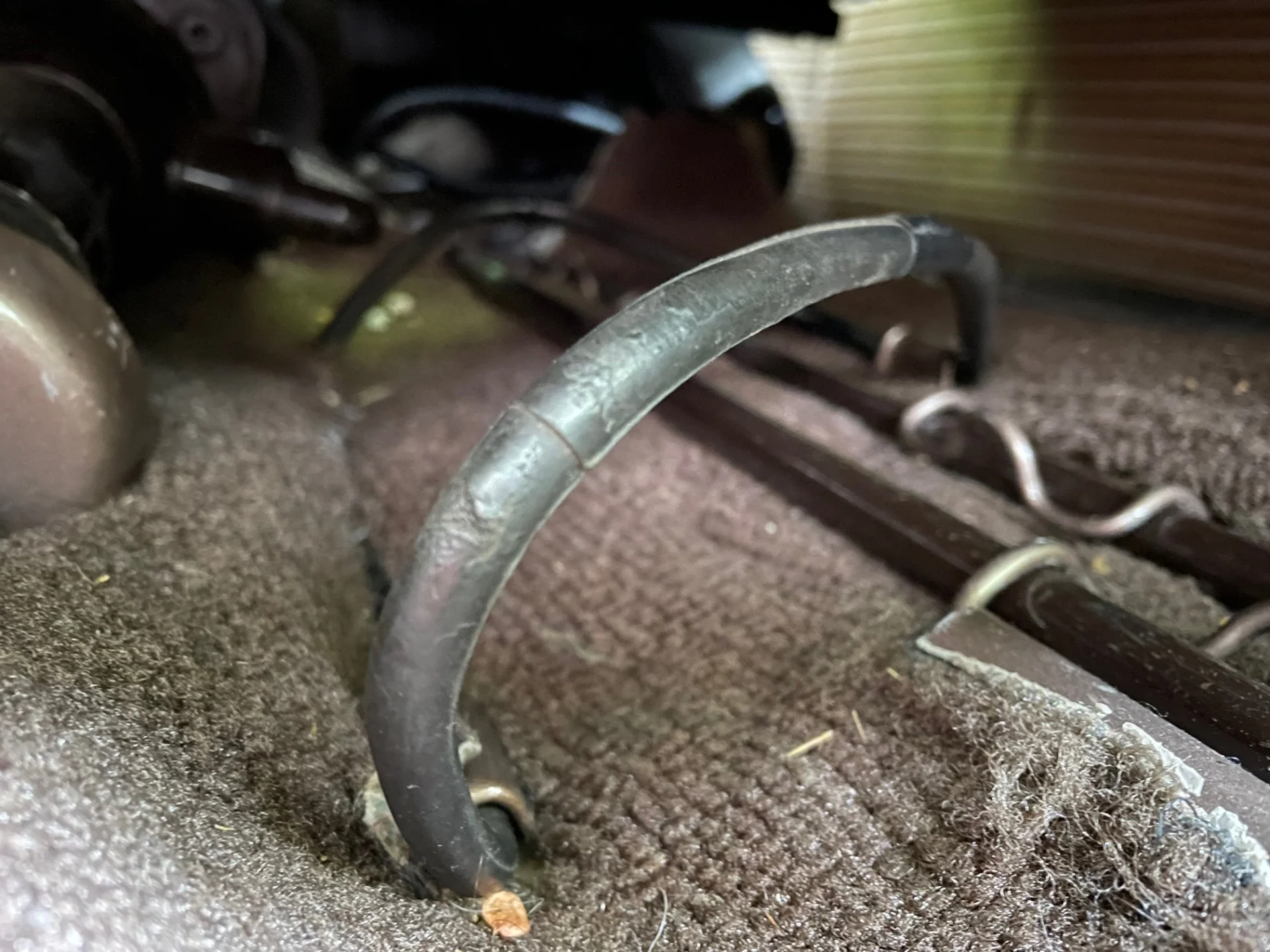

Anyone know if there is a rubber band hold down thing for the 60s? Thought I read that a late FJ40 one fit.

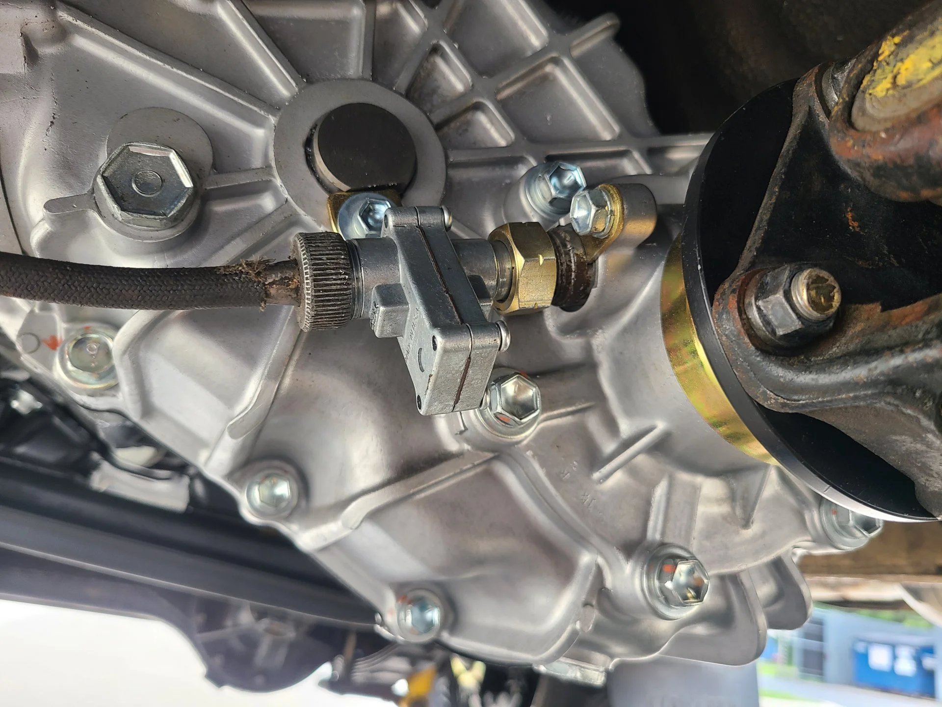

Popped this little speedo correction piece in today....fixed the 13% error in my speedo. Came from Commercial Speedometer. Hit 75 mph on the way home tonight without really trying too hard. Going to try for 90 tomorrow :)
