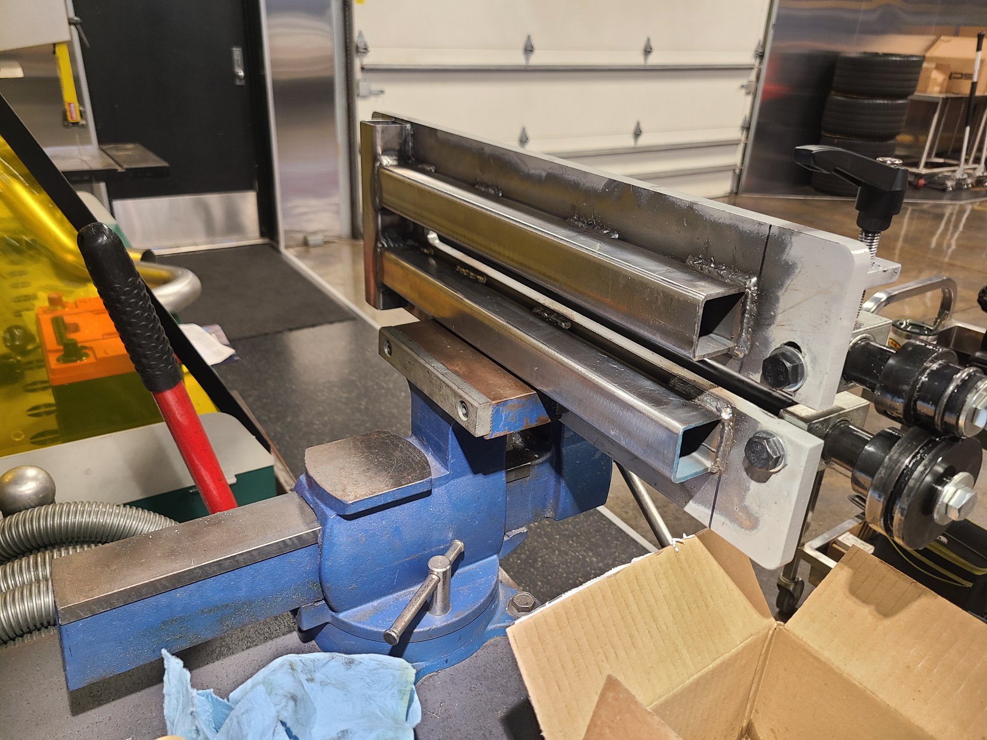

Got into intercooler piping today. I had bought this Woodward bead roller a while back along with the pieces for bead rolling tubing. Pretty sure it's not designed for 16ga stainless tubing :) We had to stiffen it up....flexed like crazy when I tried it out. Seemed to do a pretty good job once stiffened. Quite the workout with the 16ga.

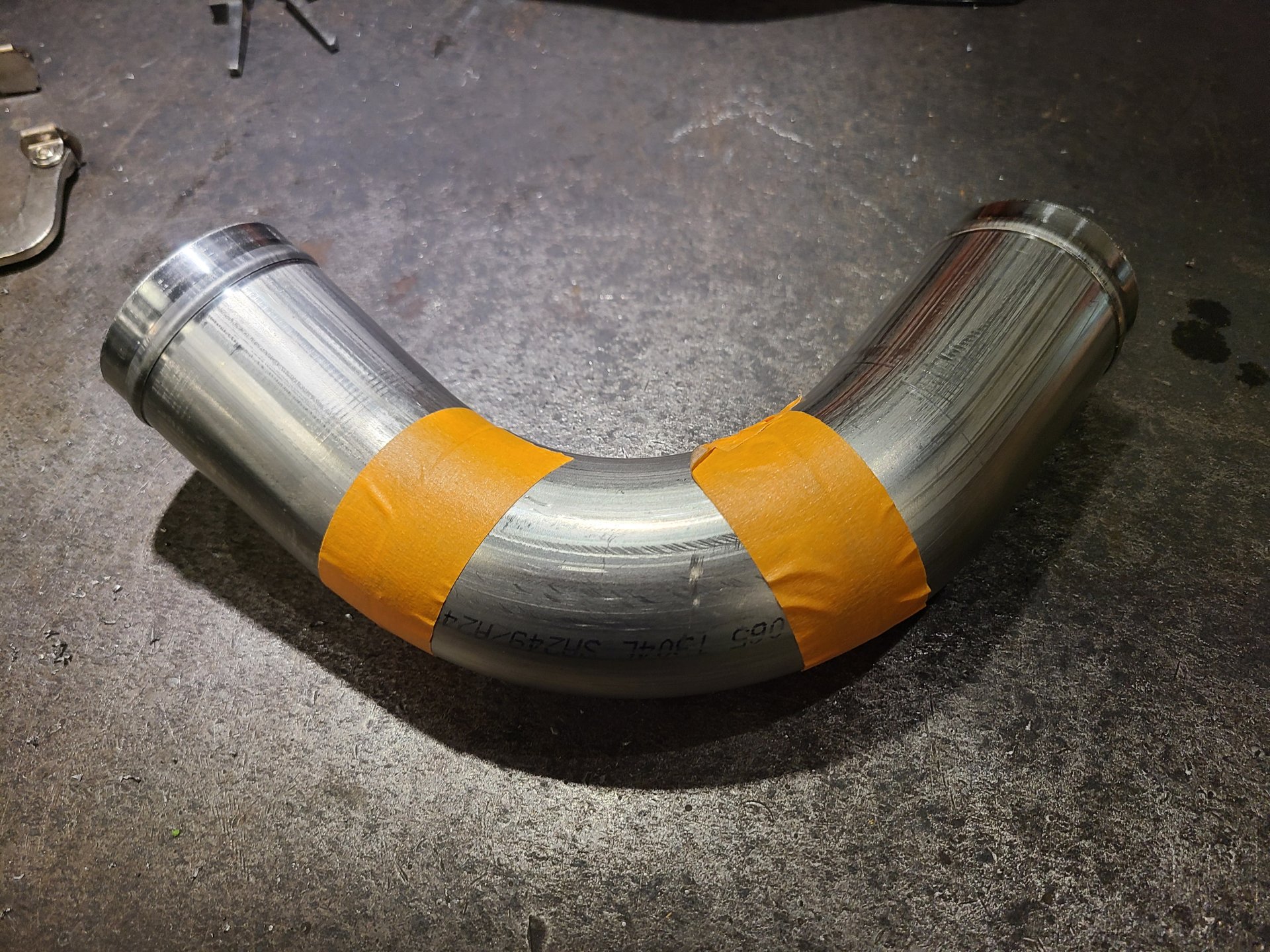

First piece.....this one went back in the rollers to get a little more love. Certainly not as much of a bead on the stainless as I would like but I think it will be fine with good clamps on it.

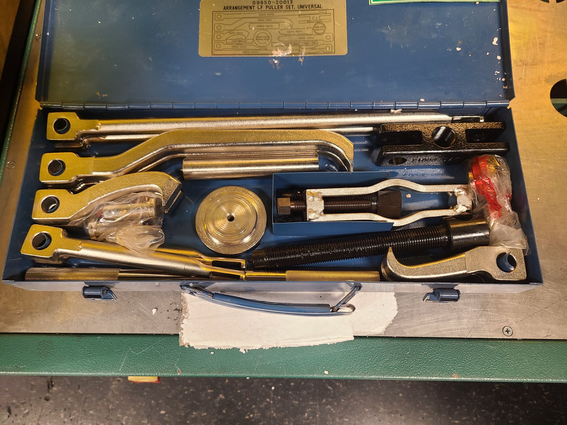

Bought this for the guys to make transmission/transfer disassembly and reassembly easier......brand new old stock from what I can tell. Amazing.

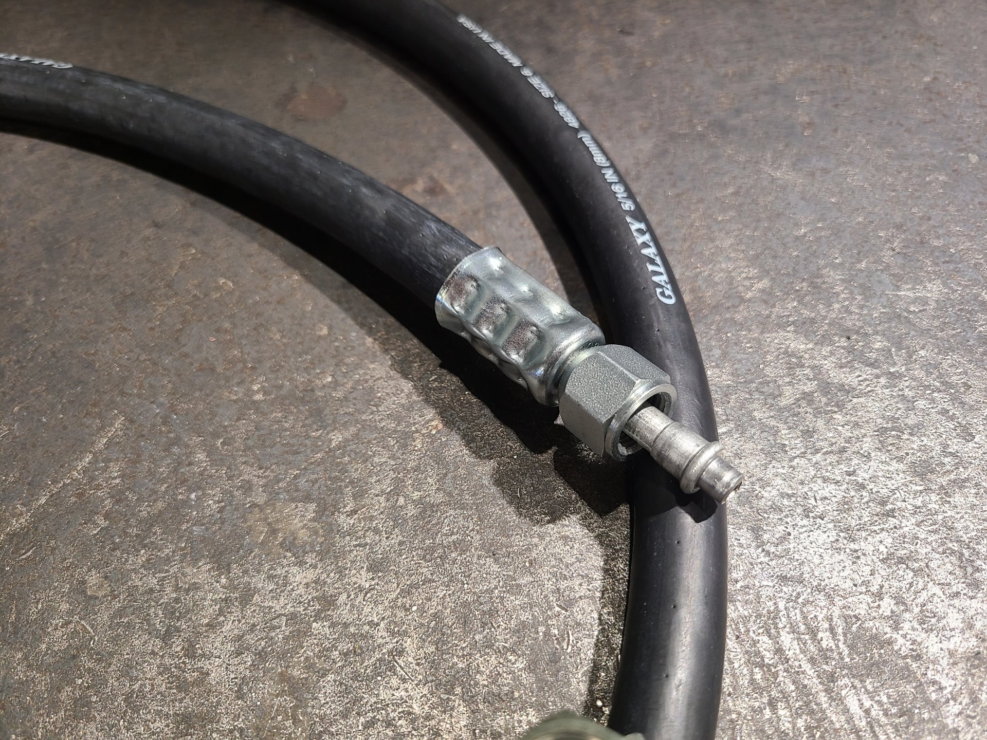

We were able to build our AC lines today. Another luxury.....having this crimp tool so we can do them in-house. Classic Air is right down the street from us....we used to be able to run over and have them build up lines when needed. Got to be a total pain in the ass with getting them done in a timely manner AND they got super expensive....not sure they're even wanting to do lines now. So we make our own. Coldhose.com is who we get all our fittings and supplies from. GREAT place.
We ran them, indexed them, took them off, crimped, done.
This thing paid for itself in a few uses.

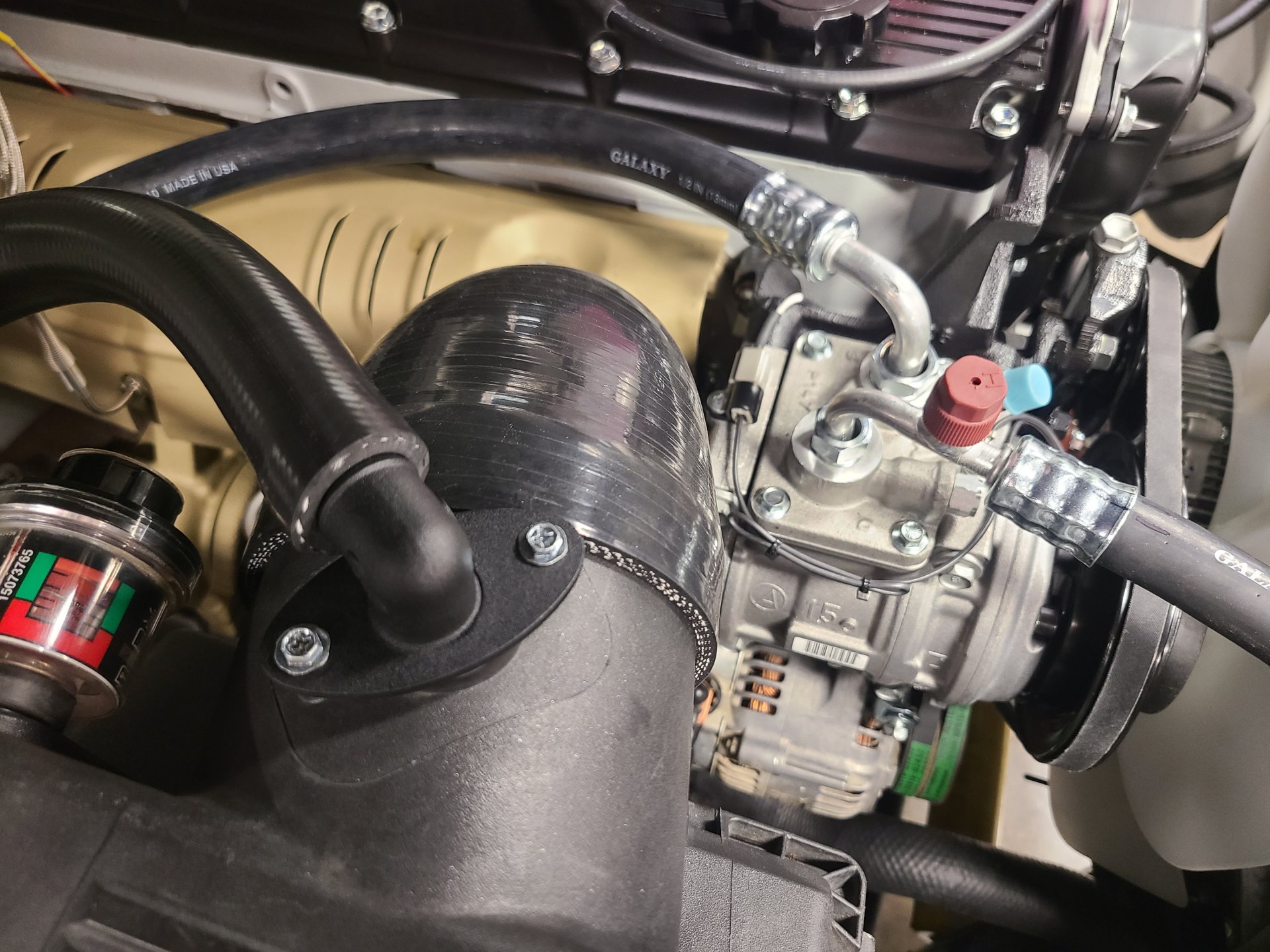

Installed and doing it's job. AC lines all hooked up. Also put on the manifold's heat shield.
The breather line port turned out really cool. Need to add some clamps to the breather hoses.

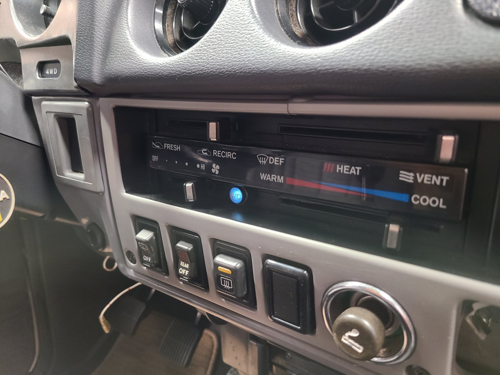

What's this blue button doing illuminated?? Blowing cold air is what. AC is imperative in FL......year round.
Since we don't have a tach signal any longer....well, at least one that the AC amplifier can use, we removed the RPM sensing resistor on the AC amplifier board and bingo.....AC works with the FJ60 amplifier. Down side is the AC compressor is on when the truck is cranking. I'm not sure I feel like that's a big deal on this motor. It wasn't cycling so I gave that red knob about 1/8 of a turn to the right and it started cycling. Going to run it like this to see how things go.
