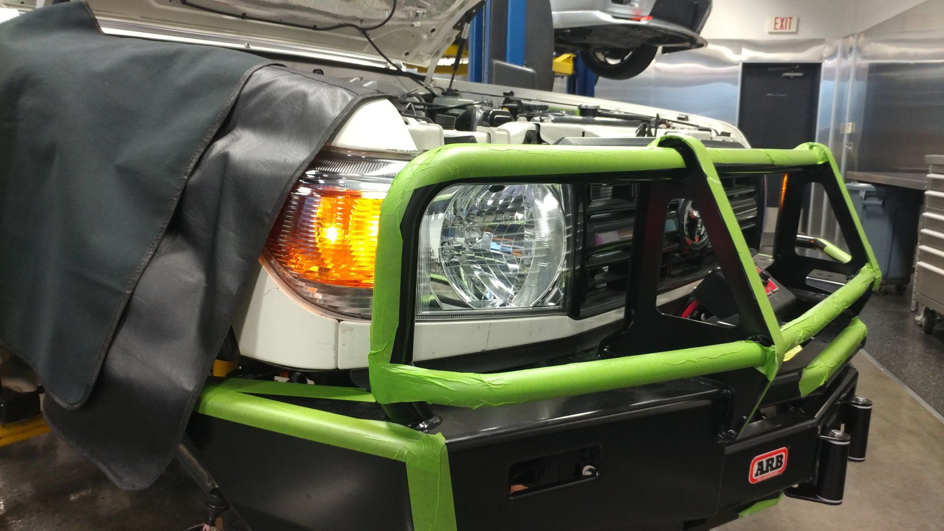

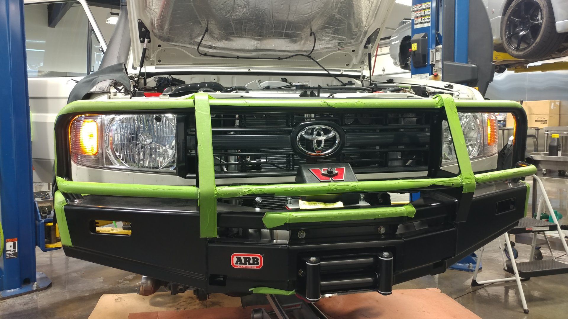

So these trucks only have turn signals up front in the marker portion of the headlight. I wanted turn AND parking...so I ended up buying a 3 wire bulb socket from some kind of Lexus and wiring it up to do both duties. My #1 truck was done this way and it I like it. We'll also have some lights in the front bumper too as the bullbar obscures the corner light a tad. ARB has some retrofittable LED amber turns with white DRLs....that might be the perfect setup...more light for the front of the truck.

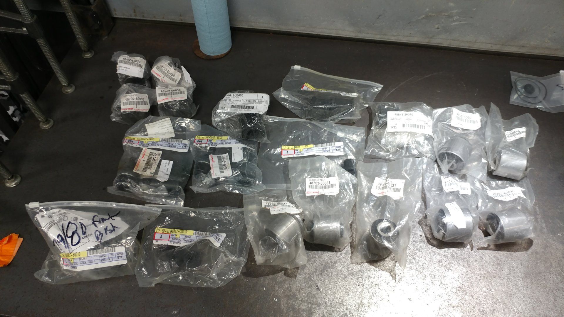

On the rear of the truck...some of this stuff is going in. We'll replace all the bushings in the truck with new rubber eventually...starting with the rear arms.

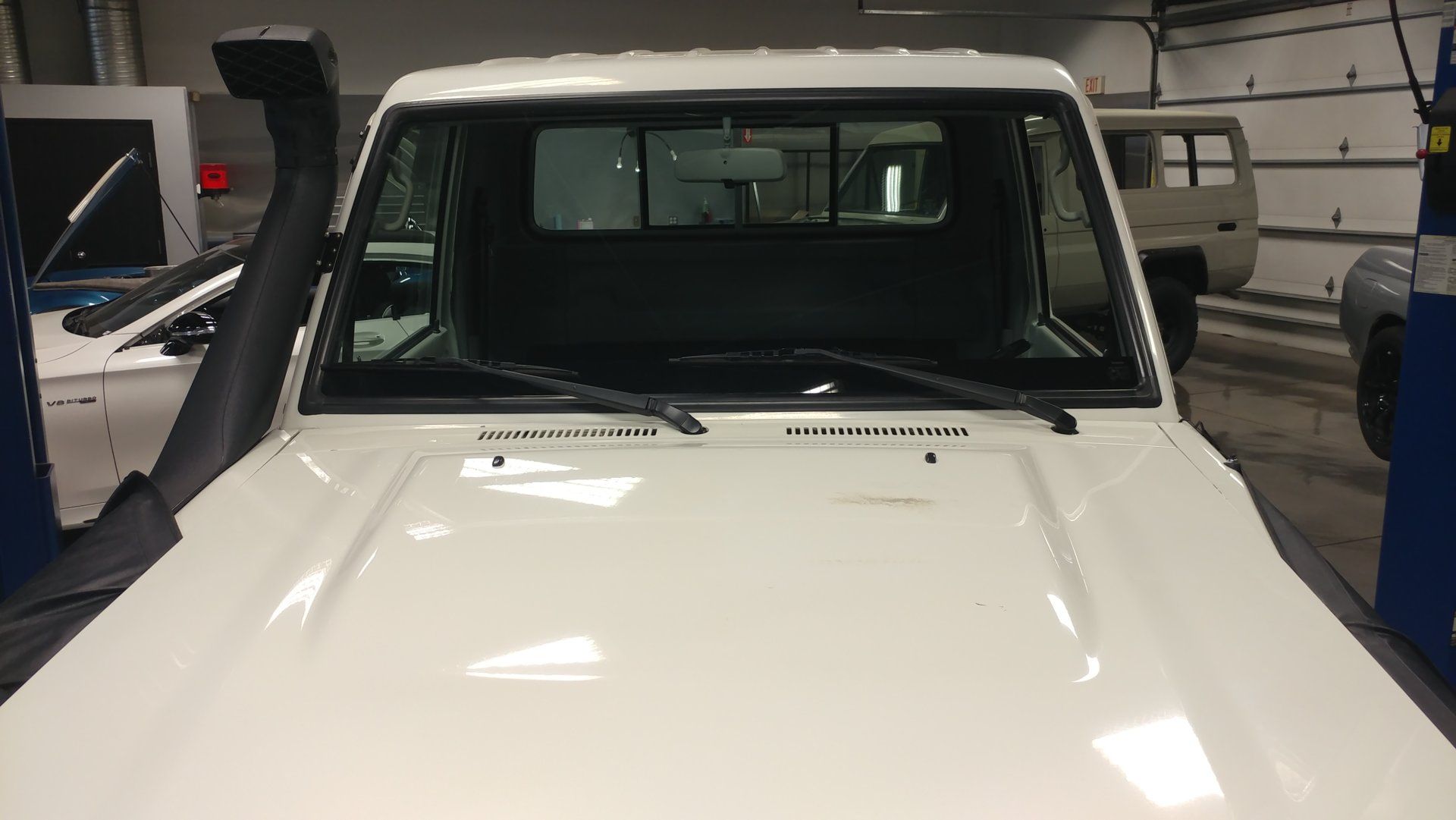

We were able to get the windshield strip done yesterday....this will cover up the Rav4 dash since it's taller than the old steel dash and you can see it from the exterior of the truck. We used vinyl....tried using tint but the vinyl worked better. Vinyl on the INSIDE of the glass. Got the wipers painted and installed too.
Vinyl guy is going to come back when the vinyl is dry(he applied it wet) and trim it up a bit.

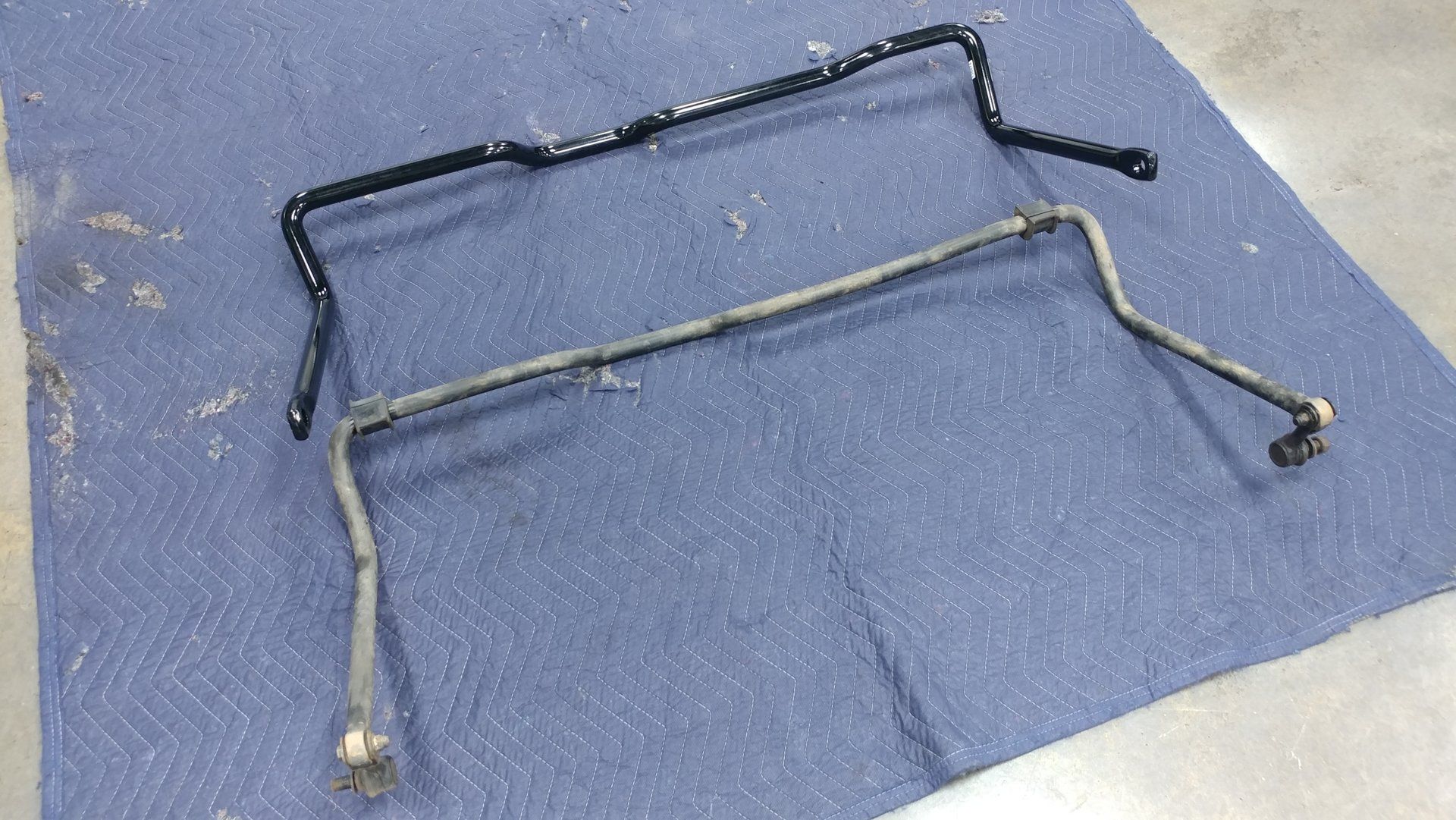

While we were finishing up the rear upper and lower control arm bushings, we installed the Whilteline BTR46X rear sway bar. Pretty stout bar.
