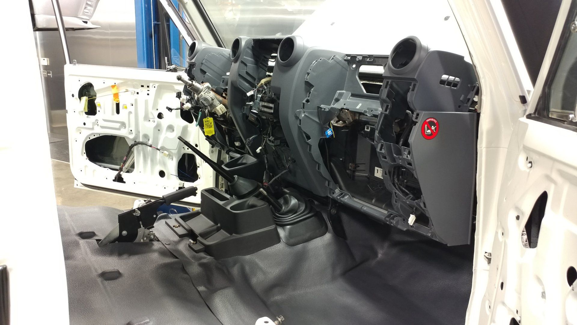

I wanted to get the flooring installed today.....make sure there were no surprises. A little tough in this truck because of the flooring...it looks a little puffy for my liking but it's going to be nice inside the truck and once the floor mats and seats are in, I think it will be OK. The driver's side looks awful because I haven't pulled the tunnel area tight yet. The OEM cupholder bracket holds the mat down.

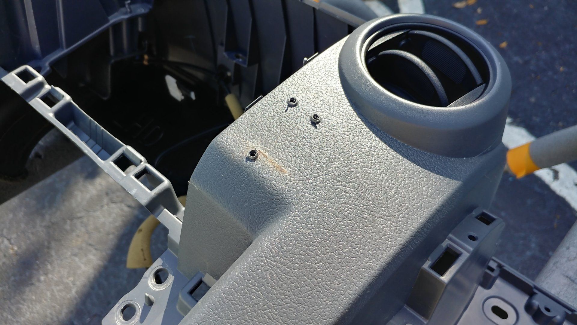

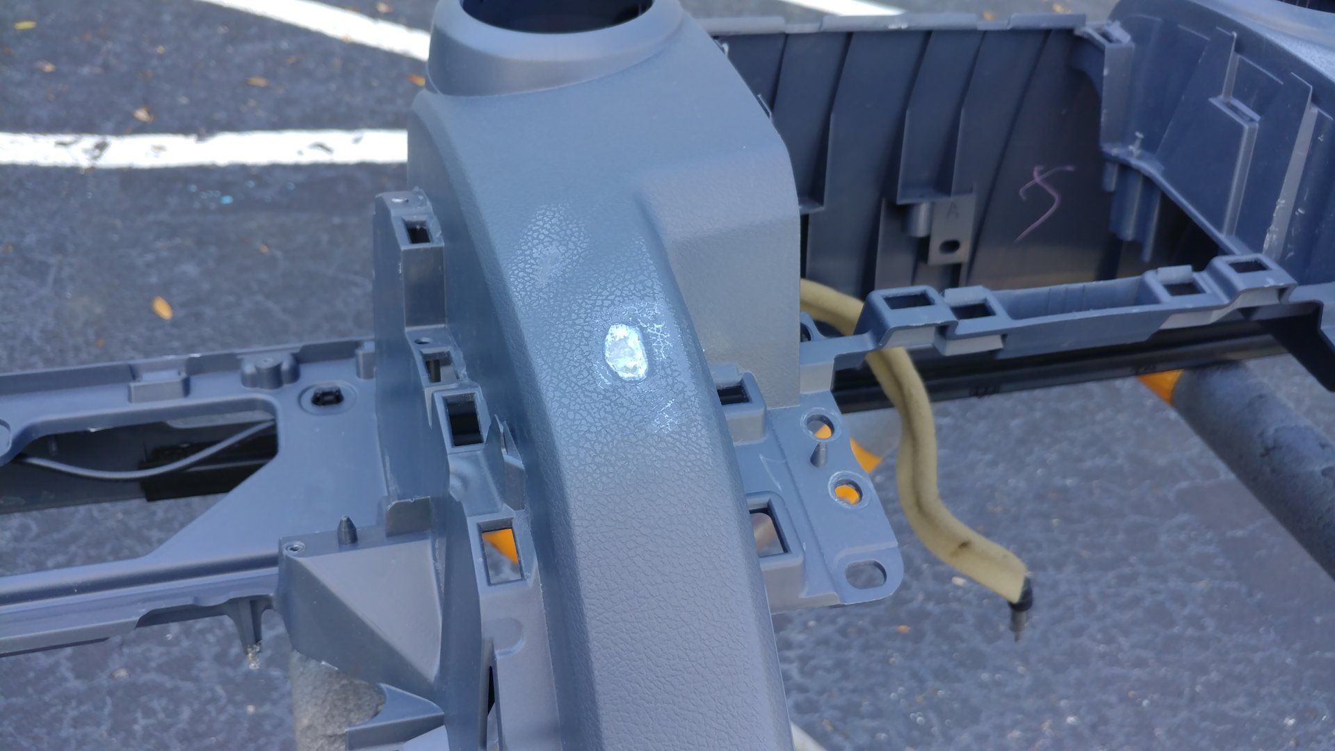

The most impressive part of the day was this. The dash and surrounding pieces were finished up. Incredible.
This is how we started
Mid way thru
Done!
That dash fix is astoundingly good! Whoa.

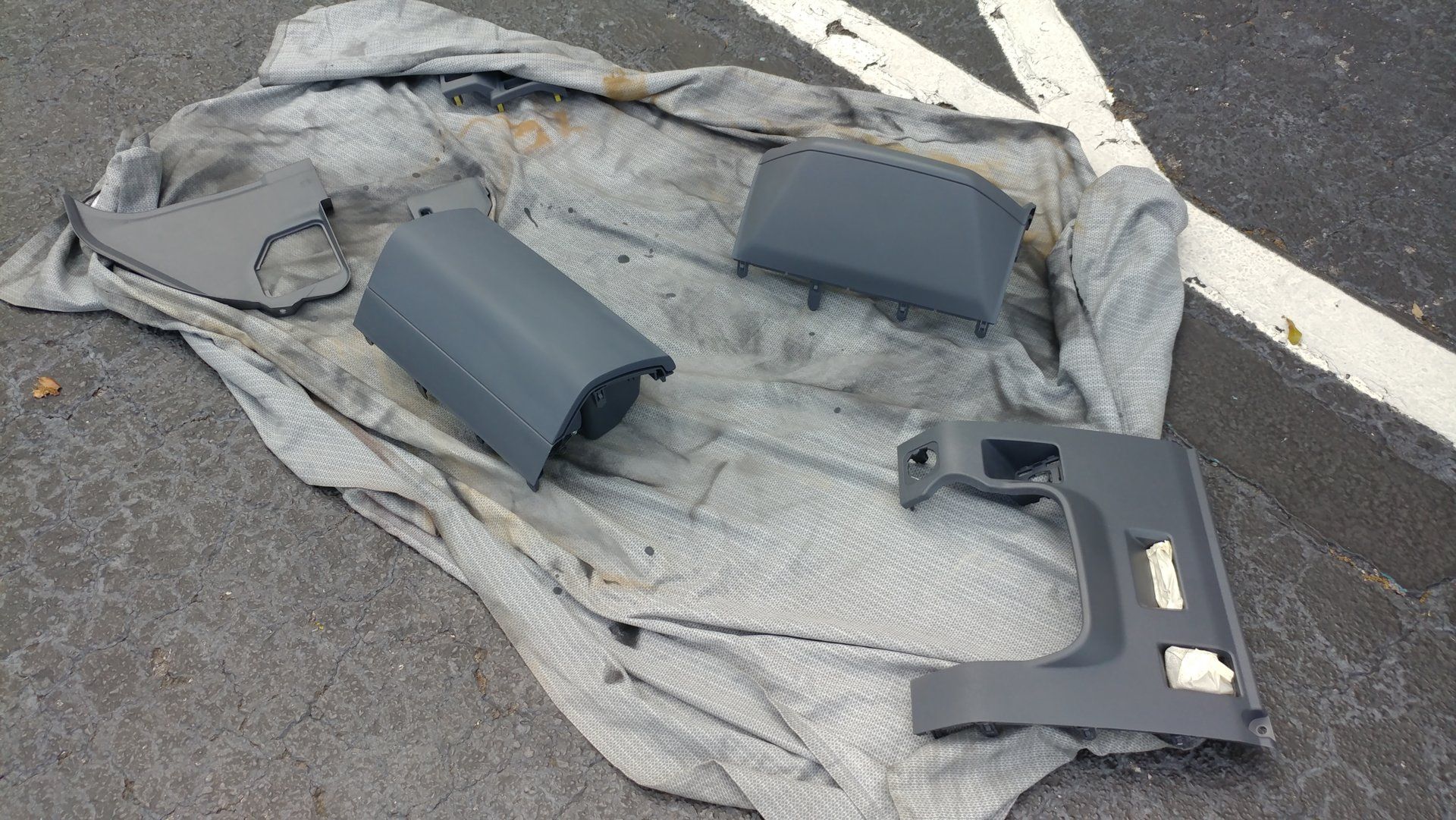

3 different shades of grey on these 4 parts. Far too many shades. I had our interior specialist paint all of it to match....very very light dusting on the stuff that was close.
Just look at all this goodness! Beautiful stuff. Should be going in very very soon. Absolutely thrilled with the way it all turned out...not a surprise...our girl Kat is the best at this stuff. Miracle worker.
It's incredible. It's hard to believe how good. You can feel a slight difference in how the painted areas are vs the stuff that isn't painted but I'm not worried about it. I won't be fondling the dash too much.....at least after the first few days :)

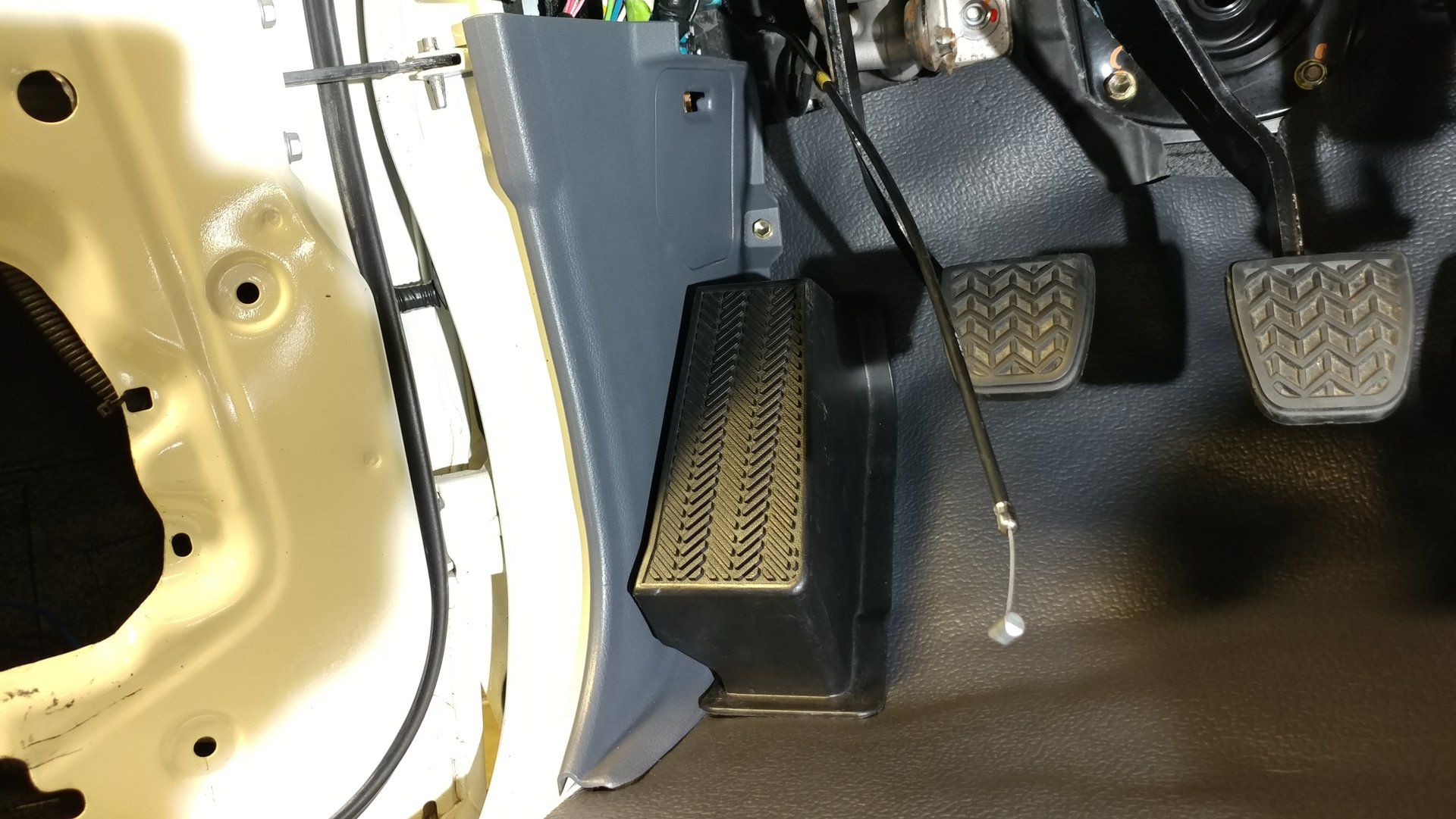

Mounted up my dead pedal along with the kick panels.....all of this stuff is a tight fit due to the sound deadener and additional wires we are running along the floors and up in the kick panels. Kind of a pain.

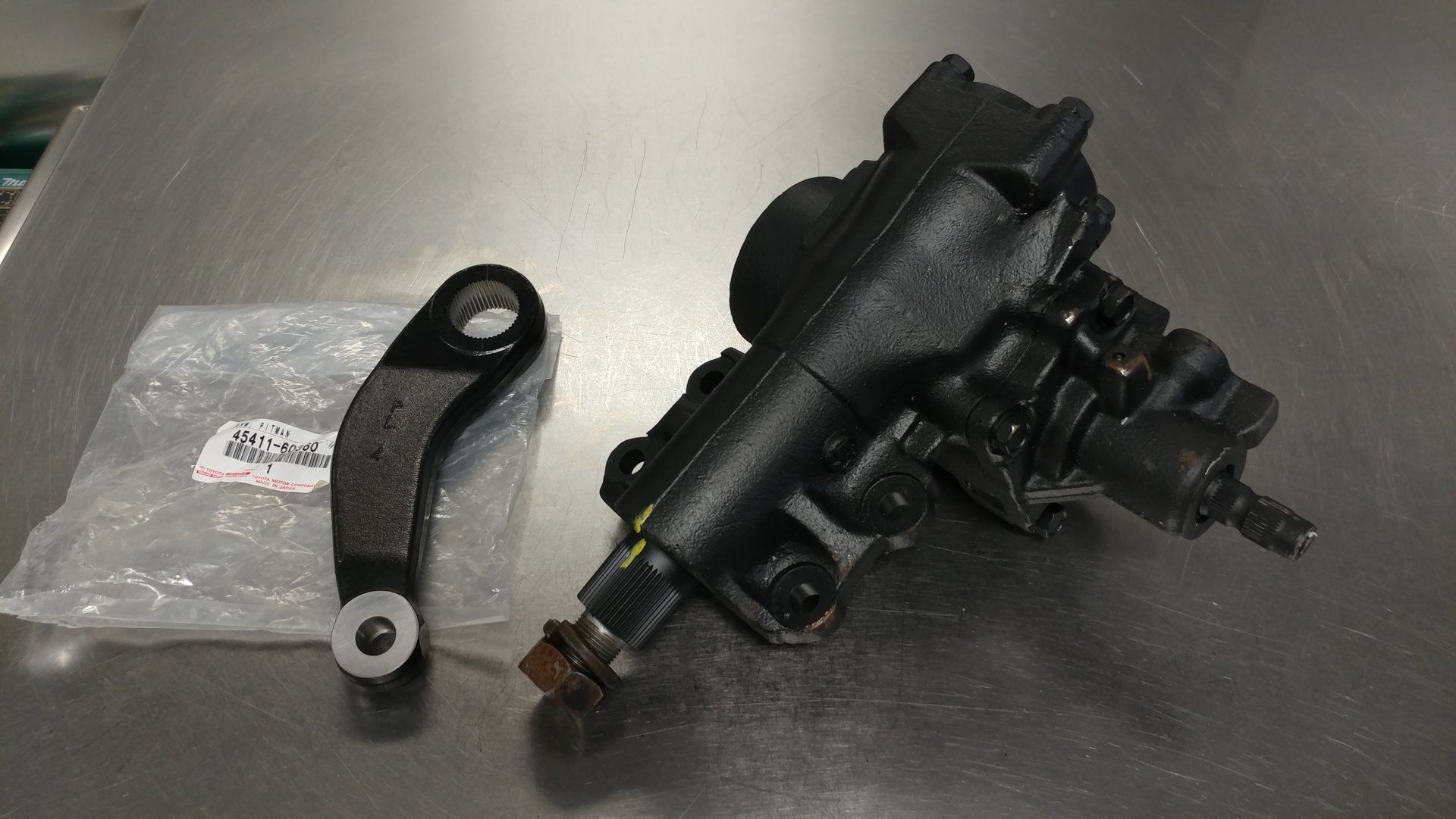

Got this back from West Texas Off Road......nice and refreshed 80 box with the 105 sector shaft upgrade. Requires a 105 pitman arm too. Expensive setup but not nearly as expensive as a new 80 box.

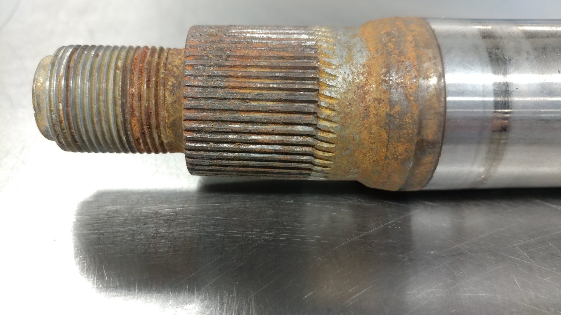

And this is the reason we needed a new sector shaft on this box.....twisted splines and the whole shaft is bent. Yikes.
View attachment 2231591View attachment 2231593View attachment 2231594
View attachment 2231592View attachment 2231590
Check to make sure they installed the seal where the sector shaft comes out of the box, they forgot on mine and i did not notice until after the pitman arm was installed.
Funny you say that....my tech immediately questioned how that shaft was sealed when we were looking at things. I'll have a look. Thanks.
