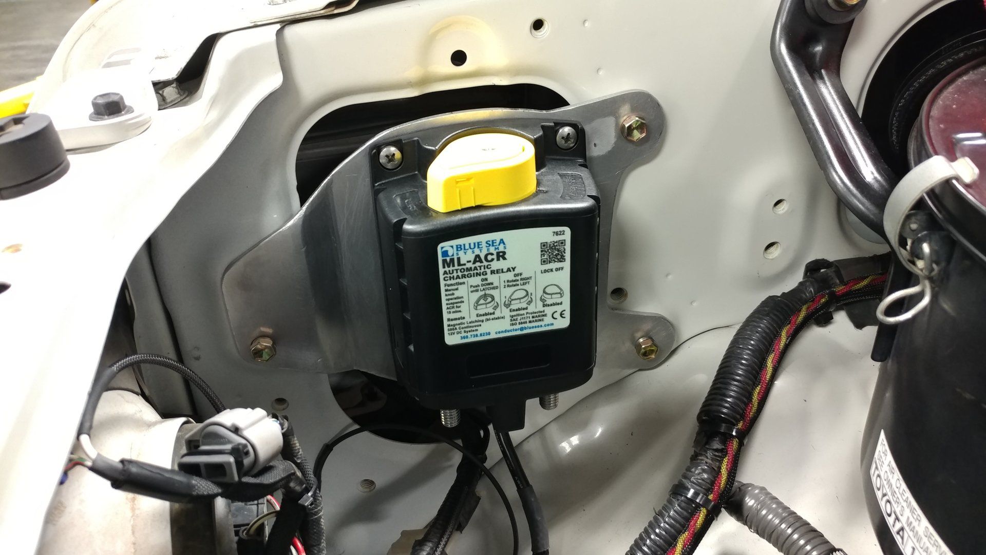

We are installing a Blue Seas 7622 battery isolator to isolate the 2 batteries.....going to be switchable via a button on the dash.
Yet more wires being run. My tech is going to kill me if I add anything else. Pretty sure I'm done......well......maybe.
Going to put this thing in the only spot we have left.....behind the right headlight. Bracket making will occur tomorrow :)

Buttoned up the mount for the Blue Seas isolator in the engine bay. We also wired in the switch inside.

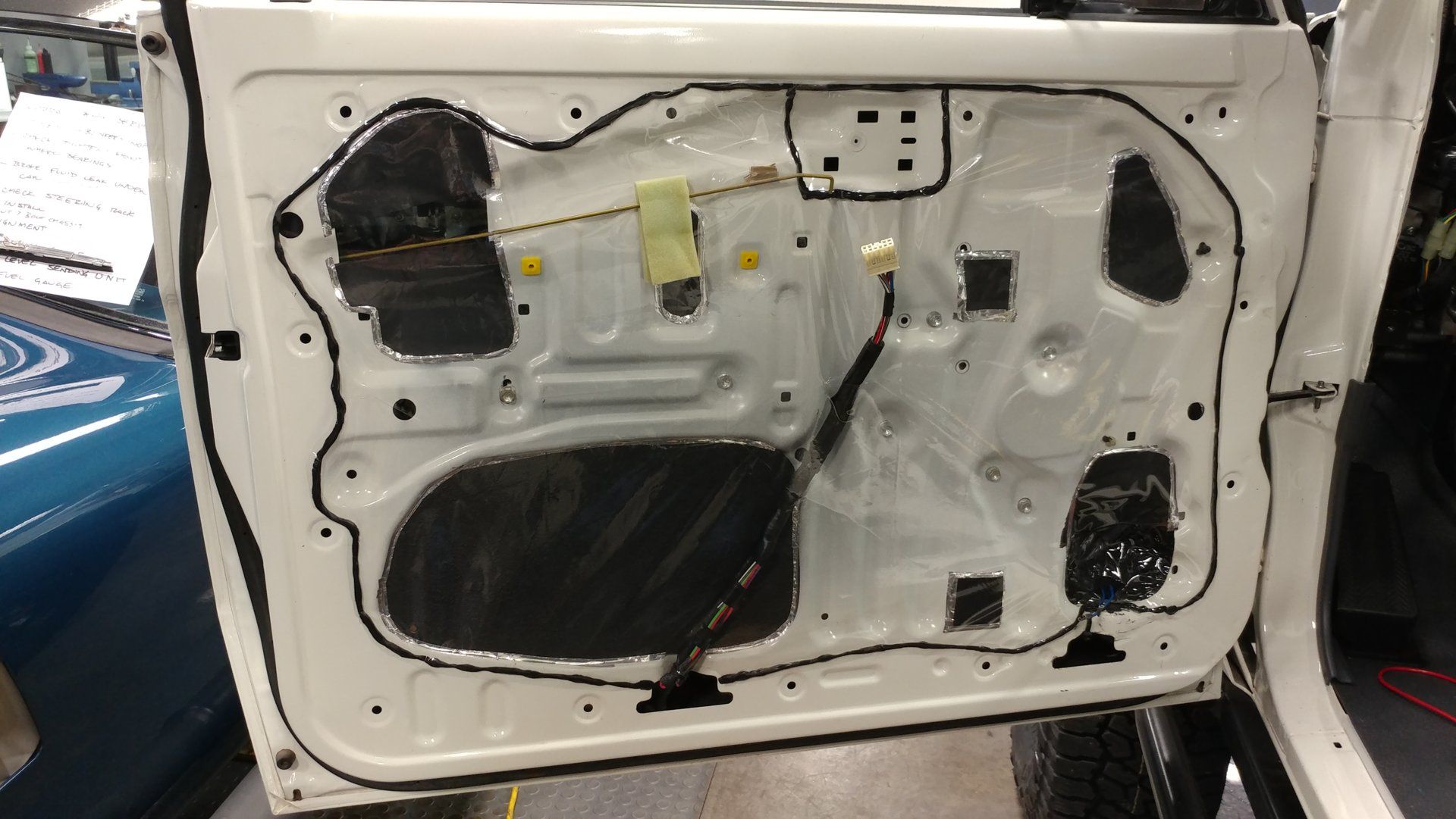

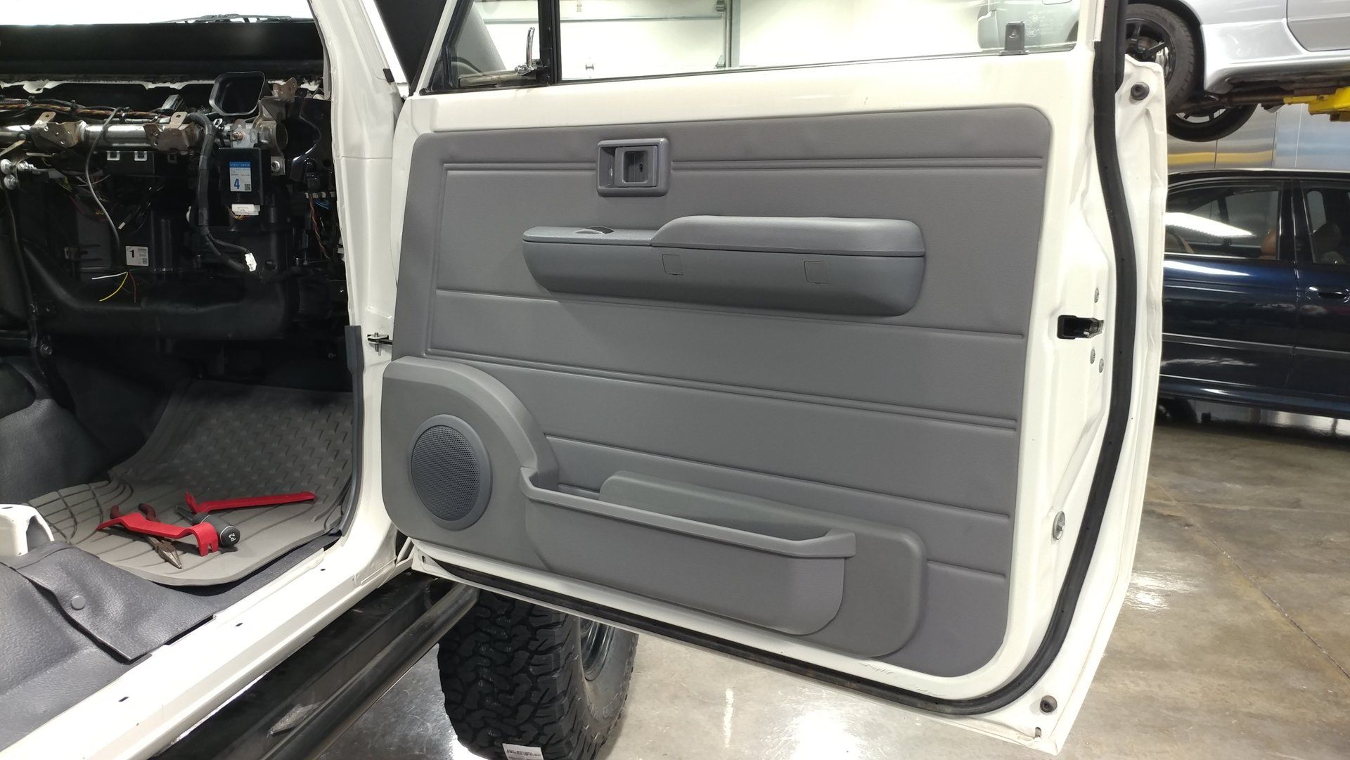

While the guys were messing with their various projects, I worked on door panels. Standard speaker pod install with my go-to JBL speakers...6.5". I had already fitted everything and trimmed my door openings so these door panels just needed to be put together and installed. Technically not that simple, the doors needed some work before these went on.

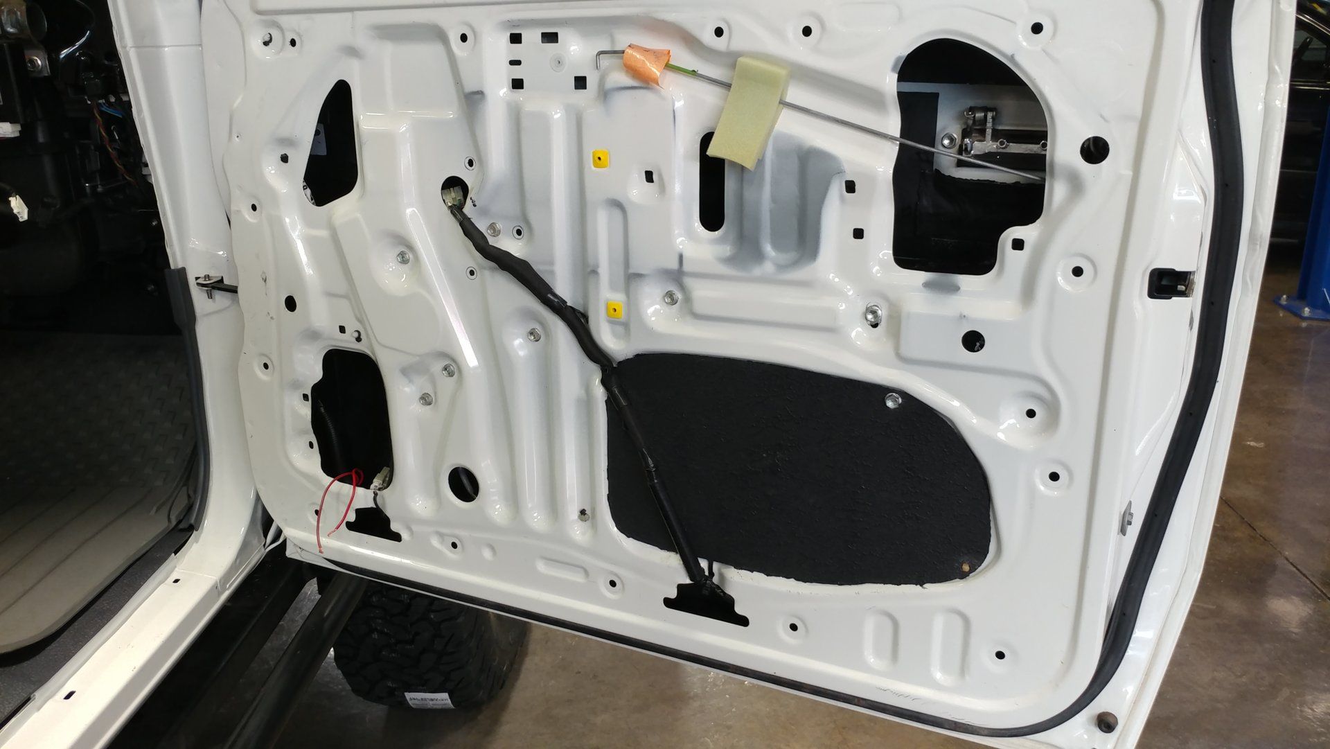

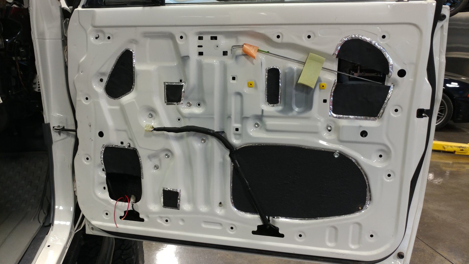

I had read somewhere that making panels for the larger openings of the doors was important to keep out noise...I've done it before with sound deadener but that's always kind of messy. For the largest opening, we had made light sheetmetal fillers and coated them with Spectrum. Today we closed up the other openings with deadener and then made some vapor barriers.
Lower panel installed with butyl adhesive and an existing fastener. Not 100% sure these won't vibrate but they seem super tight.
Filled in the other openings with deadener....taped the edges so none of the butyl gets all over anything which it always seems to do.
Vapor barrier on the driver's side....we use shower curtain material....easy to trace out and cut.
And if these aren't beautiful, I don't know what is....
Really cool to have power windows. Took a lot of work to get there though :)

Getting close. Looks awesome.
Those door panels are a work of art.
Completely brand new....every. single. piece. It was therapeutic to do them today. Was able to fiddle with the stereo today too....the speakers sound incredible with all the sound deadening. Very very stoked.

Question, on where you mounted that blue sea switch, does the washer bottle fit behind it, or did you relocate?
