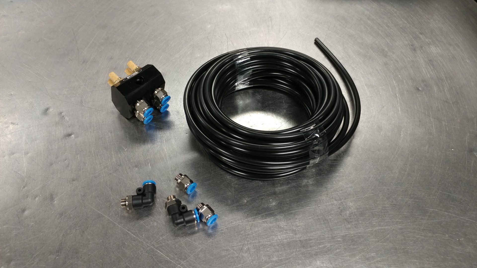

Blew the dust off this cool remote breather setupI bought a while back. Wanted to take a look at it...going to run the lines for this at the same time I do the sub tank fuel lines...will run the rear diff line in the same holders that the fuel lines will be in. Not bad quality for ebay stuff.
