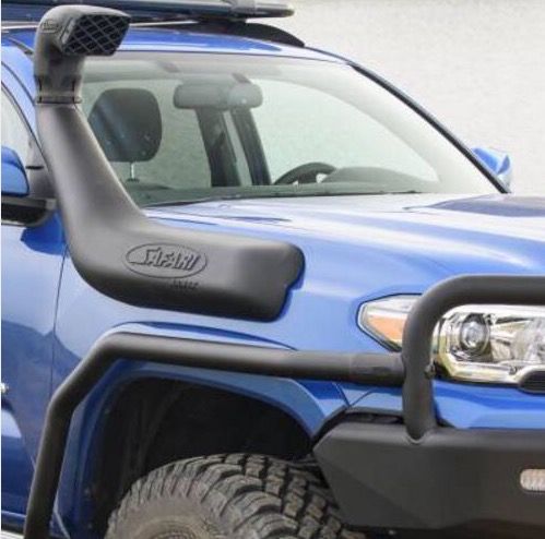

I decided no to move on the Armax snorkel until I get my side bars on, exactly coz how massive it is ..
Side bars may find their way on this truck at some point.....
Let's at least get the proper truck with the bars....
