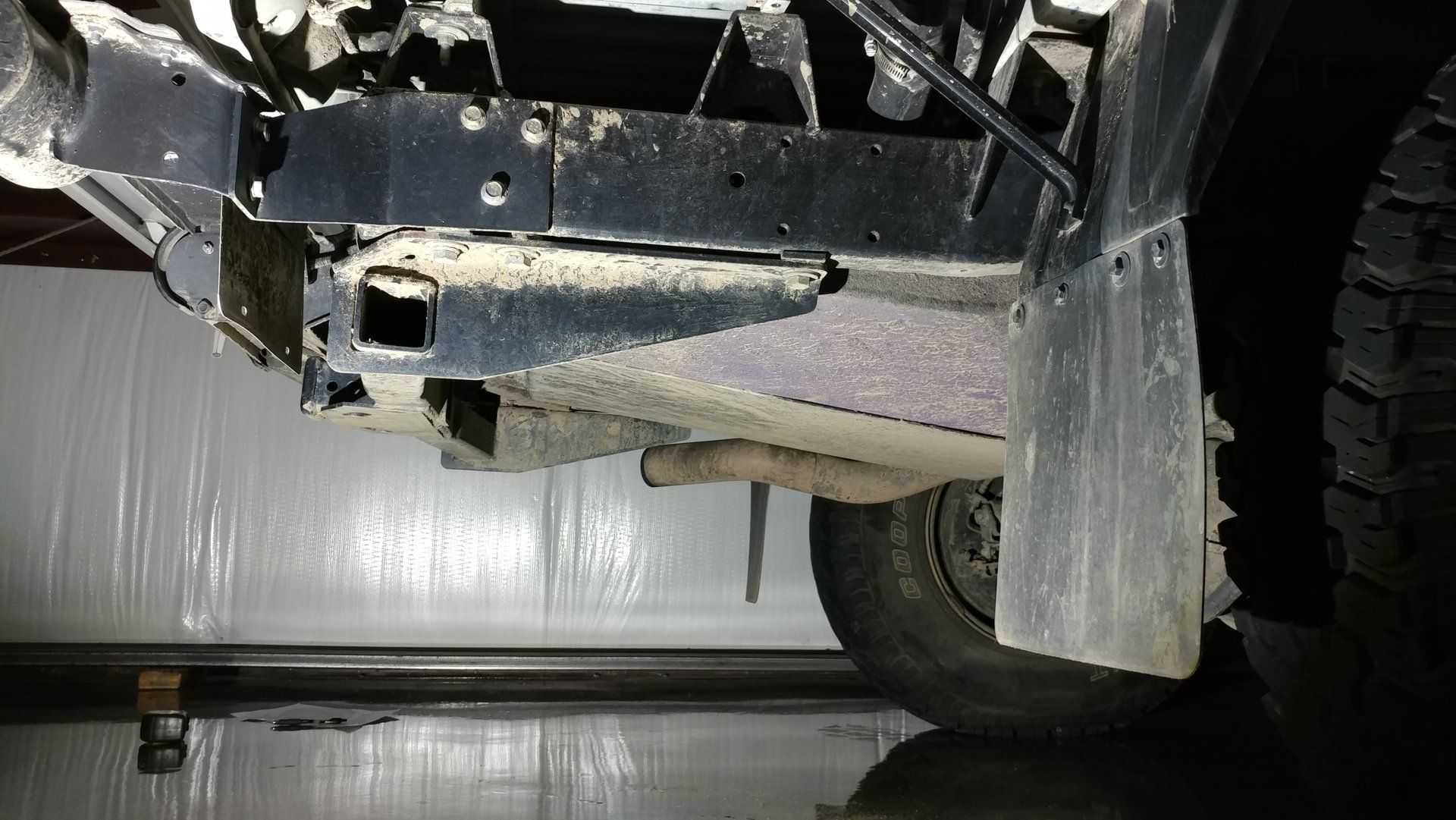

Today I was having a look at my OEM 70 series sub tank. Not so sure I'm digging the setup....the 70 sub tank hangs low(at least in my mind.... but apparently that's how OEM units fit. I think they are a bit more hidden due to the leaf springs in the rear on a real 70.....I know I've never noticed them before. Sure seems like rear clearance would be compromised with this tank but maybe that's not the case. Certainly open to opinions.
My tank is really far rearward in these pics....I can move it forward about 5"....which gets it back a little.
This is the tank on #1....hard to see because of the hitch. It's really nice how it fits. About 28.5 gallons. OEM 70 tank is 25 I think.

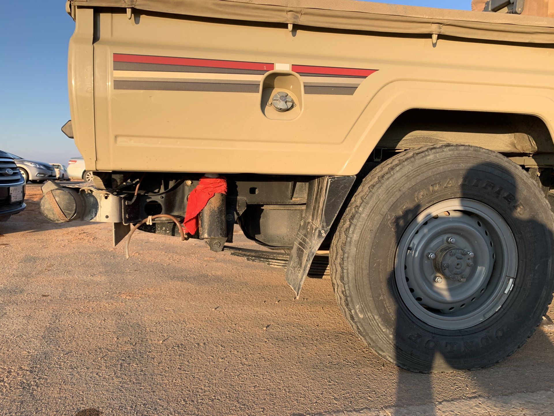

I don't notice the rear tank on the 79 pickups in KSA and I see them everyday. I'll try to snap a picture of one. Looks like your tank is maybe deeper than OEM?
I have NEVER noticed the damn sub tank until today. Lol. Now I see them on everything. Again, the OEM position is way more towards the front of the truck since it has leaf springs...easier to get near the axle vs. the coil spring in mine which has a pan hard bar/brace for that pan hard bar that takes up a lot of space. So mine will be a little rear biased.
The leaf springs kind of hide it too. Trust me....once you see it, you can't un-see it. Lol.
Kind of a bad pic as you see more the further back towards the rear axe you go....but you can see it in this pic. Tough to see.
