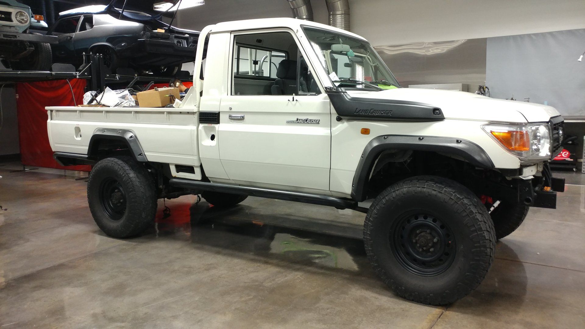

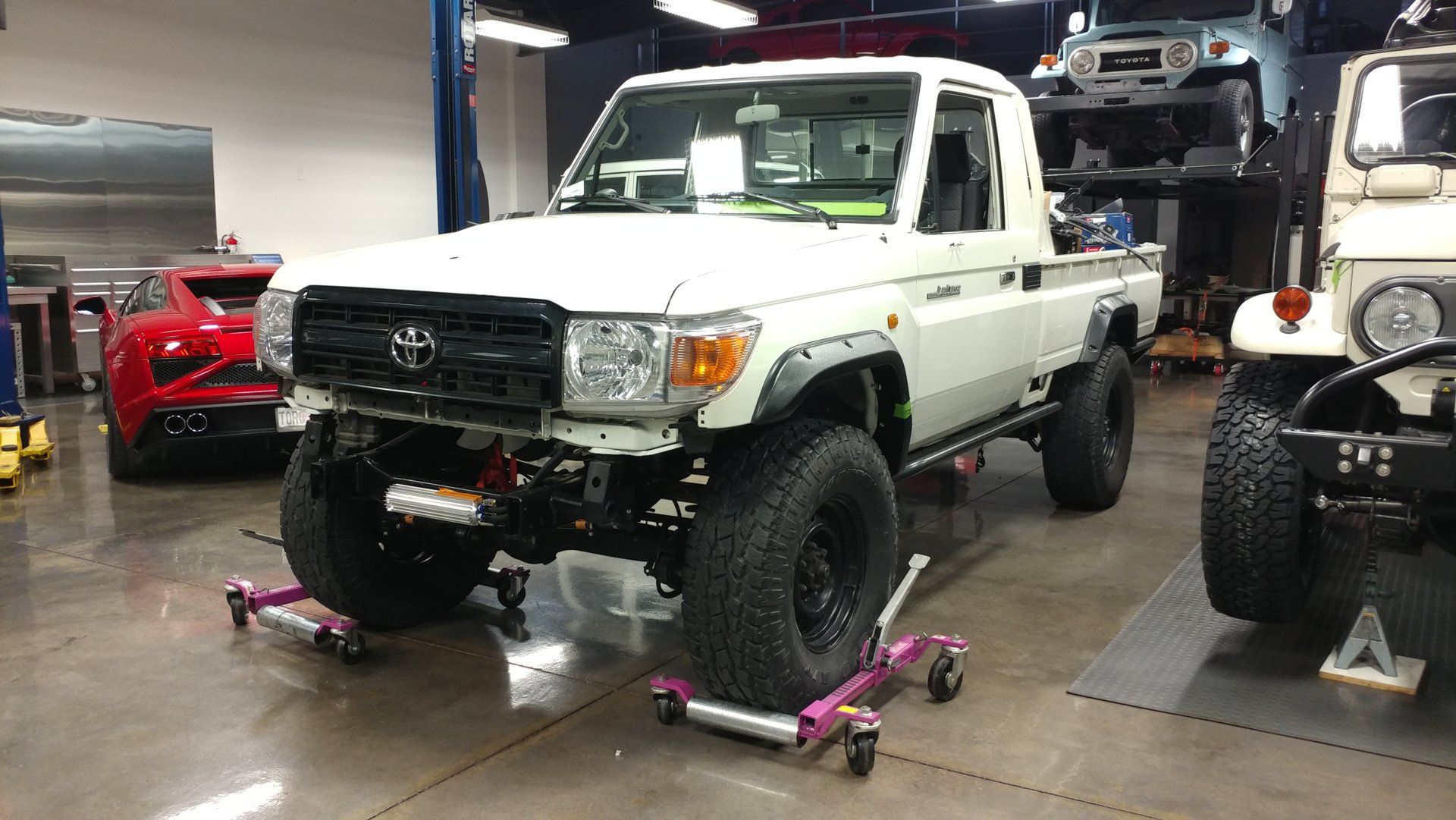

Popped on some 33s with OEM 16" steel Tacoma spares.....truck looks a lot better than with the goofy 80 series rollers we had. I think I've decided on 17s for this truck with 34"-ish tall tires. Should be a really good setup. Might change up the suspension once we get the 34s on....
Digging the look with the wider tires and Kut Snake flares and the sliders too. Really different from #1 with the skinny tires and stocker running boards. This truck sits higher too....OME springs. Need to look up the number and see which ones are on it. Nice to see it with it's face on too...been a while.
Starting to install things for final......I don't think the truck will be coming part again. At least I hope it won't be coming apart again. Sometimes they do.
