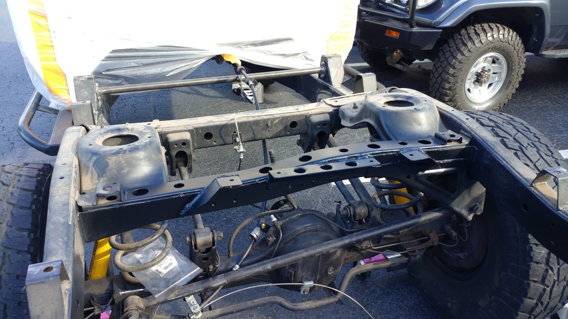

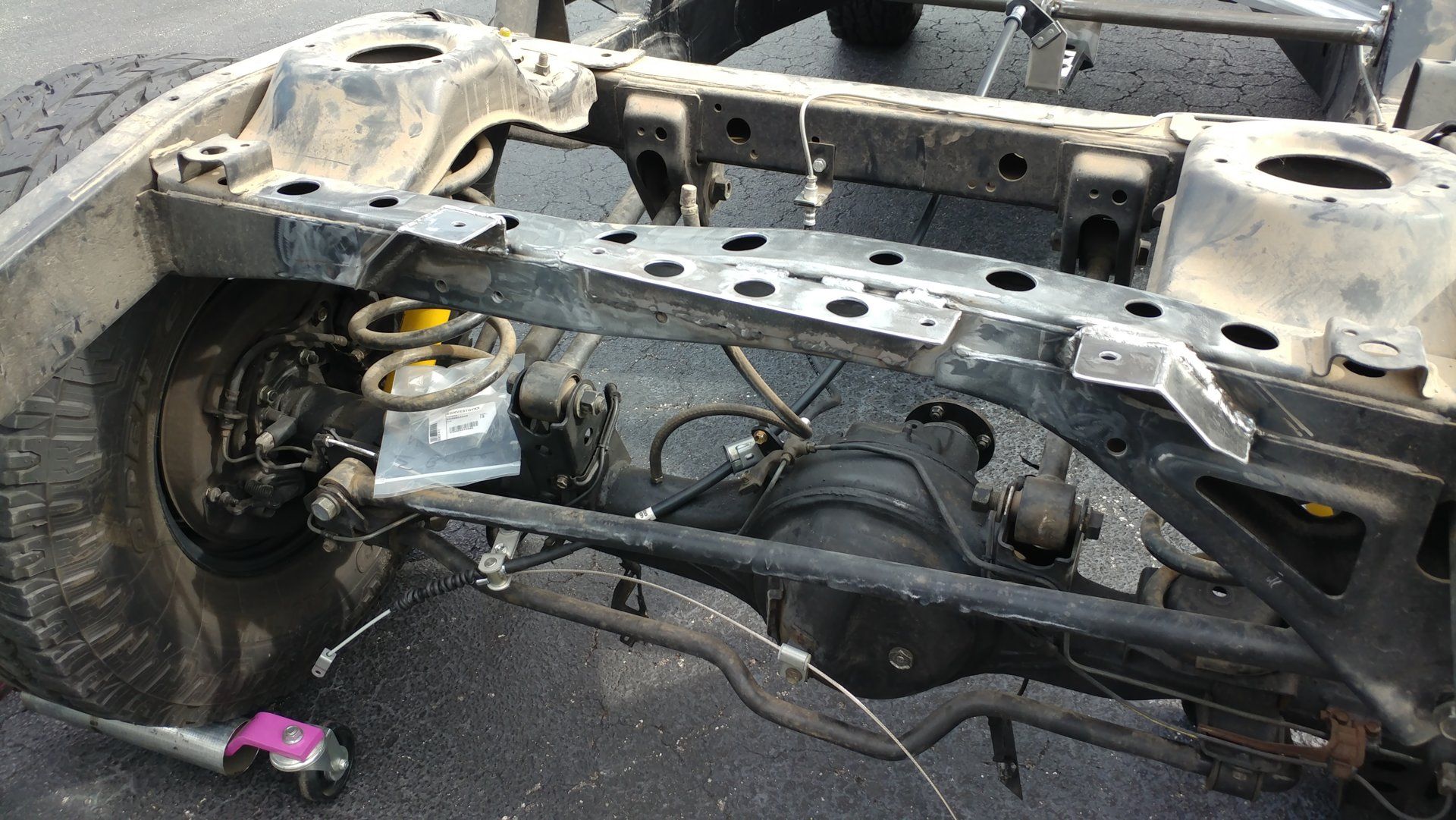

For sure it's ugly. It's awful in fact but it's strong, works perfectly and I'm trying to control myself....I have the tendency to over think things and slow these builds down. I really need this truck to be out of fab and into the next phase....there's another one that needs love :)
The kid didn't come up with it, I did. I was going to have him build a set of brackets like what he did for the outsides....but in an effort to save time...I ran with the angle. I discussed it with him.....why I didn't like it, why we would do it differently if it were on a customer build, why I let it slide on this. Eventually I will have to turn him over to the customer car side of the biz and I want his brain to be in that mode of easiest is not always best...build things that function and have thought put into them. The devil is in the details I believe is how that saying goes....

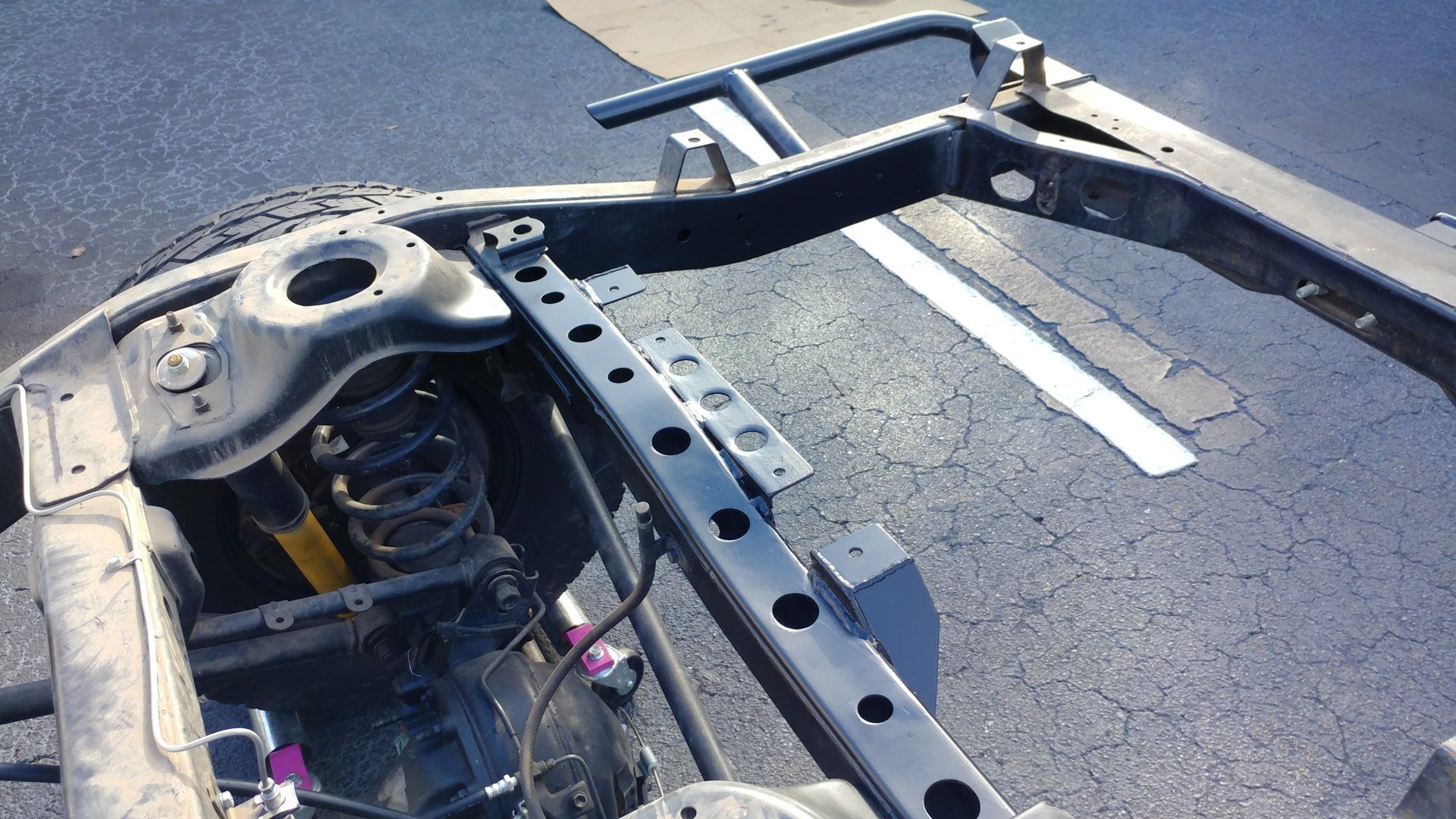

This is how we finished the day out.....our rear cross brace primed and ready for paint. Risers welded on for the tank mounts...fits like a glove. Tomorrow we'll put the truck outside, pressure wash the frame, prime, paint our new welded areas and move on to the front tank...hopefully it's a bolt in...which it should be.
@c2dfj45 ...... "For sure it's ugly. It's awful in fact but it's strong, works perfectly."
At some point you have to ask yourself if you're building the Ute to please you or to please a handful of guys on 'MUD.
The answer to that is ALWAYS me :) which is why I fixate on stuff I shouldn't fixate on.
A little bit of love, a few holes, looks like it was meant to be there. Painted, ready for the tank to drop in....cool day here today, we couldn't get anything to dry quickly...anxious to get the tank in and move on to the next one. I think this has occupied us the whole week.

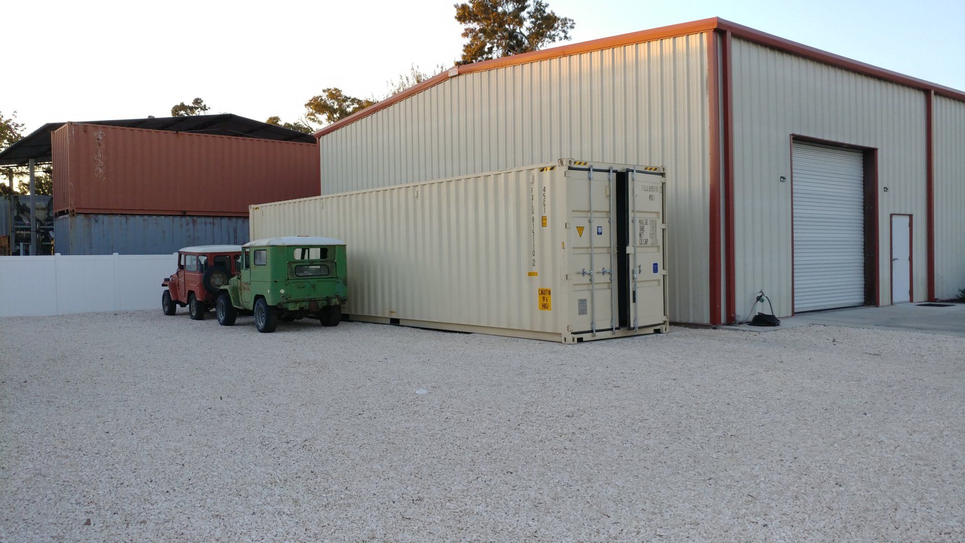

Got another one of these...dropped off. Ran out of room in the first container....now I can really start stashing away LC stuff. These are cool.....1 trip containers. They come here and it's too expensive to ship them back empty. So they sell them off or rent/lease them to places like Walmart to store seasonal stuff in(Xmas layaway things according to the driver). They're virtually new inside. Really cool This one is a double door....front and back have double doors. Kind of cool. If you need a container, Philip at Boxhub is probably one of the best guys I've worked with....incredible customer service.

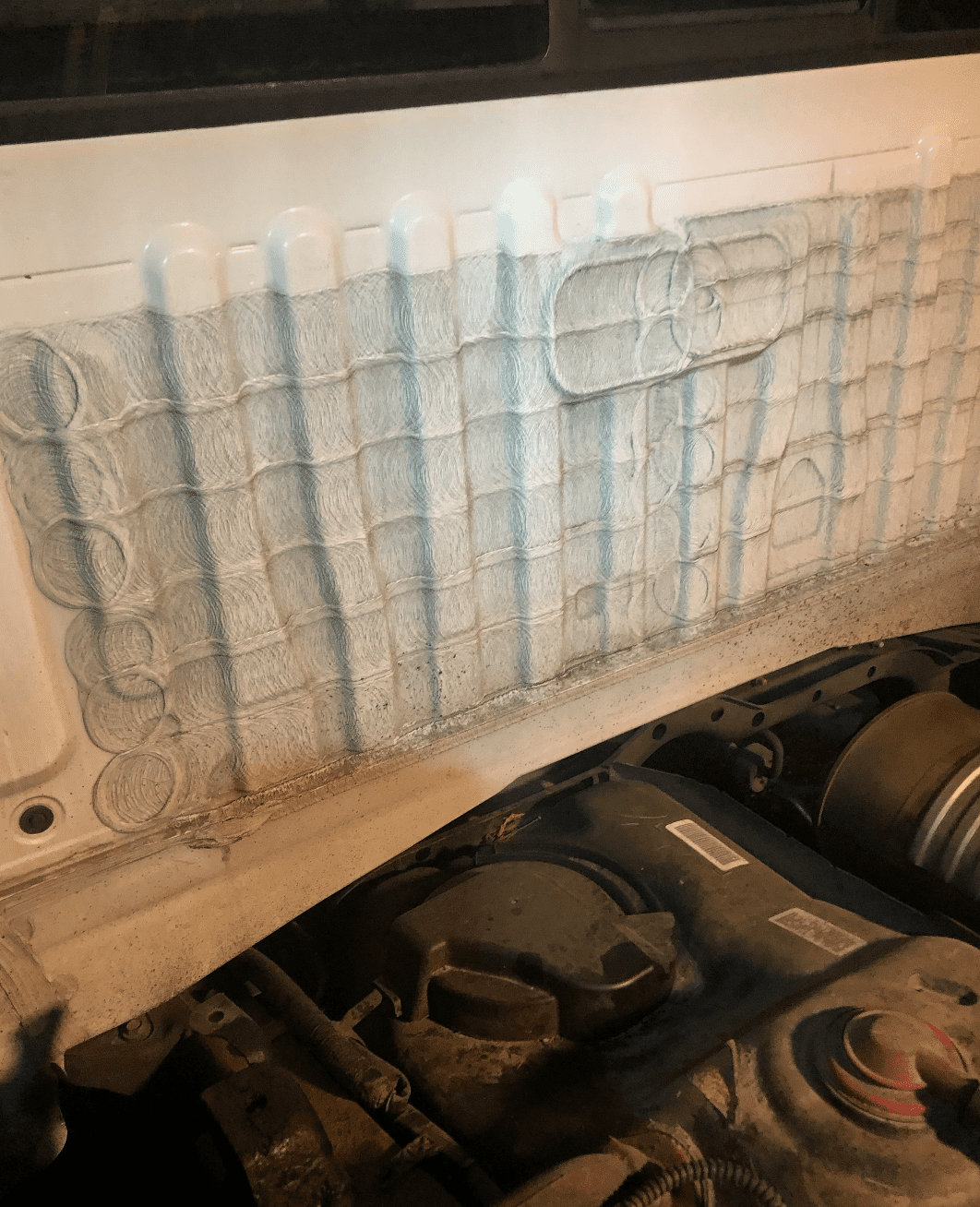

Had some time to spray in some Second Skin Audio Spectrum on the rear outer wall of the cab...probably not necessary since we have quite a bit on the inner cab rear wall but I figured more can't hurt. Eric at Second Skin was saying a lot of sound comes up thru the area between the bed and the cab and bounces around back there. We'll see how it works out...

I applied the Spectrum to the painted metal of the cab. We cleaned it, taped it, sprayed it. I haven't found a need to scuff anything if it's SUPER clean or new. The stuff sticks like crazy.
I believe(key word) that I read where you can topcoat the Spectrum but you have to wait for it to dry. Specifically it was pertaining to bedliner over the Spectrum....but I would imagine that would go for paint too. Something like 30 days of dry time. It's water based...so I think the stuff needs to fully cure and get all the water out of it.
I'm torn on the spraying of the Spectrum....it takes a long time to build it up. I think my brain is programmed that somehow this stuff should just come out at 2-3mm thick in one coat. It takes a LOT of coats to build it up. This was probably 1mm thick but again, there's probably 3mm on the inside of the truck on this section.
