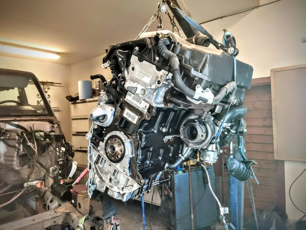

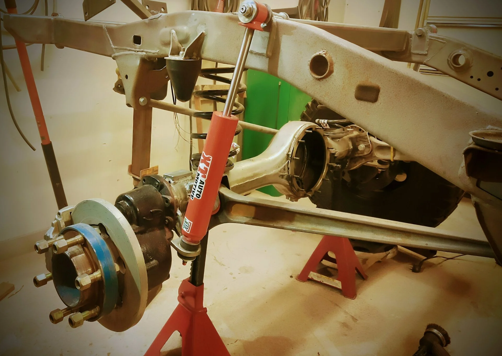

Before I laugh at prepping but I have bugout and fled from the war so now I build a serious car that I can feel safe with that will always be ready to escape
But of course the car is also built for overlanding hits etc

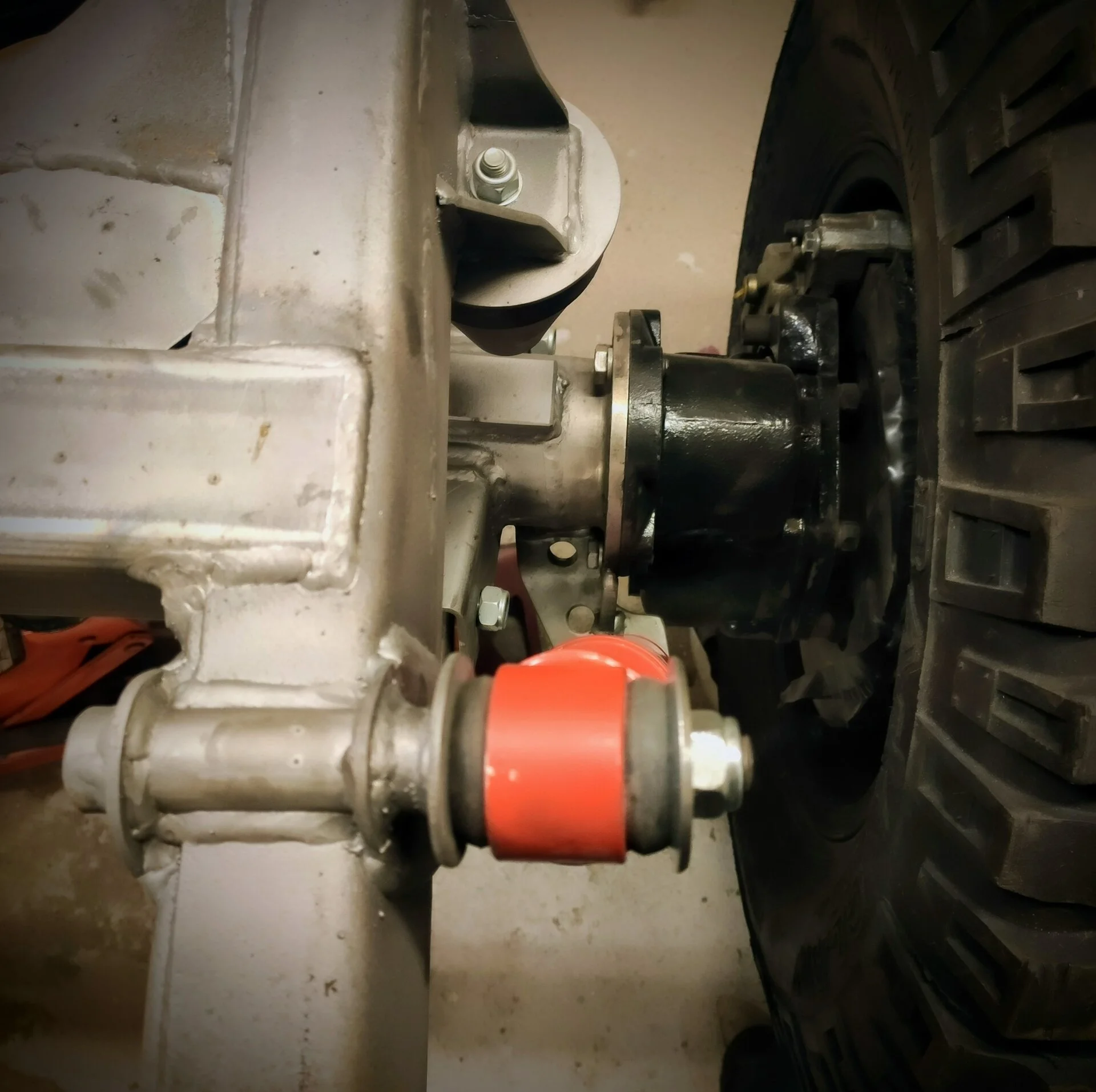

New portal axles based on the land cruiser's strongest rear axle both front and rear with ratchets and portal axles
BMW m57 common rail diesel
Warn Winch
Complete renovation
Extended wheelbase
40 13.5 17 MT tires

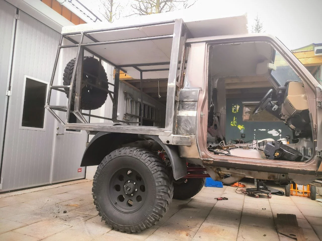

New rear end of the car with overnight accommodation
There will be some updates from time to time as the car is more finished than what I am showing right now, however not finished

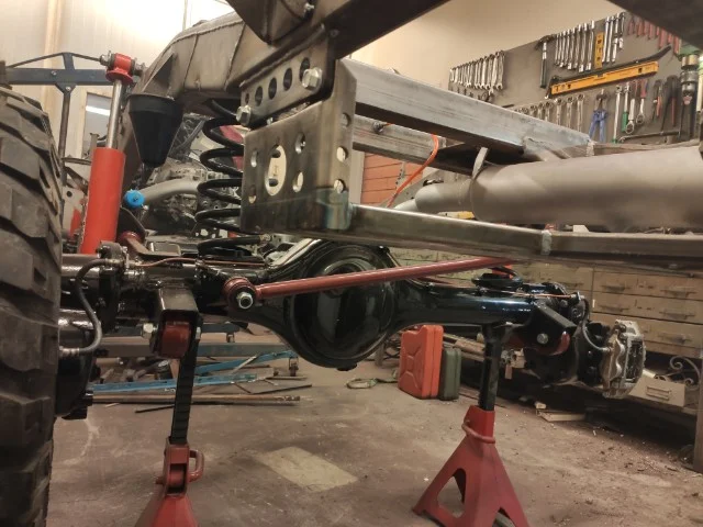

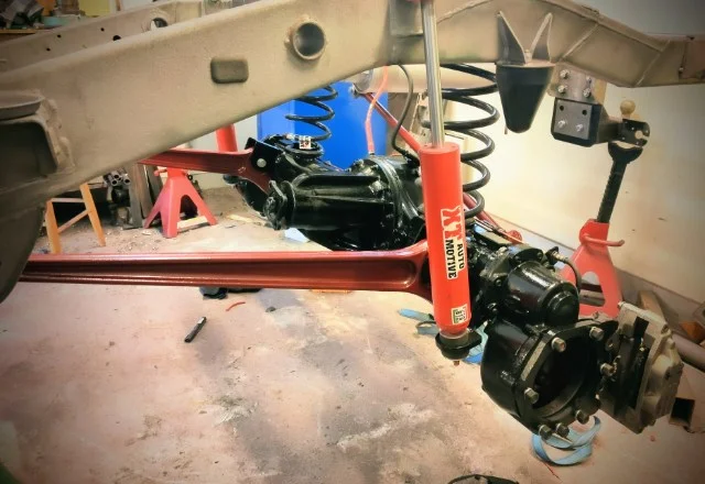

The rear axle, which is certainly newly manufactured, I have now blasted, then painted with black 2-component epoxy primer, then 4 layers of 2-component epoxy paint, so we can hope it can now stay in good condition for a while?

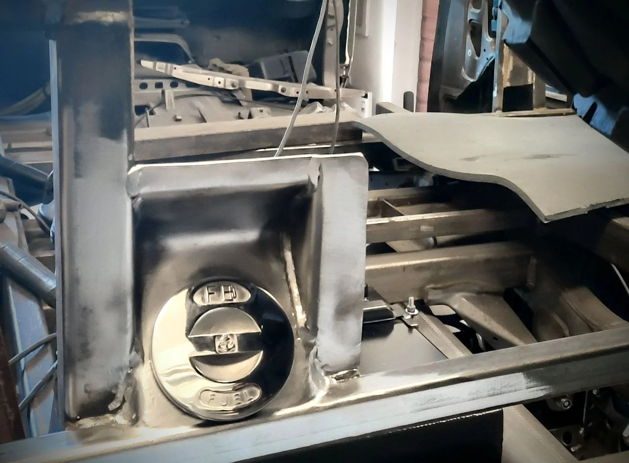

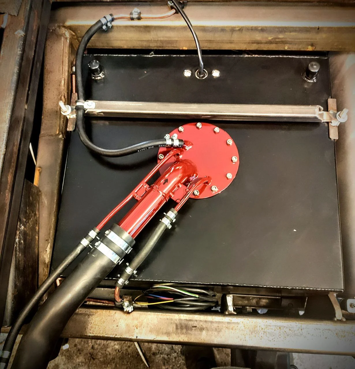

A small picture during construction of the combined attachment for the towbar and also the diesel tank

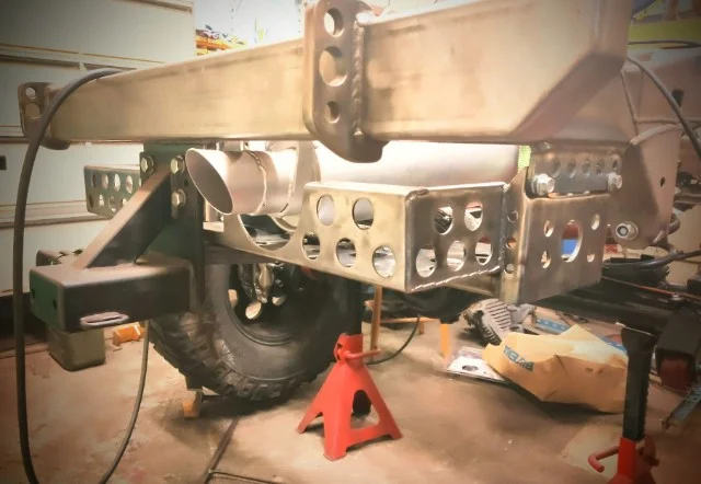

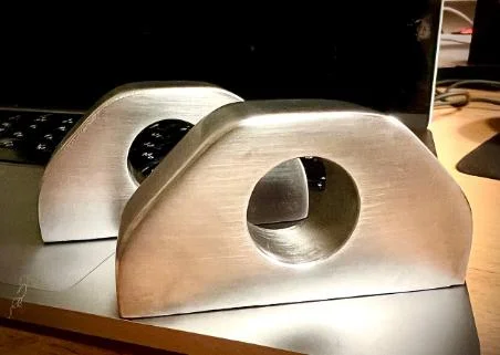

Hasplate under development for tank, silencer etc. there is little left 80cm clearance under the tail plate
