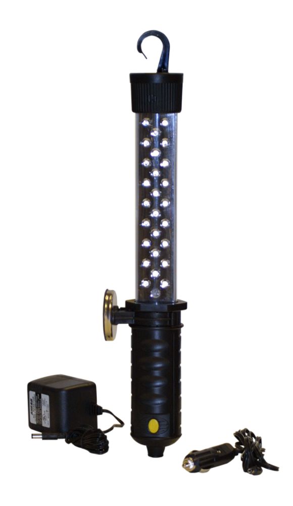

FWIW Ali: I recently bought a 12V 84 LED work light with 20' cord. Sounded great in the ad...but after getting it I'm not happy with it. Narrow light dispersion angle and the LED lamp color is too blue.
