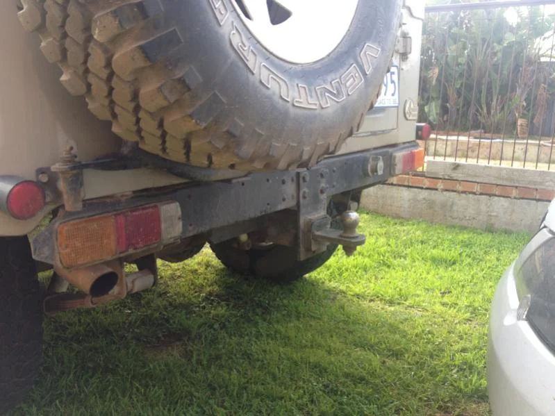

I've been having some tail light issues and after removing the lens I've realised that the whole unit needs rebuilding (reflective coating gone, bulb springs rusted etc).
While I fully intend to repair them one day, at the moment I want to replace them with some LED tail lights which will be far more effective than the originals anyway.
So does anyone know of anywhere (preferably in Australia) that has these to suit an fj40? Or even someone who stocks tail lights in general that I could adapt to my truck...
Just thought I'd ask before I go and buy something unknown off eBay or spend ridiculous amounts at an auto store
Cheers :D
A pic for inspiration :P
