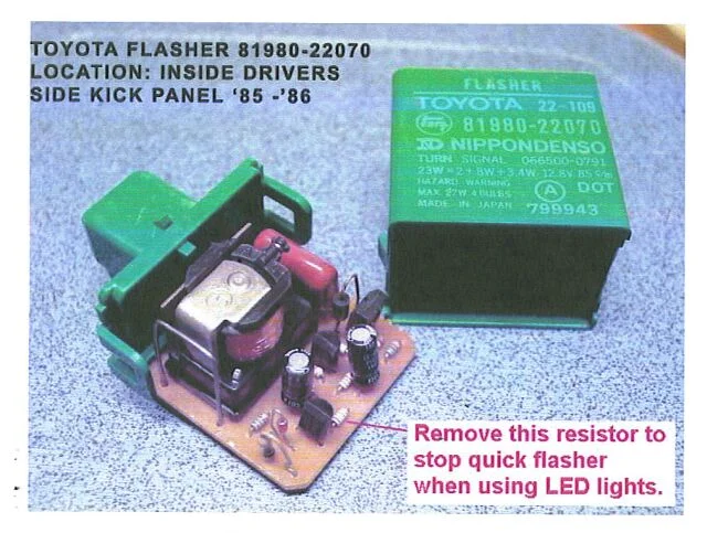

84 FJ, 3 Prong OEM Flasher Relay.
I swapped out all turn signals with LED bulbs. Was getting super fast flash at first, cut out resistor and now works like ti should. Nice and slow flashes.
This absolutely works 100%
:D *I still want to see if that will work with the 90-95 flashers, off to tinker with one of my spares. :) I'll post a pic if it works b/c I believe it is still a similar part # relay made almost the same. (81980-12070)
The newer resistor style, the 81980-12070 I am describing is a load sensitive setup also, you can try a 4 prong heavy duty relay, keeping in mind that Toyota's are hot switched versus ground switched. Your "B" and "E" terminals remain, but the "L" is bypassed through an adapter to move it to the opposite center terminal, make sense?
The resistor supplement is a 50ohm 10 watt, ceramic style, usually the "Dale-Type" being the best as it is inside an alloy (protective) enclosure, easily mounted to a body panel and heat sinks better.
ie:
This is what I was told to do to slow down the signals on my 81 with LED tail lights, not sure if 88 is the same. Havnt done it yet but was told this would work. hope this helps.
Nope, '88 is a different flasher - I desoldered each of the 3 resistors, one at a time - the one in front made the lights stay on solid, the large one on the left side and the tiny one under the relay both made the turn signals inoperative completely
- the 2 capacitors are wired in series with the large resistor on the side, so desoldering those would just kill the lights
- I think the "quick flasher" circuit is embedded in the chip under the relay, so no such luck with modifying the flasher on an '88
