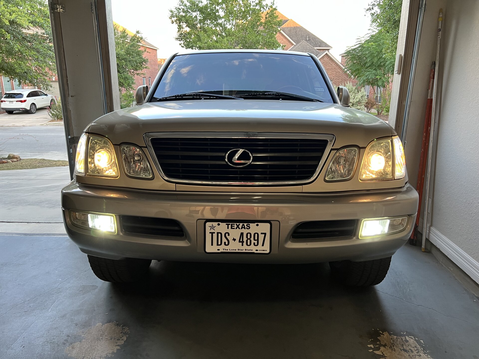

I have a 2002 LX470 and I'm running Lasfit LEDs (bought through Amazon) in my low beams, corner lights, fog lights, reverse lights, tail lights, and interior lights. The reverse lights and interior lights are stupid bright. The tail lights are a good improvement over stock brightness. The low beams and fog lights are better than stock, but they're not great for light output, they do look good though.
This is the only picture I have on my phone of the color temp of the lasfits (6000K). The foglights have been changed, the headlgihts and corner lights are still stock.
If you're looking for an alternative, the Auxito LEDs seem to be in the same cost range (maybe a few dollars cheaper) and quality range of the Lasfit's.

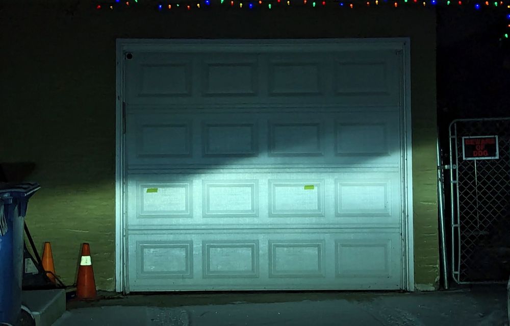

I got Morimoto 2Stroke 3.0 low beam bulbs in November and have been pretty happy with them. The lighting for night driving is much better. I drive a good amount on 2-lane highways at night and nobody has flashed me to dim my lights yet. This video has some other recommended LEDs:
No, the cutoff isn't as clean as a good projector retrofit. But the lighting is significantly improved over the stock halogen lights without dazzling oncoming traffic. My 2017 Civic with OEM LED headlights had much worse glare for oncoming traffic than my Land Cruiser with the Morimoto LEDs.
Photo of the light output with the Morimotos:
