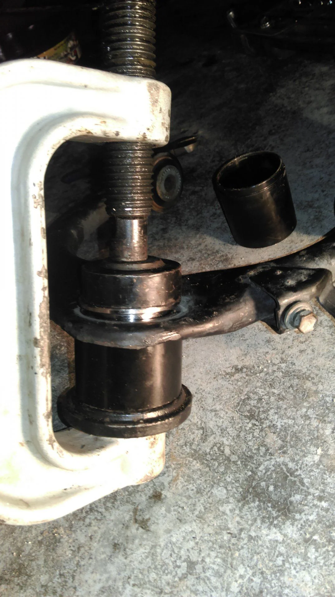

There's a reason Toyota only sells the ball joint as part of the arm. It is a royal PITA to get in and out from the arm. I got it out with a rental ball joint tool but could only get it back in on one side, and only after filing the opening. Second one is locking up the tool before it even seats. I'm now calling around town to find someone with a press who can just press it in for me, but this has been a multi-day saga.
Lesson learned - just replace the whole arm instead of trying to press in a 555 joint.

I know right. Lowers really weren't hard - they popped out with a hammer and went in with the ball joint tool nice and smooth and self centered. The uppers jiggle all around and don't seat when you try to put them in! Never again. If I hadn't dropped $60 on the 555 joint I'd say screw it and toss it in the garbage and call up Onur.

I had better success than @AppleTech did with the 555 ball joints. It was pretty easy with the arm off the Cruiser using my Harbor Freight press, even using the wrong cup for the job :cool:

That's the exact tool I was using. The problem was the ball joint just bottomed before even starting and the gun wouldn't move it. SO weird. Worked on one side just not the other.
Did you do any cleanup or filing or just pop the old out and put the new in?
I don't recall doing anything special. Simply cleaned up the mounting surface and wiped the hole with a very thin layer of anti seize before putting it together. The ball joint was a bit more finicky to get pressed in straight than I'm used to (I've done many, many Jeep axles and can do those in my sleep) but once it started there were no surprises except for keeping the press perfectly centered on the cup.
