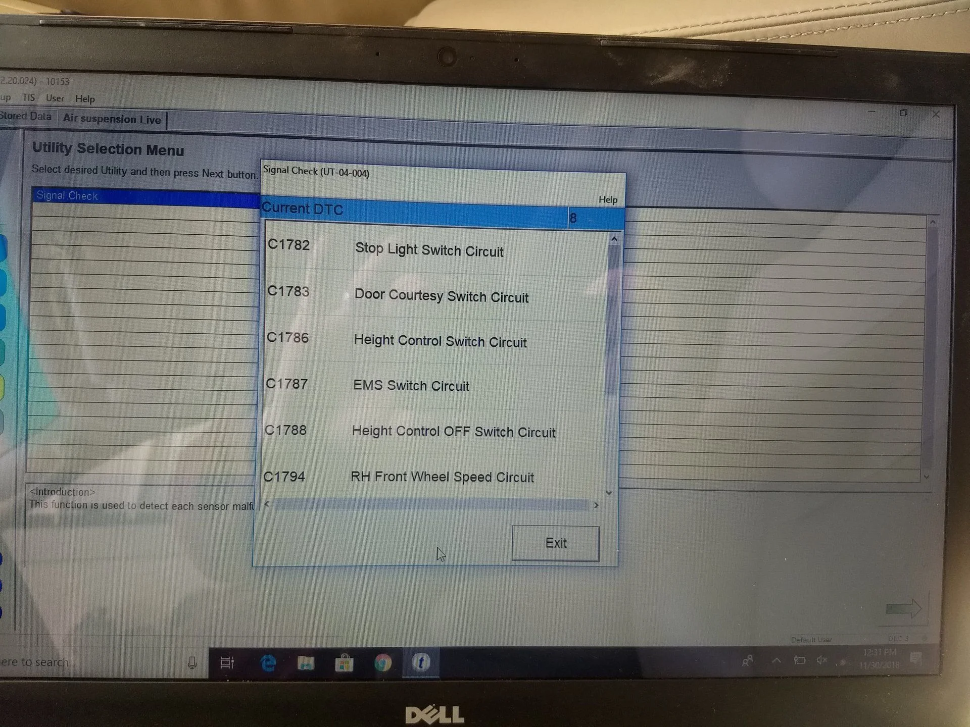

I know the best way to solve this would be a coil spring conversion, but I just want to fix whats there.
After putting new tires on my wife's 2005 non kdss gx470 I noticed it was leaning to the left. The passenger side is 1.2" higher than the right. I tried moving the height sensors and that didnt do anything. Tried resetting ecu by jumping #13 and 4 on dlc and pressing brake 8 times, no luck. Hooked up techstream and ran a signal test and got this
There is also a code c1795 LH front speed signal
The only thing the codes have in common is a bad suspension ecu. I don't want to throw parts at it so I would like to be sure that is what it is before I buy parts.
It still raises and lowers fine between high and low, just lower on one side.
Anybody have any ideas?

I would think that way if it were regular springs, but the air suspension is supposed to compensate on its own. An inch and a quarter is too much lean .

Oh! That changes everything. I'm not sure what that might be. Possibly a bad sensor or a bad air bag? Clogged air line on the driver's side? My passenger side sensor went bad a few months ago and caused the whole back end sit on the bump stops. Replacing it fixed everything.
I really appreciate your help. Figured it out. The front left shock snapped at the bottom mounting eye.
