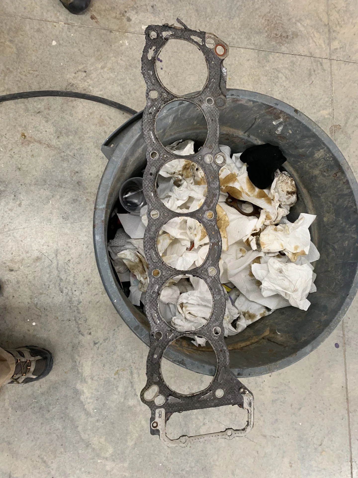

Well after performing a leak down test the coolant reservoir was rather bubbly. Problem found. Now with a little help from some friends and some larts from Beno it will get a variety of new gaskets and hoses as it gets rebuilt.
Was surprised at how mild the symptoms were. Caught it early enough to avoid block pitting.
