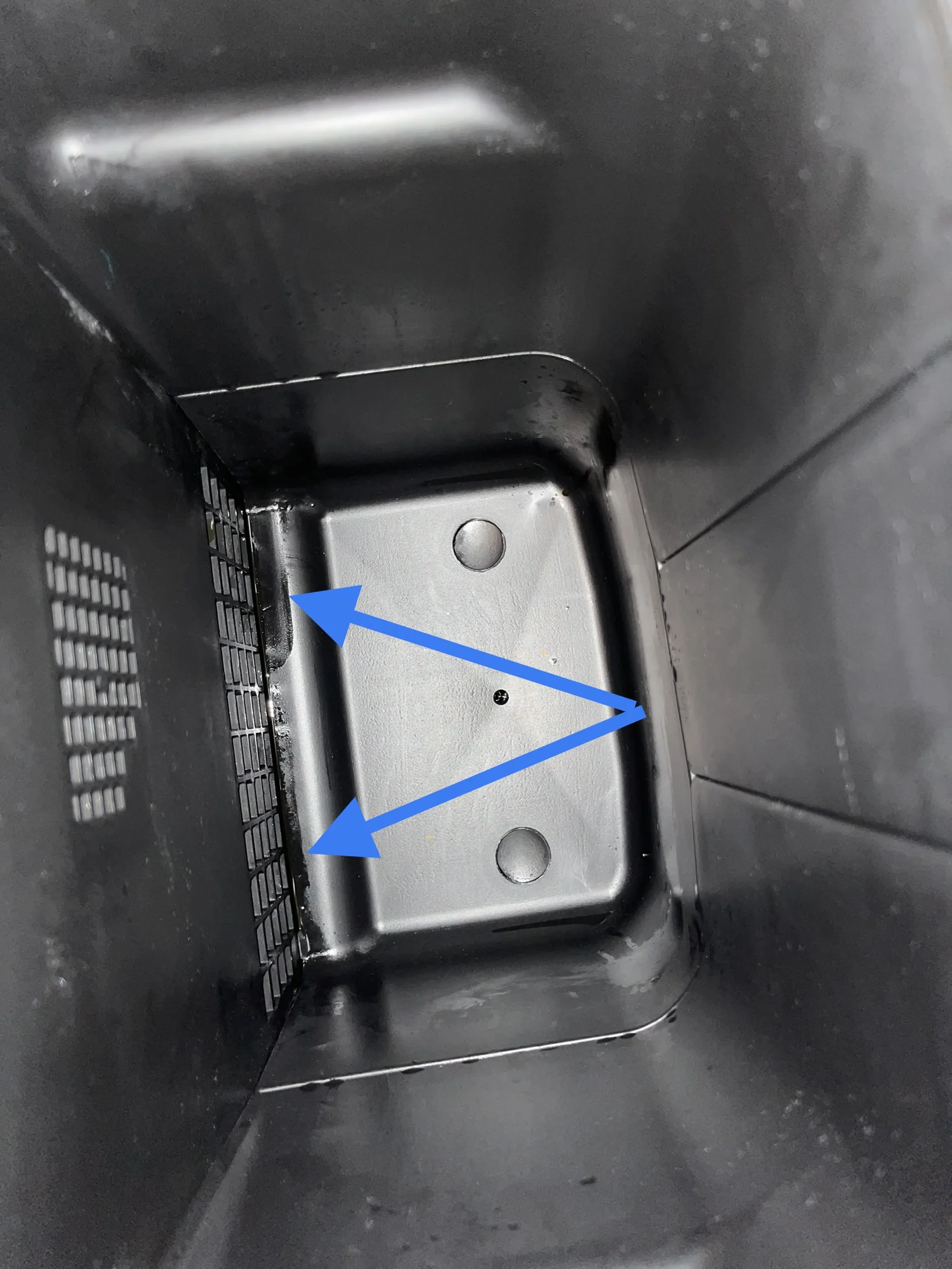

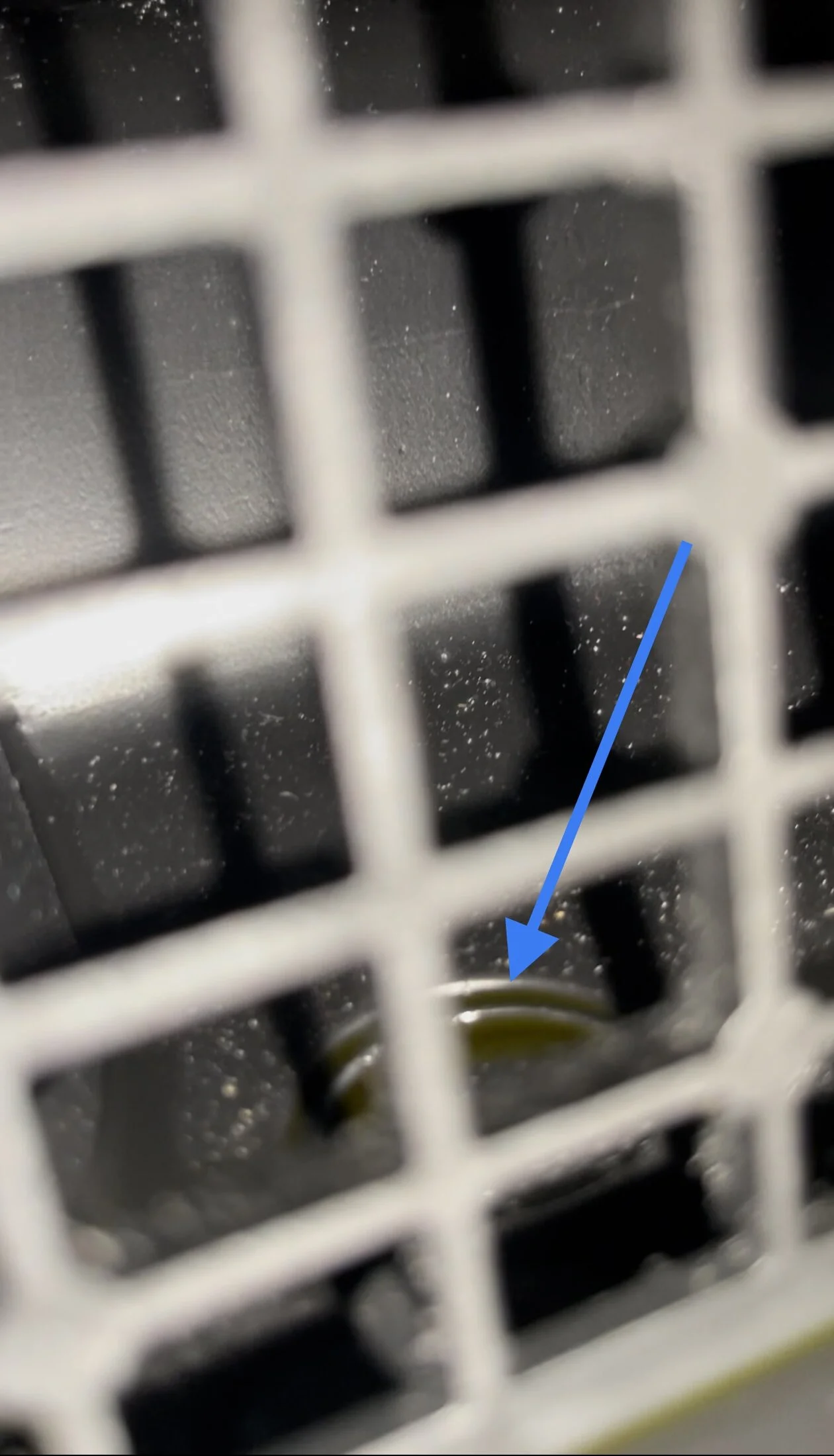

Does anyone know what this is?
Its leaking a yellow oily fluid into the Center Glove Box/ Cool Box
Seems to be coming from a hole behind the cooling vent
I dont know how long this has been happening
Freon (actually 134a) is colorless/odorless, but has oil added, but that yellow color looks like leak detection dye. It will probably glow very brightly if hit with a leak detector light.
Relatively sure you have a leak behind there, and that's not gonna be fun or easy to fix.
I think you may have an ac leak I would get that checked out asap it's not healthy to breathe that stuff in.
Does anyone have an idea how to fix this? Or what causes it to leak?
Is the refrigerant for the cooler box and the actual A/c system separate?
Or is it one whole system?
Because my main A/c front and rear seems to work normally.
PAG oil for the refrigerant in the A/C system
