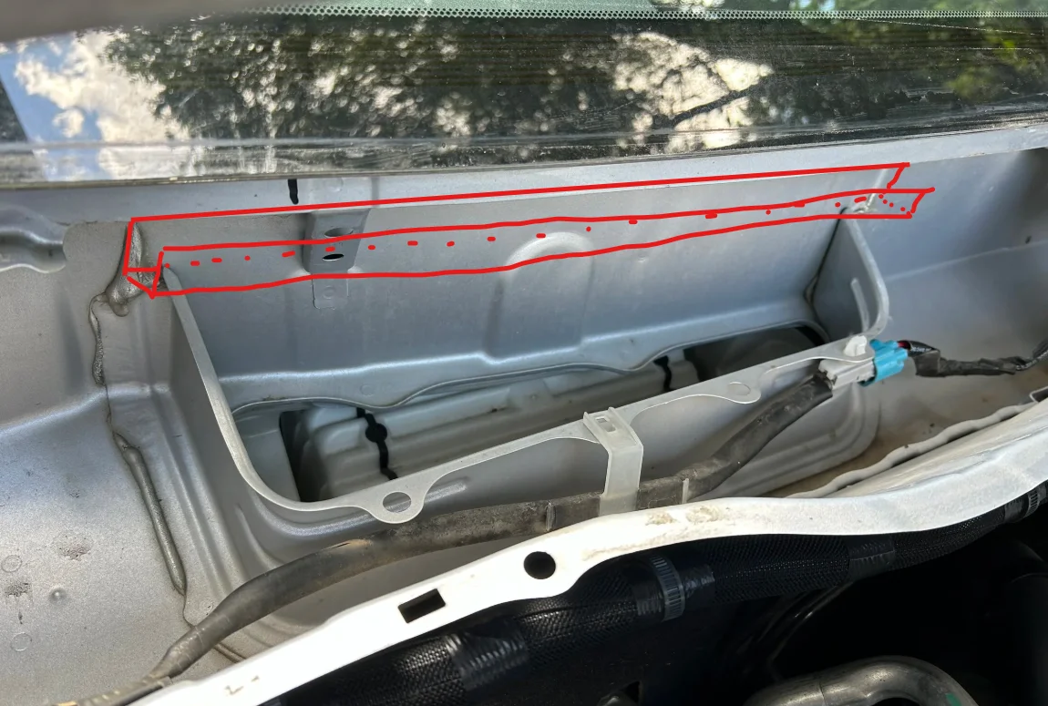

I’m wanting to replace mine. Had my screen replaced and the cowl was leaking. I put some plastic over the air intake and the flow is not great in the cabin. Going to remove the plastic and buy a new cowl, who’s got the best price?
Have you considered installing a U-shaped channel at the window to air intake edge, instead of a full cover to route any water bypassing the cowl seal sideways?
IMO it is worth having a secondary means to prevent water ingress as passenger side A-pillar has critical main harness electrical connectors you really never want to get wet.
Something like this, done with by "best" drawing skills in snippet... ;) Way to fit it and interference with cowl to be looked at of course.
