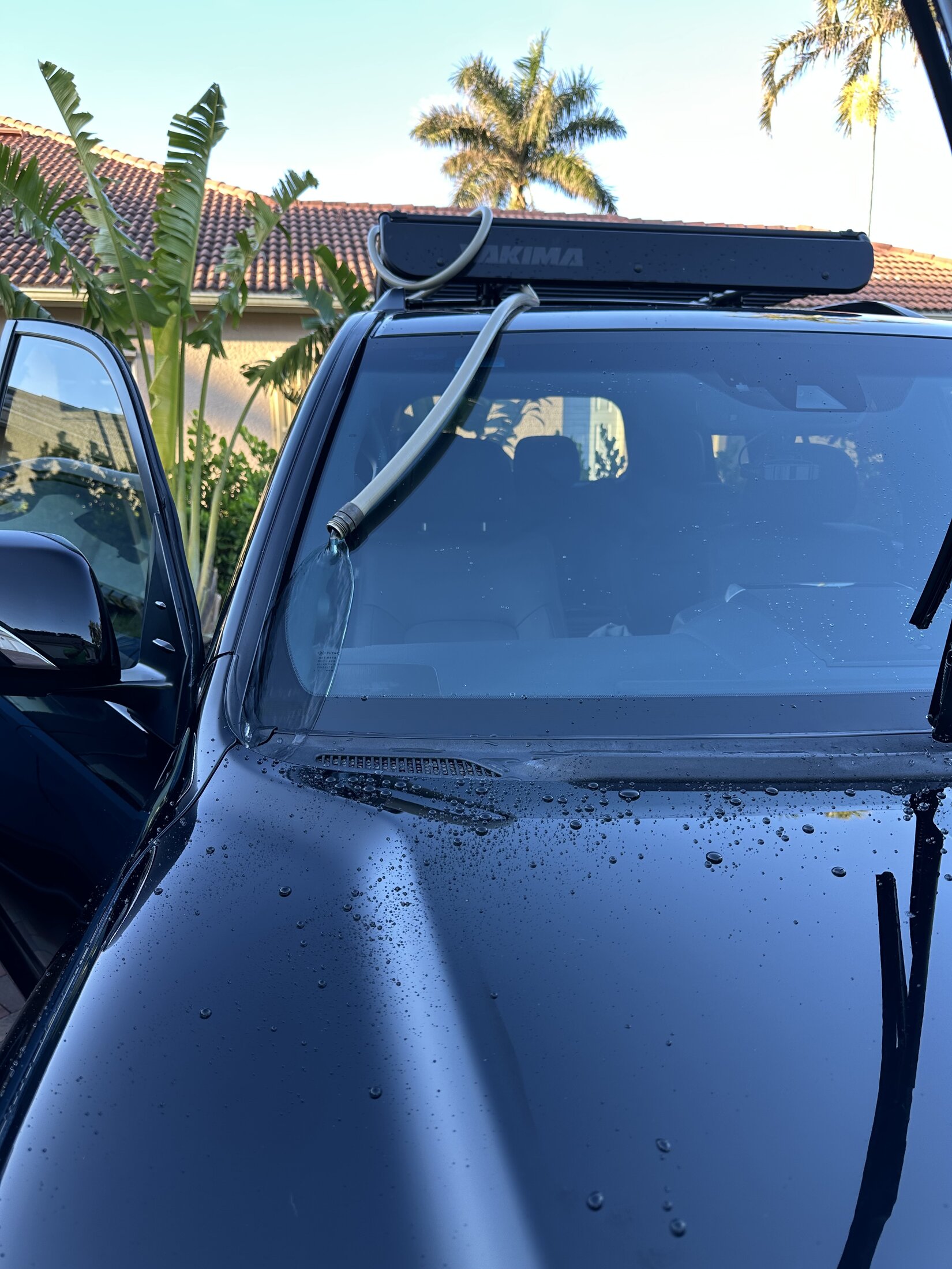

Well gang, I am officially a member of the leak club.
I spent some time with the hose today, I was able to rule out all other spots. The leak only happens when the water hits the lower passenger A pillar as shown in photo.
Drips to the left side of passenger floor mat, significantly if heavy rains. I guess I will have to pull the cowl and take a look. Searched some previous posts regarding leaks and apparently if it’s not the sunroof drains, it can be pretty daunting to diagnose.

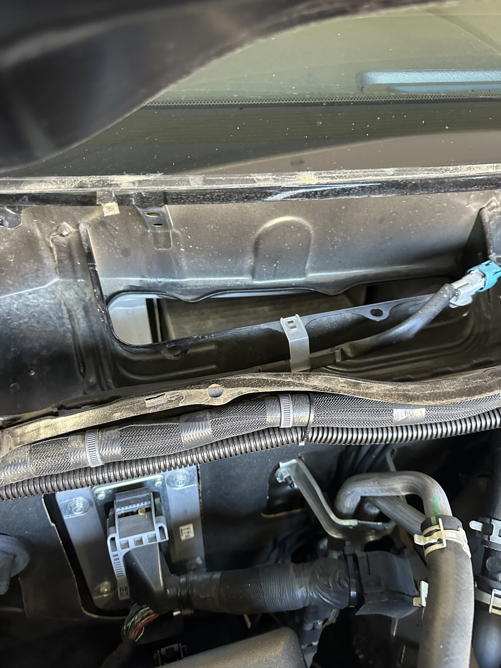

Ok, I got the cowl off, pretty straightforward.
I was hoping for an aha moment, but I don’t see anything that strikes me as a leak. This fresh air box area is completely dry as is the foam gasket surrounding it.
The foam gaskets on the cowl are all dry, dusty and pliable too. I am tempted to take the side plastic windshield trim off, but the white clips don’t seem to want to cooperate.

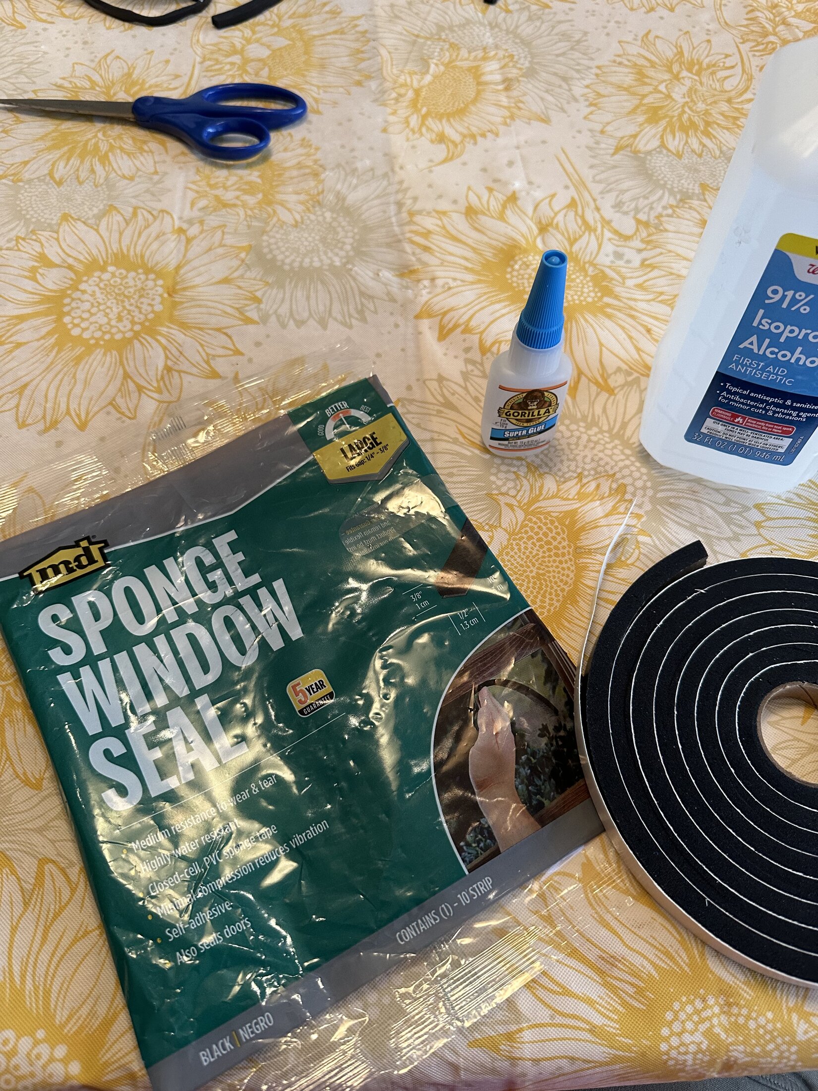

I read in another post that someone replaced the foam on the cowl seal with some success. I bought a very similar size and type of weatherstripping foam from Lowes and changed out the primary foam seal. After removing the original, I cleaned with alcohol and cotton ball, then used the smallest bead of gorilla glue before pressing the new seal on.
The secondary seal and little butt seals I dressed with dielectric grease. Not so much as to make a mess, just a little to soften them.
Success. The leak is gone.
Here are some pictures of the seal.
Also note, the original cowl seal, on top, is open foam, my replacement, on bottom, is closed cell.
