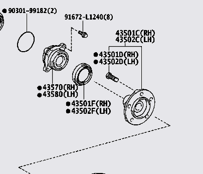

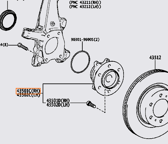

Wheel hubs however are quite different. The bolt pattern on the 200/570 is more square, the 300/600 is very rectangle.
200/570
300/600
Honestly, it would be far easier to modify the 200/570 wheel hub to have 6 lug imo. Same for the rear axle.

I tried looking that up. I'm not seeing a part for the individual flange yet on the 300/600. We have them in-stock for the 200/570 so once we get the 300/600 we can easily verify. There are some unit bearing/hub/flange assemblies in the Jaos spare bins but they too are loaded for Mexico.
200/570
300/600
