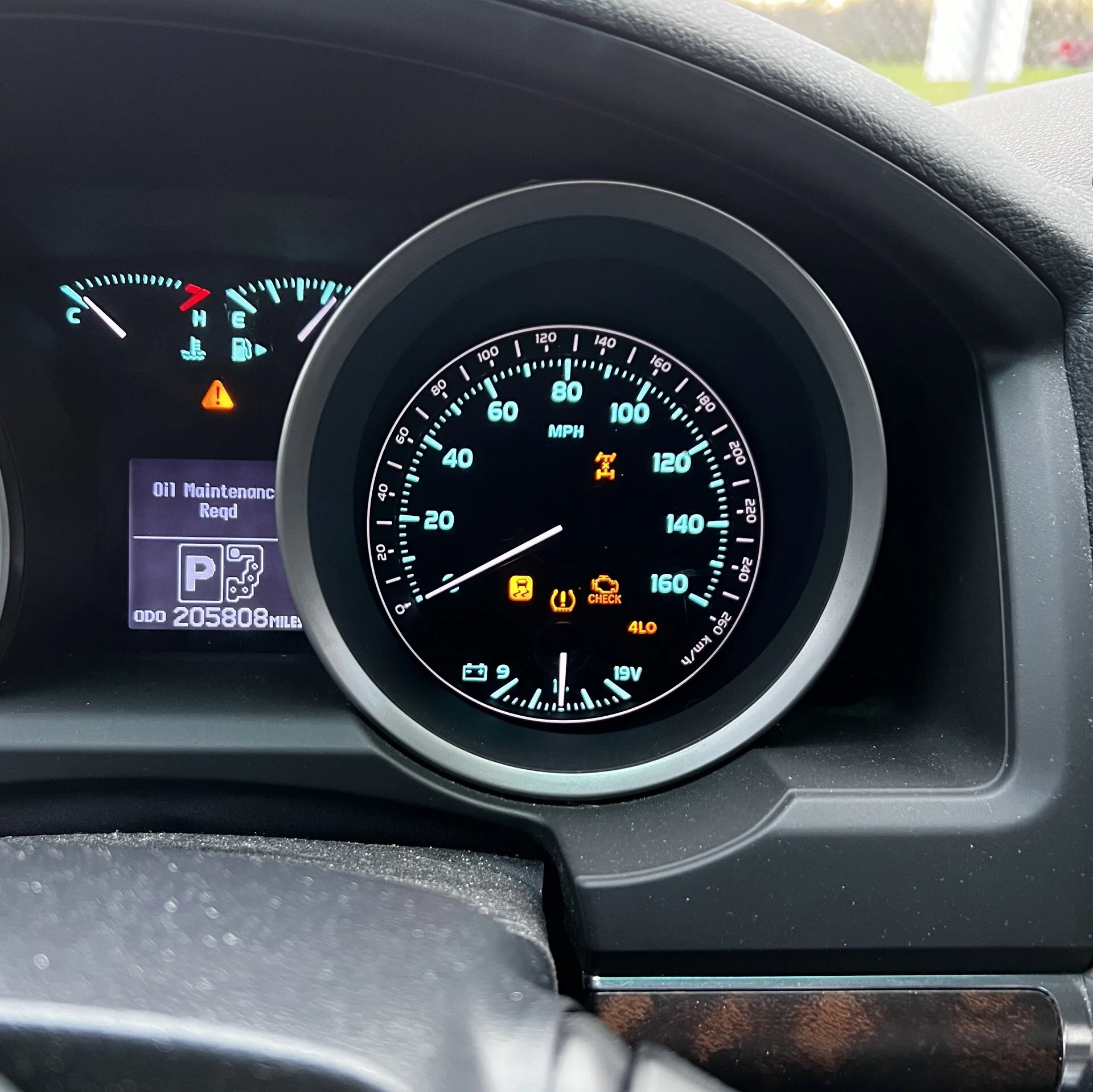

I know there are several similar threads on this topic already. Just adding another data point to the discussion so I can follow along.
2010 LC, 205k miles.
The problem first appeared when my wife and daughter were driving it several months ago, and it happened to me the first time today. The only recent work was a couple of tire repairs this year and the tire pressure light has been on since the last repair about a month ago. All sensors and systems are original, never had any work done on them. I'll try the OBD scanner this weekend and see what's behind the curtain (and change the oil since it appears to be that time of month as well).
This happened today when I had a full car with coworkers going to lunch, right after I bragged about how much I loved this car. I restarted a couple times to see if it would go away and it did not. It was still on after work, and stayed on for my whole 75 mile commute home. The transfer case lock light is on because I was just pressing buttons in the parking lot to see if anything changed. Tcase still locks and unlocks, so that's good.
