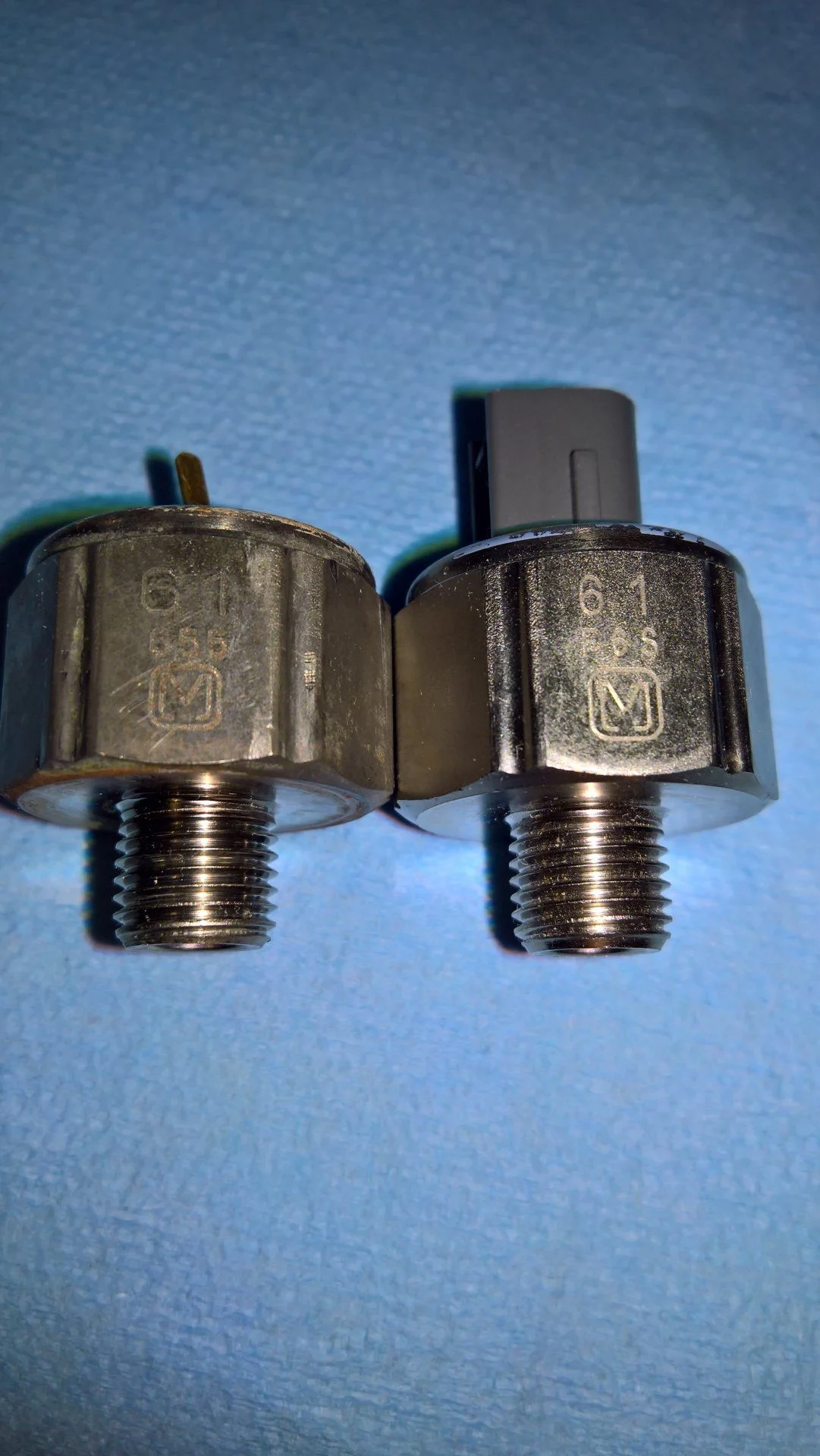

O'Reillys sells a Made in Japan knock sensor for around $40. They are virtually identical to the OEM part, exact same markings. It's from O'Reillys Import Direct Line of parts (#17-0744 for 89615-30050). I installed one last year, no issues.
See photo below: used OEM on the left, new O'Reillys part on the right:
See photo below: OEM on the left, O'Reillys on the right:
thanks!! ordered a set. Even got 10% off.
Let us know when they come in if they're still the Made in Japan part.

I should have the knock sensors tuesday from O'R and I'll report back what if they're the Japanese versions.
