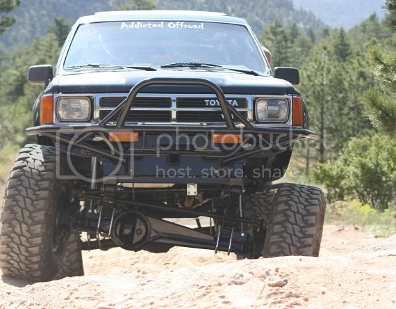

Does anybody have a picture of a 100 series LC with a tube bumper like the one shown on the 4runner below? I was planning to do something different with my LC cos I see a lot of people running TJM and ARB bumpers on their's. I wanted to have a tube bumber with a winch mount. I was also wondering how come nobody has a 100 series with wider tires? I always see tall but slim tires on LC's. I'm planning to run 35" tires and get SOR fender flares. Can you run rims with less backspacing on a LC so it has a wider stance? I was just wondering cos I haven't seen it done yet. Also, are there any taller lifts out there for 100 series with IFS? All I see are the 2" OME lifts. Are there any body lifts out there for 100 series LC's?

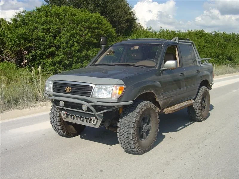

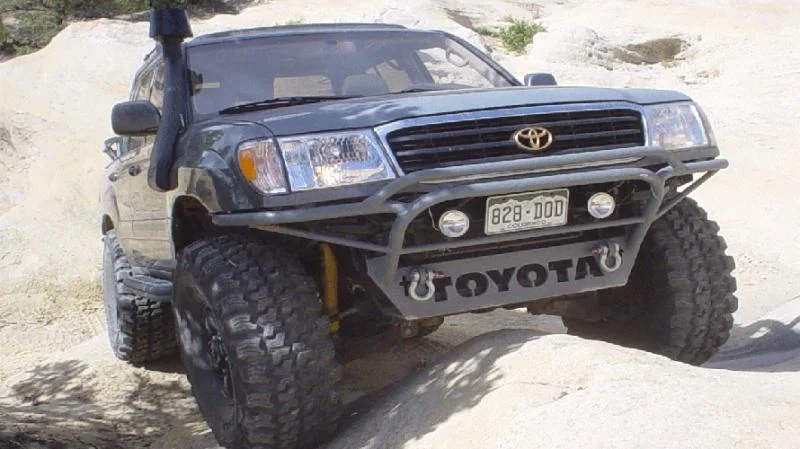

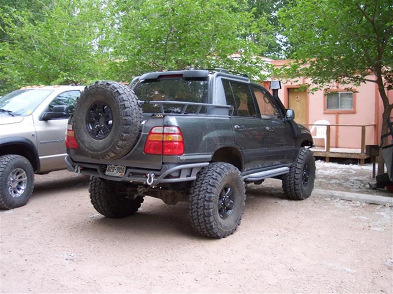

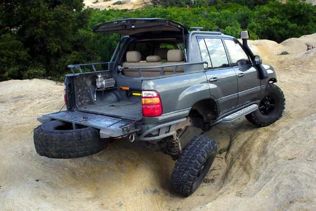

Alan Podvin did built this rig years ago. This pic is a little stretched out but Podvins truck had 2" of suspension lift and somewhere between 2-4" of body lift. I can't remember. Wheels are 37 or 38x13.5. Also, the wiper washer reservoir has been removed/relocated. Probably some firewall modifications but I don't know for sure.
do you know if he made that bumper on his own? or did he buy it aftermarket?

This is Alan's website/company. Not everyone's cup of tea but he doesn't cater to the mainstream. Yes, he has the ability to fab a bumper. ;) Search Podvin for more info.
