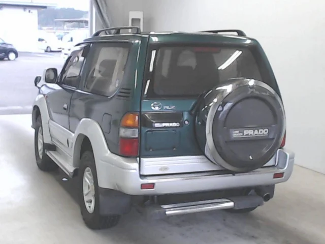

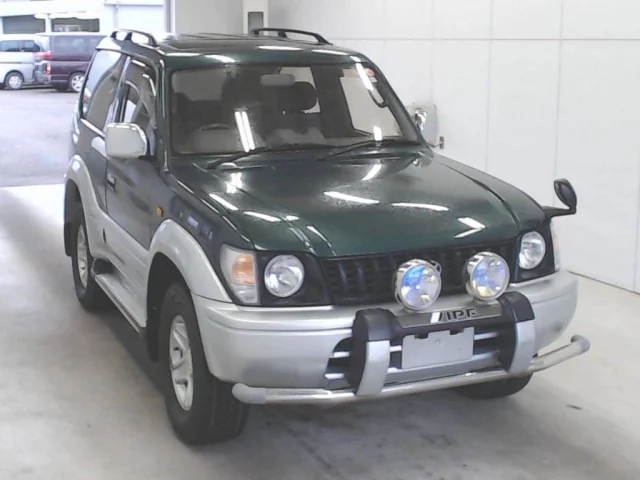

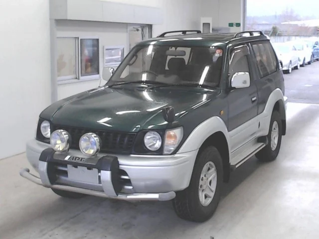

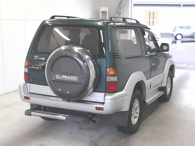

After losing about a dozen auctions, I saw this 90. It's a 1996 3-door in RZ trim (which I believe is the highest tier on the 3-door), with a 1KZ-TE and 190k km on the clock. I had initially wanted a manual, but I thought an auto would be a little easier on my first RHD car- one fewer thing to think about doing backwards. The first round, the auction failed to meet reserve. Dylan was able to find out what the reserve was, and I waited for it to come back up and bid to win the second time. Won the auction January 13 for 829,000 yen - higher than I initially budgeted, but this one was clean and the 3-doors seem to be a little pricier than the 5-doors.
