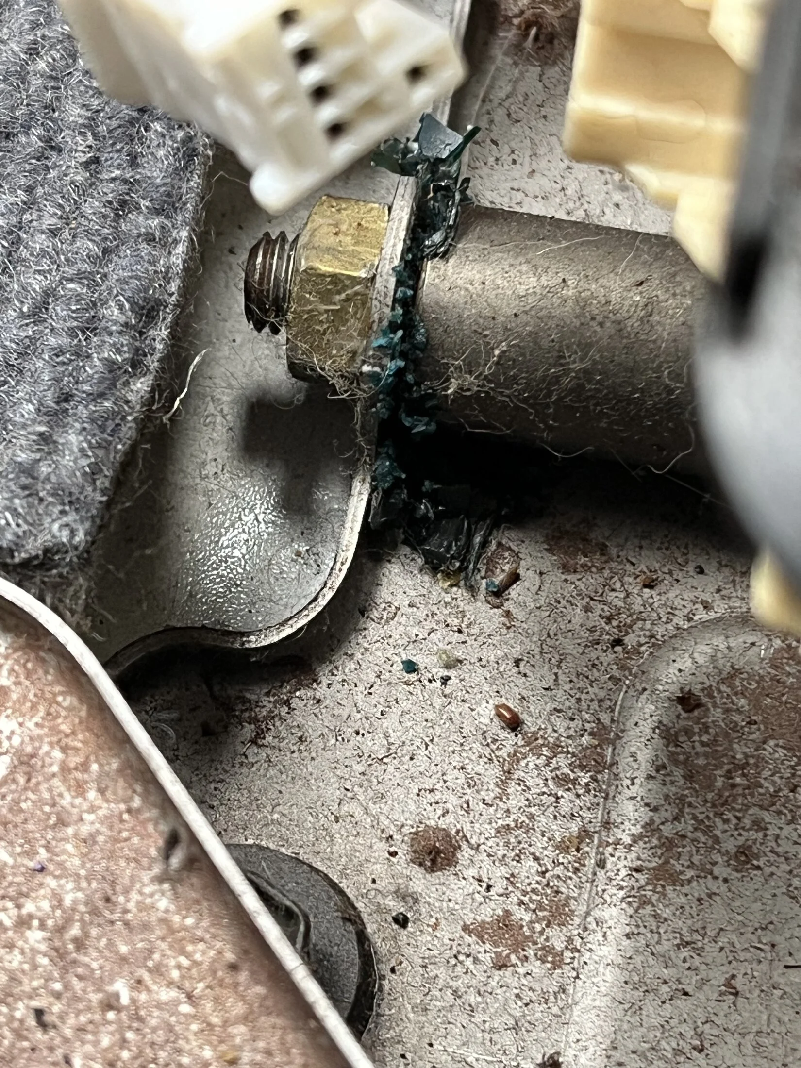

The cause: the bushings at the bottom of the shifter had throughly deteriorated, basically nothing left. Allowing for a lot of play in the motion of the shifter.
The fix: obviously replace the bushing, which I’ll be detailing how to do in the following pictures in this thread.

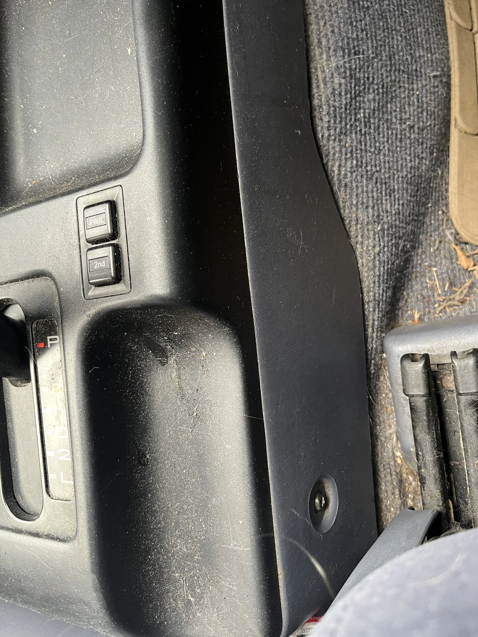

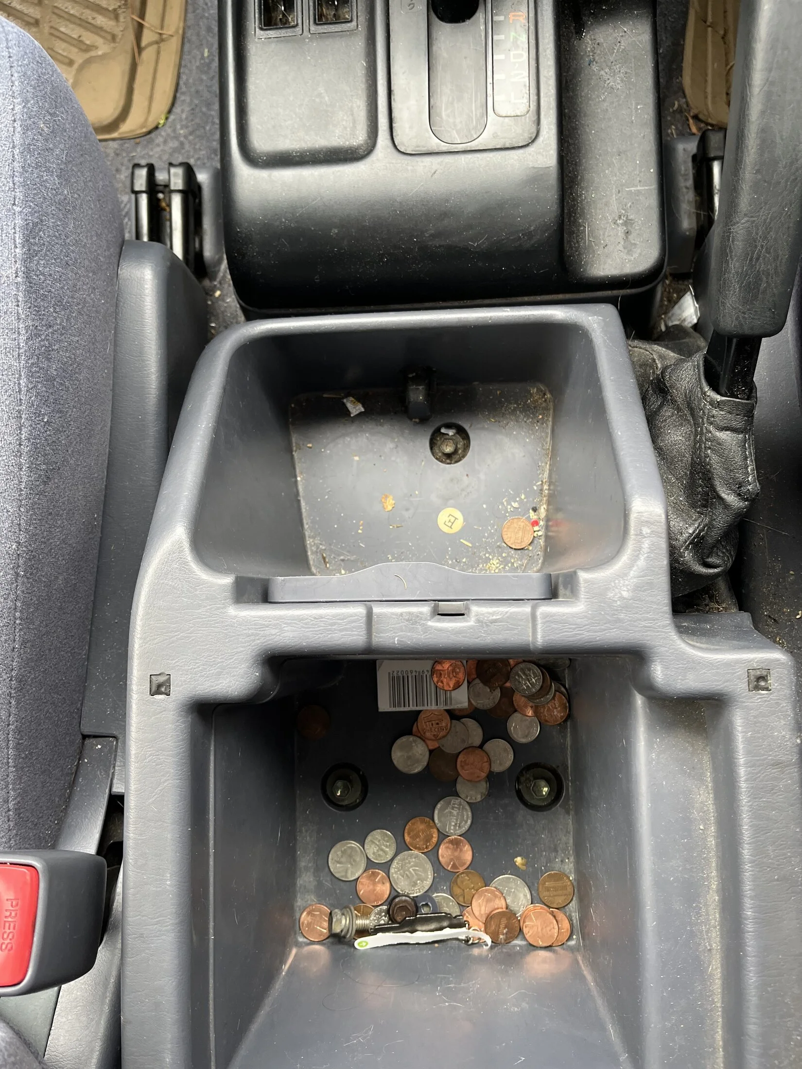

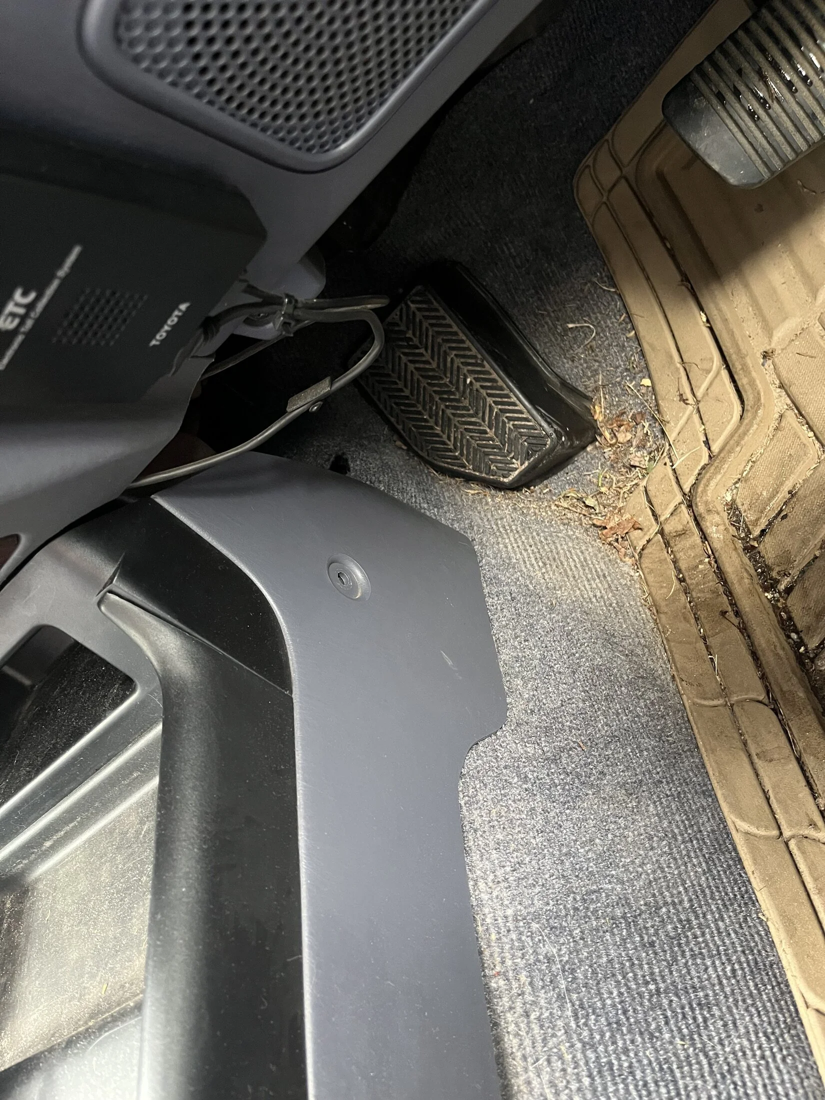

You’ll need to start by removing the two screws and two plastic clip inserts on the side of the center column, then the three bolts that go through the center consul, the center console also has 6 small screws on the sides ( I didn’t remove those 6 screws, however that could mean that I ripped the screws out of the plastic. Tbh I’m not sure if they hold the consul in place, or are just for the AC/heat mechanism inside it.)
Once those are removed you will need to slight tip the center consul backwards because it overlaps and hooks the column down, you can twist off the transfer case shifter and unscrew the two small screws on the front of the trans shifter
You should now be able to tilt the column upwards, and you’ll most likely want to slightly lift and twist your trans shifter handle 90 degrees so that I can fit through the hole in the column more easily. Note that when you lift it, the button is spring loaded and will want to fly out, it very easy to reinstall however.

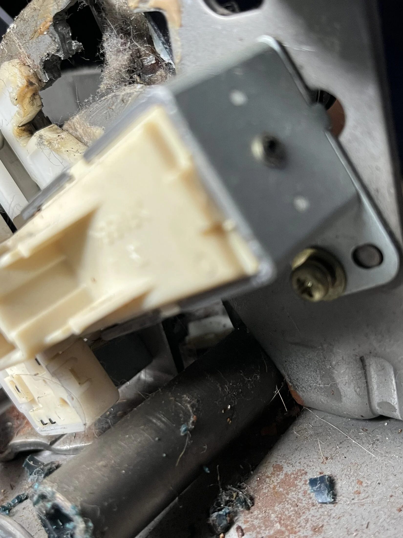

After that you can unscrew thee brass screws that hold down your shifter position indicator PRNDL and on the passenger side (RHD) there is a little white platic box with two smaller brass screws in it, this also needs to be unscrewed and placed aside.

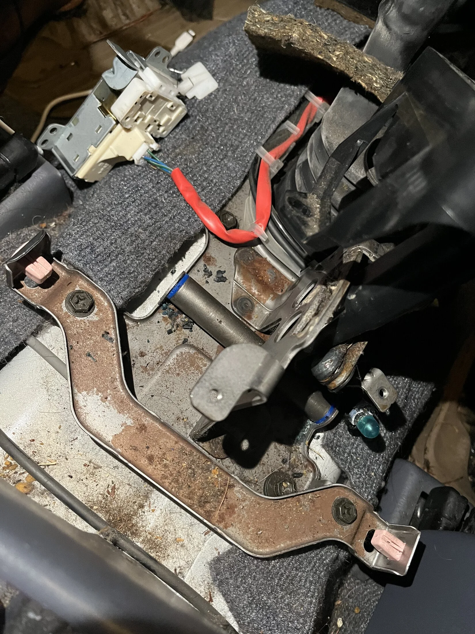

Then you can unbolt the main pivot bolt that’s at the base of the shifter. The bolt head is a 14mm and the nut is a 13mm. At the ends of this pivot tube are the bushings that I’m replacing (the blue crumbly stuff is what’s left of mine lol)

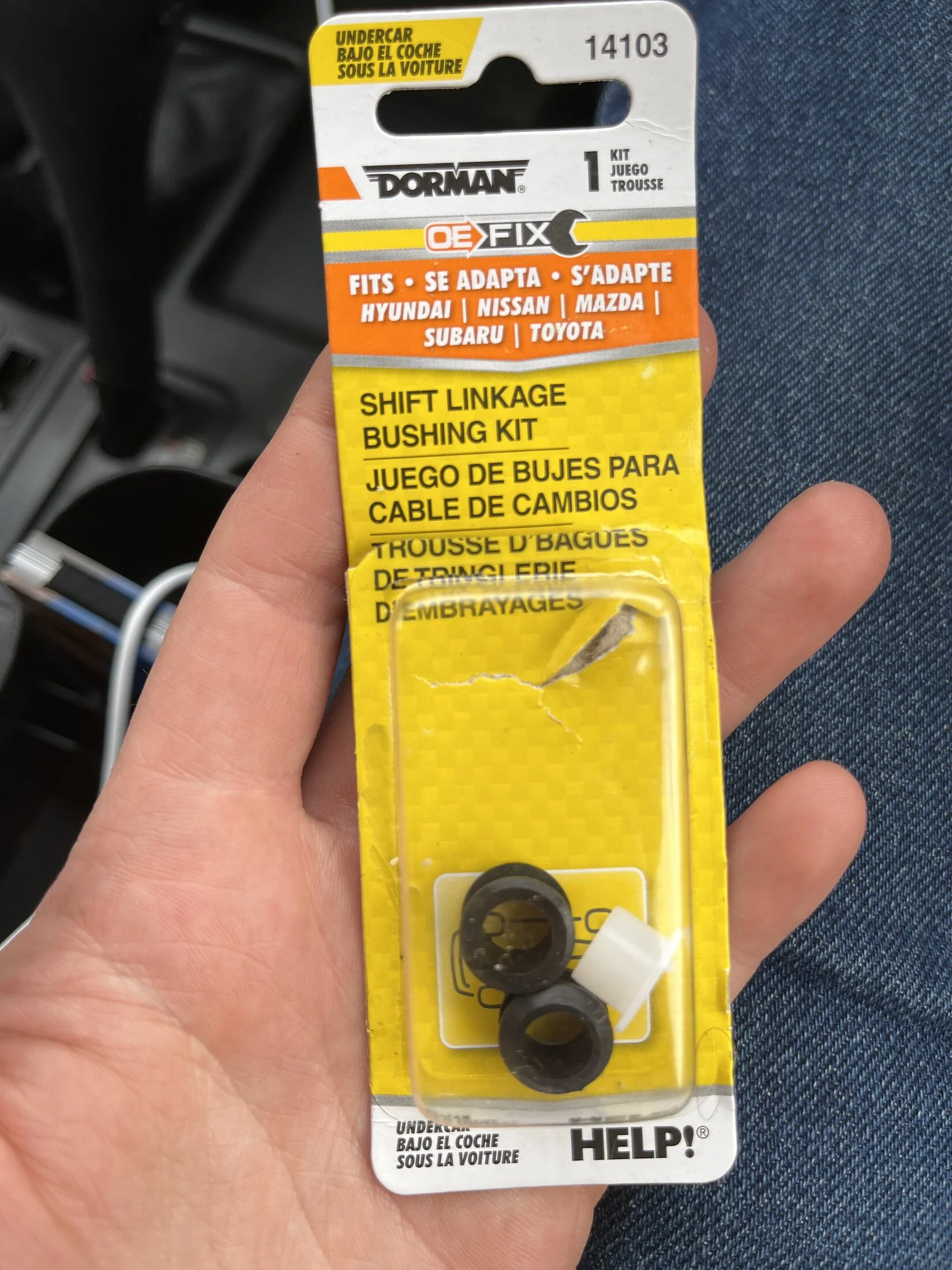

pictured is the set I used to replace these bushings, you have to buy two packs, but I got these at autozone. Otherwise you can order sets from plenty of toyota parts dealers.
The new bright blue are the bushings in place
The other picture is a peg that sticks out of the left side of the shifter, it needs to be in the position I have shown in order for things to work properly and for the bolt to be reinstalled into the shifter tube. I state this because you with have to move it out of place in order to get the new bushings into the tube. (I recommend having the shifter in neutral for all of this btw.) this little pin has a spring that pushes it up, the button at the top is what pushes it down, you may need to push it down to get it back in place.

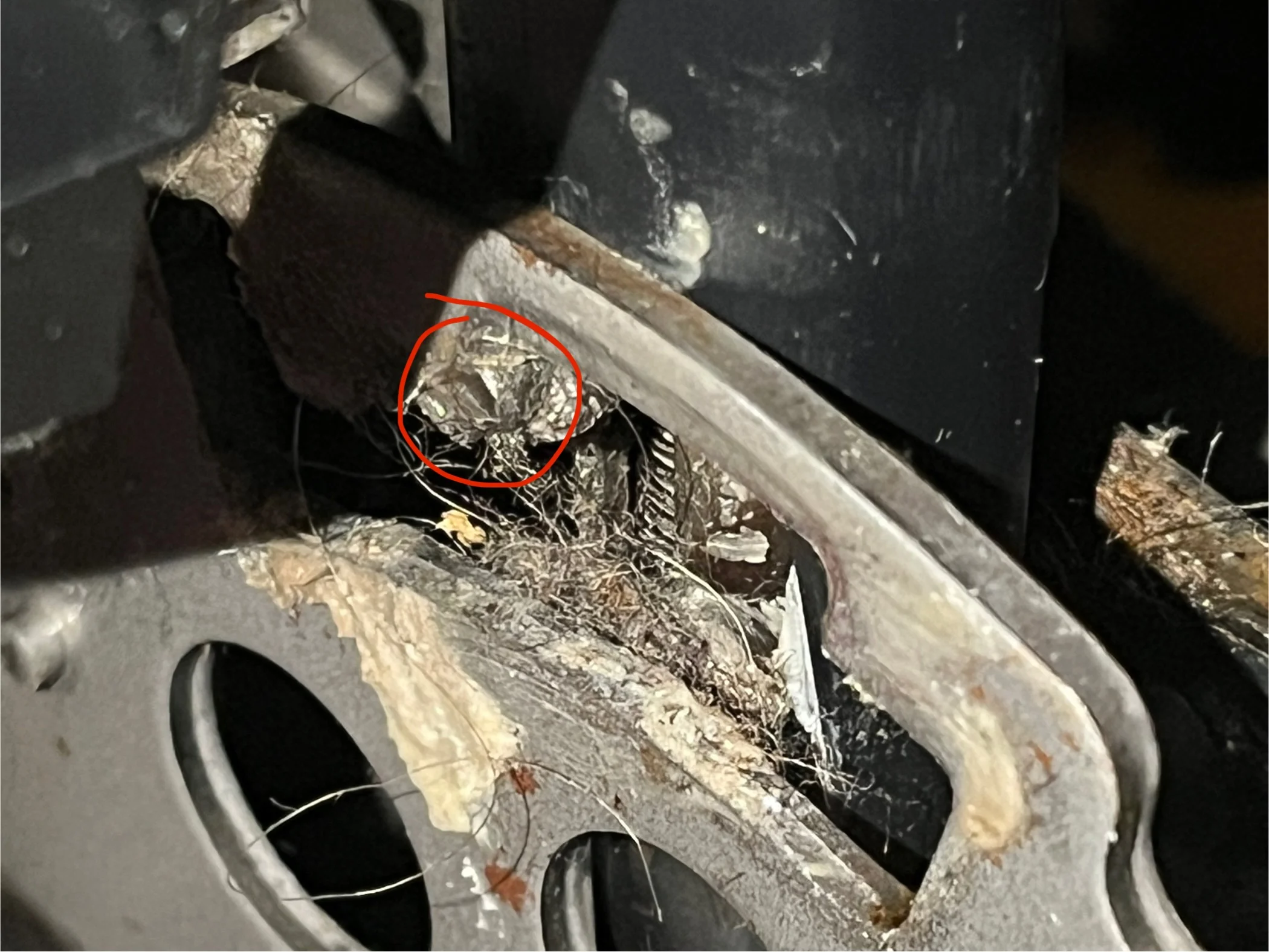

Did this today! Replaced all four with factory bushings, 90385-11003. Found some unused electrical connectors on my TZ with the 5VZ-FE. Lockers? Seat heater controls?
There was not much residue from the worn bushings in the tubes. It was mostly underneath. I ended up removing all the 10mm bolts on the edge of the stamped steel sheet and then removed the 4 metal sleeves and rubber grommets closest to the firewall to access the front pivot and its bushings. Cleaned the tubes with a nylon brush and silicone spray.
