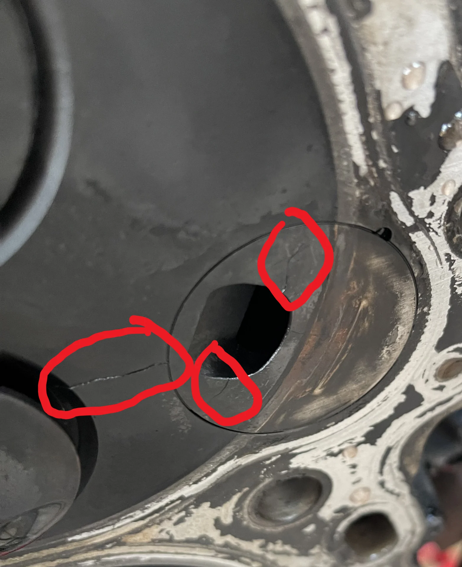

Well tried bleeding again, overflow was puffing consistently and smeed like exhaust still. Pulled the head, crack confirmed...
Good news is the AMC head from spain should be on my doorstep tomorrow. Once the gaskets get here I can start putting her back together...
