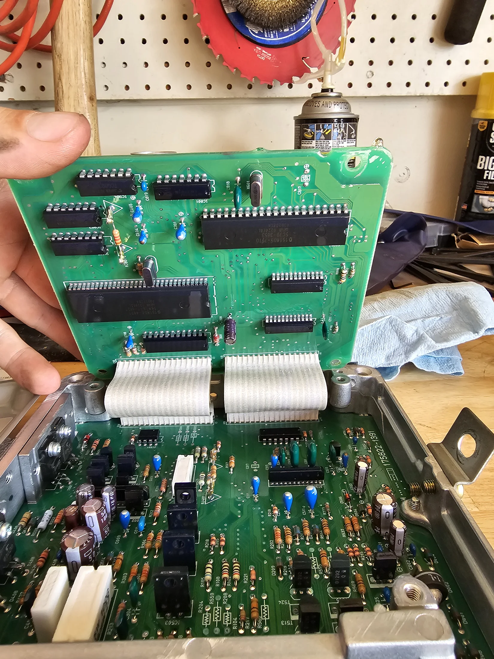

•Cracked open the trans ECU. Nothing leaking and no melted terminals/connections. It had been replaced before, as it was a Dorman branded ECU

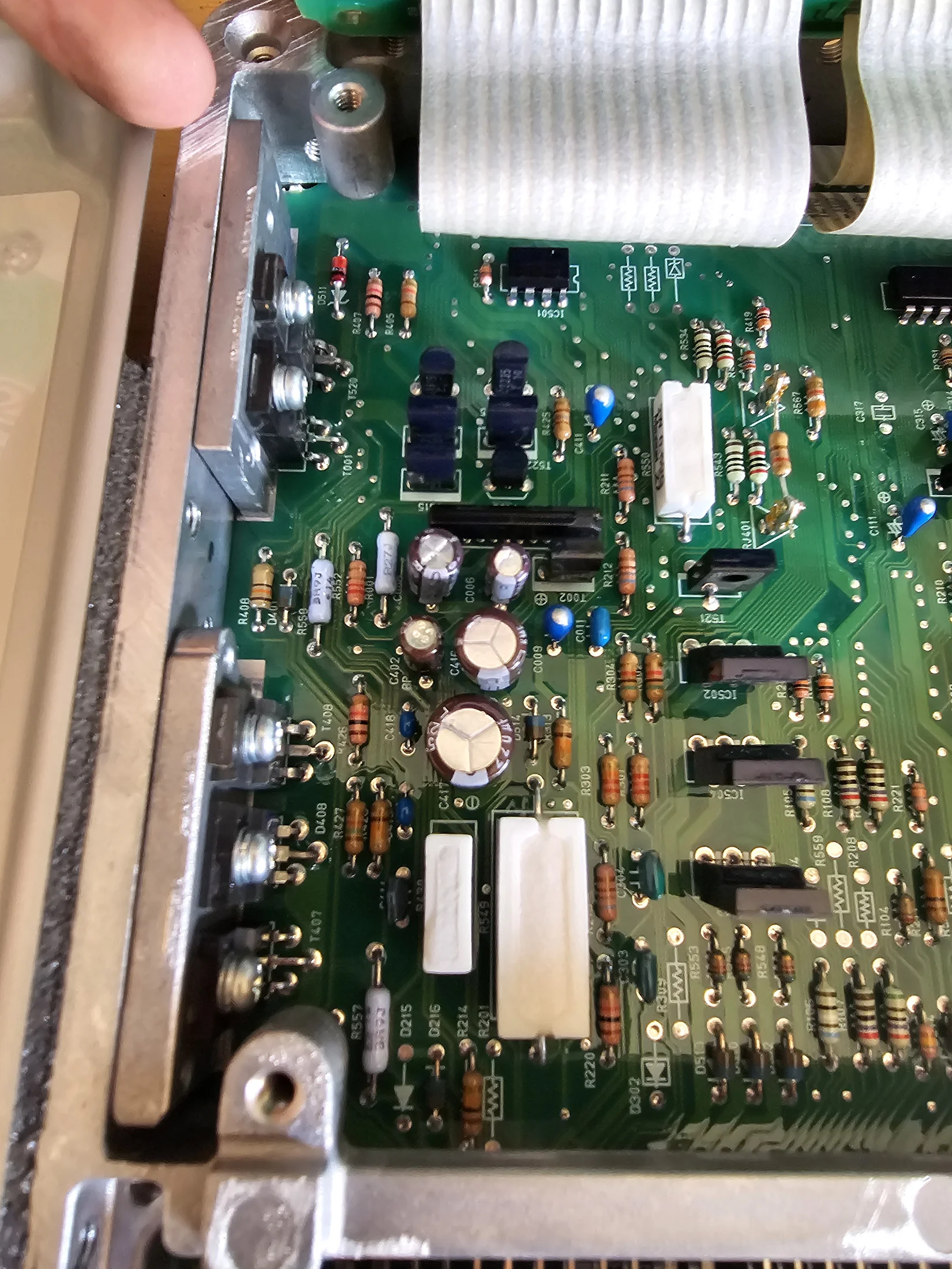

Engine ECU can have leaking capacitors and cause weird transmission issues. Do some searching. There are some techs who can repair the damage on these. It's more than just capacitors, as usually traces on the PCB need to be reconstructed.
Hey guys, this post is about my KZJ78, OP is a good friend.
I've taken a look at the ECU and it's in perfect condition. Not saying it's not broken, just that it looks good.
