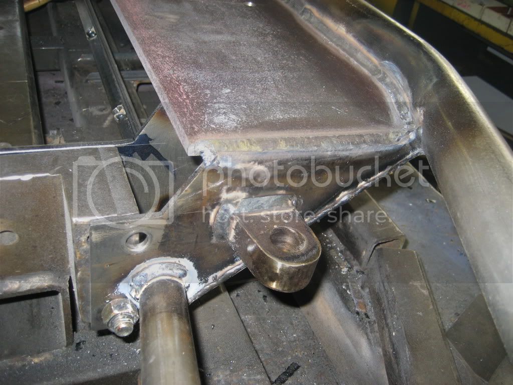

Kumars new Sliders!
of? :flipoff2:
Those sliders, as well as everything we build, is all welded with flux core.
OK, OK, not your garden variety flux core. It's called Tri-7 and is a special form of flux core you use with gas.
It gives penetration unlike anything I've ever used and the welds kind of flow, like a braze, rather than the normal stack-of-dimes.
The flux in the wire makes for a super clean weld, with no impurities from the steel.
Those are some purdy welds.

Roxstar, is that Flux Core you use from Hobart Brothers? It seems that I have a few welding supply houses here that stock it.
The stuff I use is made by Tri-Mark. It's pricy and might be overkill for this stuff but hey, overkill works. :cool:
One earlier comment I wanted to address was the use of 4X3 tubing.
The main reason I went with this size is the frame mounting arms.
3" tall tube allowed me to tuck it under the pinch seam and still use 2X2 for my frame mounts.
I feel anything less than 2"X 2"X 1/4" for the mounting arms would seriously compromise strength.
I have to admit, when I first looked at the tube on the bench it looked huge. However, when it was placed under the truck the size looked just right.

Do you mean "tuck it" on the outside of the pinch weld to get it close to the rocker?
2x2x.250 are the heaviest duty slider mounting arms ive ever heard of. Mine are 1.75x.120 DOM round tube. BTW, what do these weigh?
Exactly
Are we talking about the same arms?
I mean the arm that runs from the frame mount to the slider.
These have to support half the weight of a +6000# truck with up to a 14" lever arm.
I may tend to error on the side of overbuilding but I wouldn't consider using anything less.
With .120" wall, I have no doubt your sliders are being pushed up into the body sill panel.
Yuppers, they have touched, never damaged though due to the huge amount of weight distribution, and the strength of the body in that area. Ive missed the brake pedal before and literally free fallen 3ft onto the slider in rocks (hurt, and my dog ate the dash from the back seat :lol: )
Im not attacking your design...I like over kill... But, Ill bet money that these sliders will also contact the rocker on the 80, it wont damage the rocker, but if it ever does get wheeled hard it'll hit.
