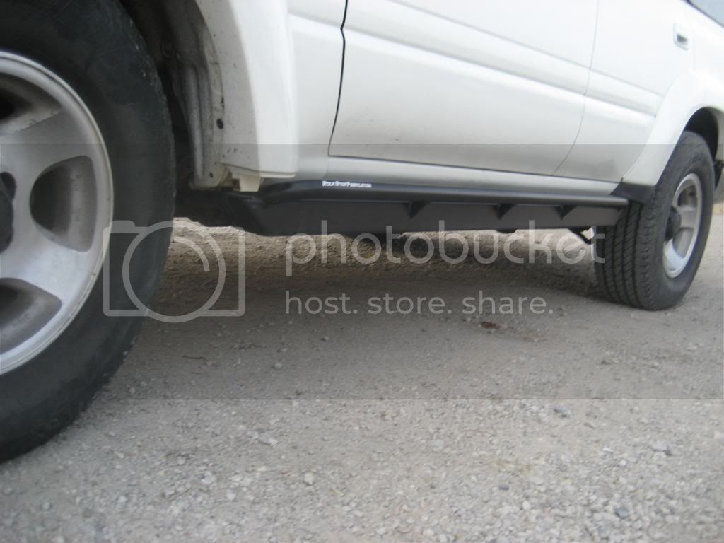

As you can see from the original post, the 2x2 mounts are welded at the very bottom of the slider. When mounted, they just barely make contact with the 1" pinch seam and the main tubes fit up against the body sill.
That means the sliders hang down 2" below the pinch seam, right?
In a previous post you said your sliders have 1.75" mounts.
Assuming your mounts also have to cross the pinch seam, that would indicate that your sliders hang down 1.75" below the pinch seam, right?
IOW, your 2" tubes and Arjun's 3" tubes end up with almost the same ground clearance.
As far as ground clearance goes, the limiting factor is the pinch seam and the mounts that cross it, not the main tube.
Needing (in my opinion) 2x2 mounts is the reason we decided on 3x4 tubing in the first place.

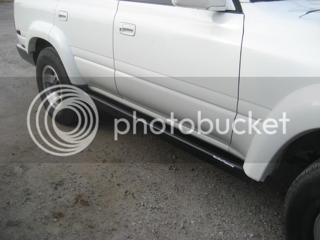

Ummmm I was joking about Arjun high centering already, not about your sliders.....But since you bring it up... I do think it does hang down a tad too far especially for a vehicle that is already "break-over challenged" due to its wheel base and high body profile. Sure its only about an inch lower than normal, to some thats a big deal to others it doesnt matter. I dont really think it matters for kumar.
I will say they are some of the cleanest looking sliders ive seen.
Oh and I notch those body seams. And real men just cut out the whole rocker and build the slider into the void. :grinpimp:
