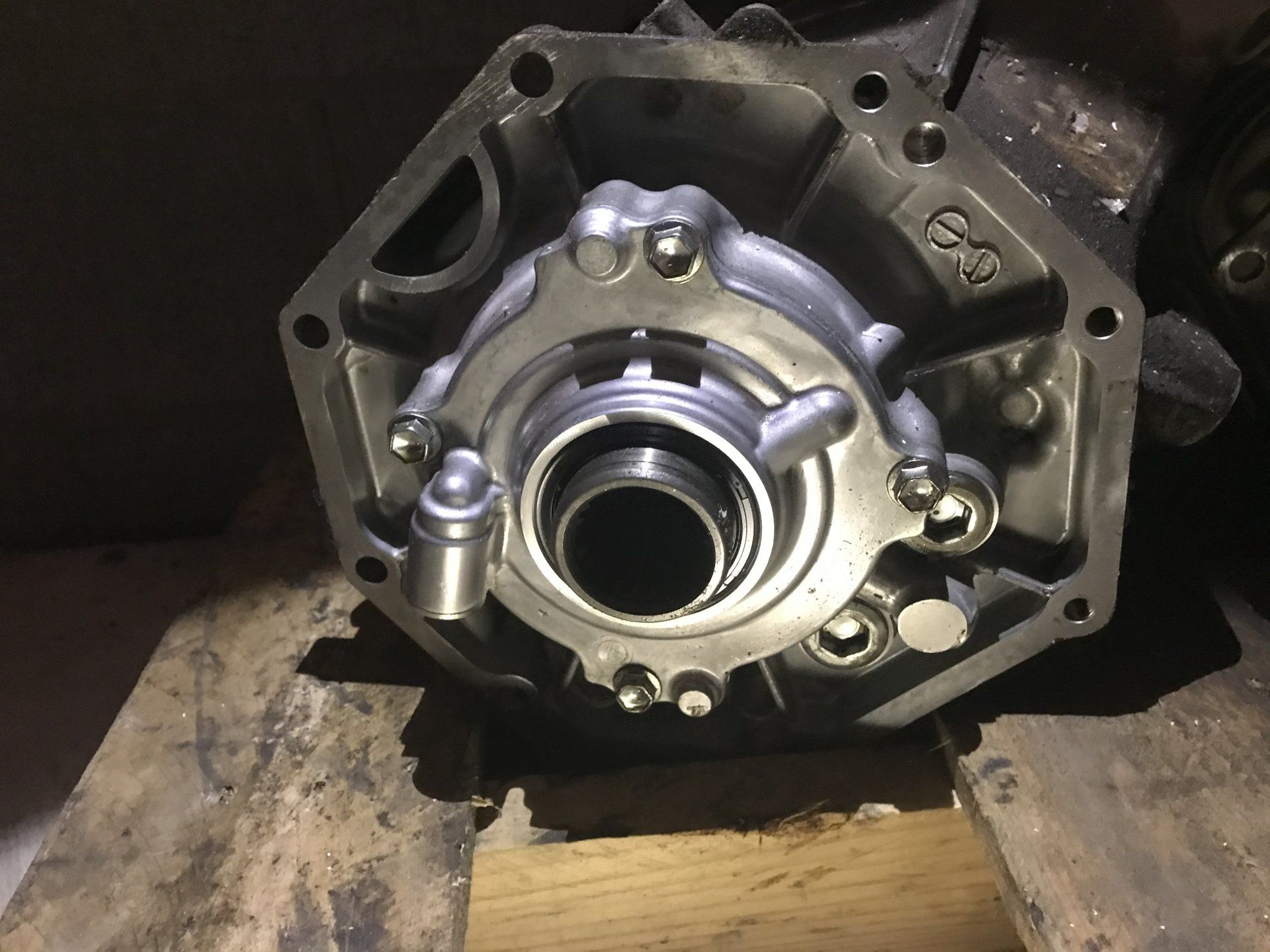

Potentially crazy idea: drill a small hole into that area and tap it for a drain screw/plug. Remove that plug periodically to check for this issue.
I haven’t had a look at mine (let alone pictures of the inside) to see if this is feasible.. but as some of us accrue mileage I wonder whether more will start to have problems like this.
Here’s a picture of the inside I just took for ya. Side note... I couldn’t let the shop just toss the original case so I took it home but I have no plans for it. If anyone wants it or wants the electronics on the back they’re yours for free. I’d ship anything small but for the whole thing you’d have to come get it here in Chelsea, MI.
