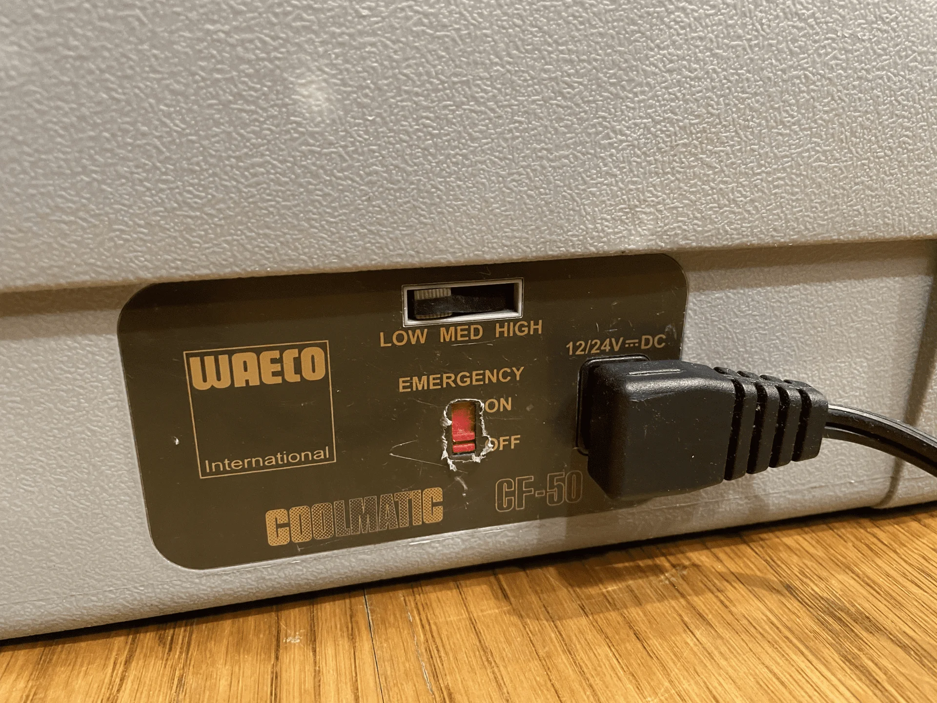

My CF-50. Positive side is closest to the floor... and it is the side of the cord that has markings. But my pins are rectangle, not round so perhaps not helpful.
thanks very much for taking the time! Looks a bit different. My plug is "horizontal" (meaning the pins are at the same height over the floor) with the little nub on the lower side. Looks like yours is "vertical". But the relative orientation may still be similar. Is there a little nub in yours and is it to the right or left ? Thanks.
great, I can see it! thanks for taking the pic! One good bit of data.
In case anybody has a similar question in the distant future, however unlikely, I should finish this thread off by saying what I found (by trial and error IOW sheer luck admittedly, no clever analysis here):
looking at the fridge side (not the cord), the female receptacle (with male pins) is horizontal with the little nub on the bottom, well the + side is on the LHS! (which I think is the same relatively speaking as with Hoser's fridge above, too)
