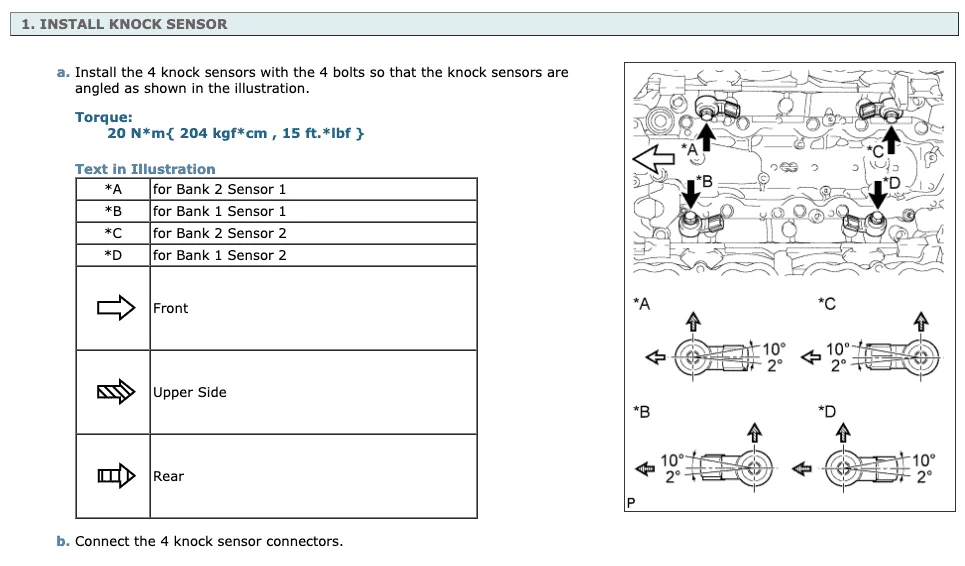

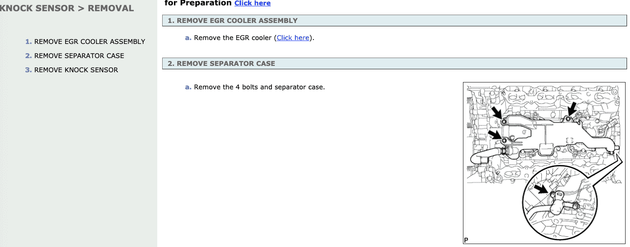

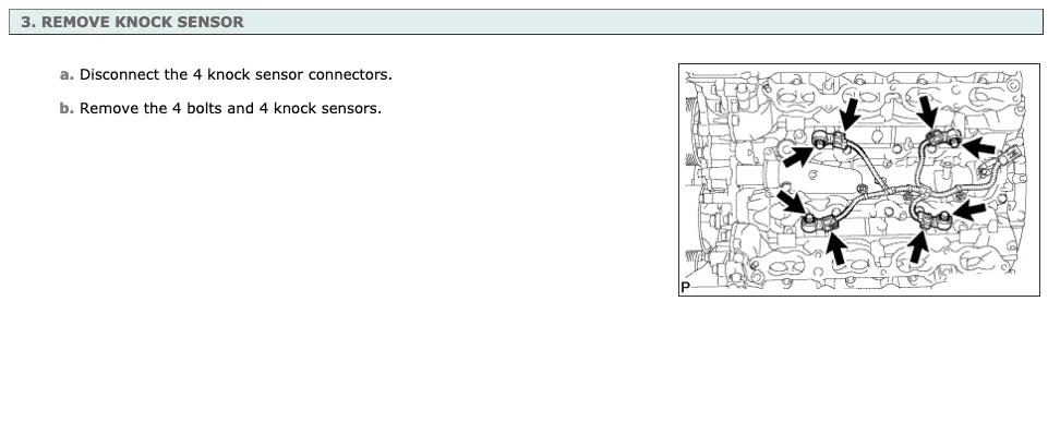

Got the FU light on my GX this morning. The code reads P0333 Knock Sensor 2 Circuit High Bank 2. Does anyone know an estimate cost for the dealer to fix this? I know the sensors are located under the manifold. I am debating on trying to tackle this myself.
I don't know on cost... actually first report I remember of a knock sensor going bad but look easy to replace. There are 4.
