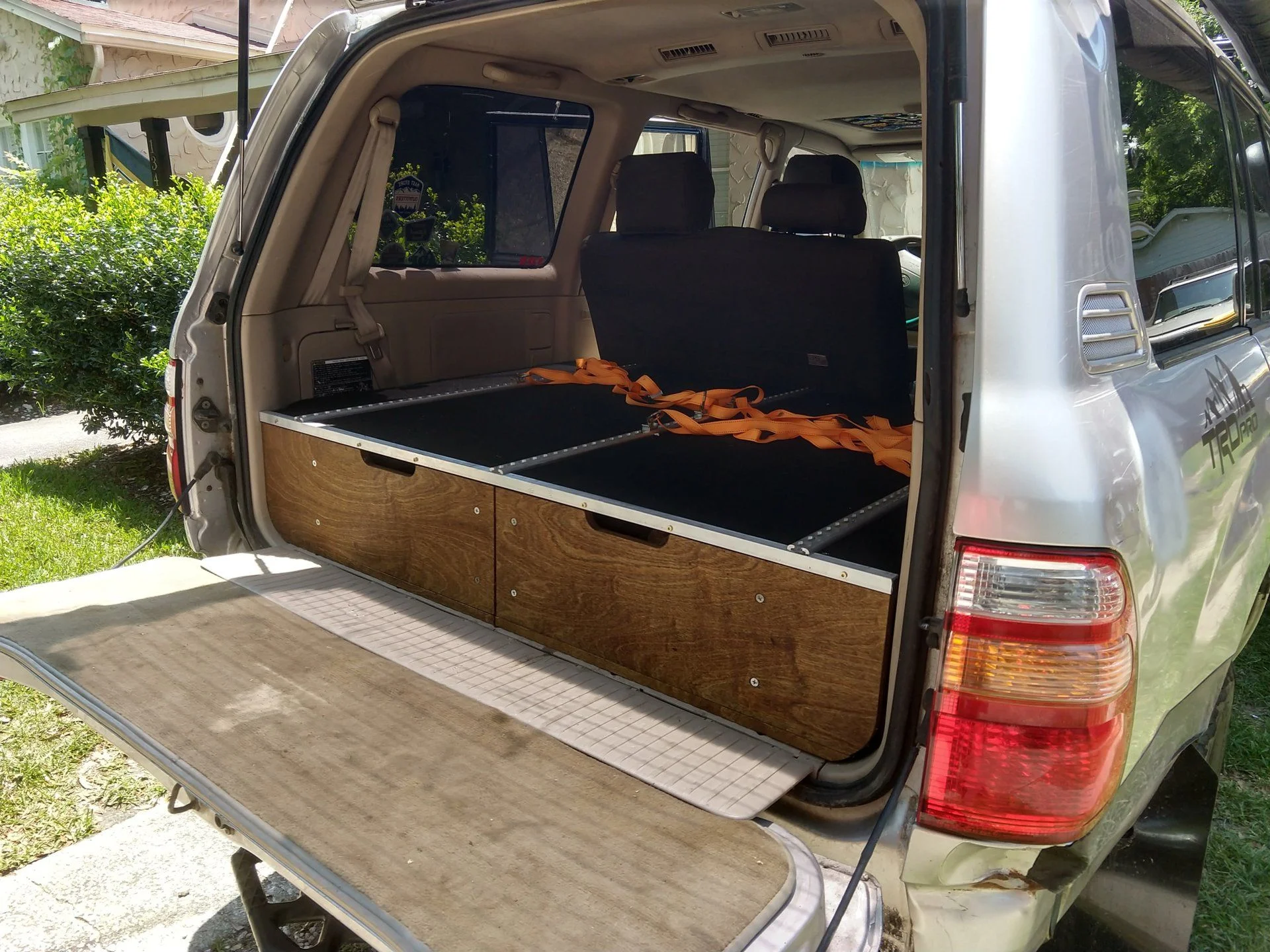

I just used the short wood screws that came with the Ltrack. I bought the kit so they we're included. Short enough to not go through and I just made sure I oriented the holes away from the Allen bolts of the drawer system
They sit perfectly flush with the pre drilled holes in the L track

I had considered drilling down through the slotted channel and through bolting. Wood screws seem way easier, so you feel that the wood screws provide a strong enough bite/connection to hold what ever you have tied down should there be a sudden shift- stop-accident?
Thanks- do you have a link?
Absolutely feel they are sturdy enough. There are like 10 on each L track
Not to say it won't work, but I personally don't trust wood screws to hold the aviation track down if anything significant is strapped to it. I think I'd run through-bolts if space permitted, or T-nuts and short bolts if space isn't as friendly.

Make sure the tnut dimensions match the slotted profile dimensions, as there are a whole lot of different types of aluminum extrusions with varying dimensions!
The T nuts I linked simply go in the bottom side of the plywood top. Run your bolt/screw from the top through the track, through the plywood and into the nut. As long as you select the proper length bolt, everything is flush on the bottom side of the wood top.
They are not the type of nut that fits inside the extrusion, and are therefore not limited only to locations where the extruded frame is.

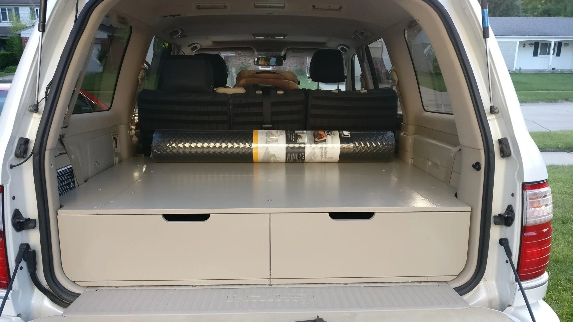

Mine are done, finally. Here is iteration one, already thinking about mods after the first successful weekend testing it out.
I called/emailed several paint companies - Olympic (PPG), Rustoleum, Behr - and asked them what product would have the best combination of abrasion resistance, off-gassing/VOC/smell, water resistance, and every single one of them steered me toward water-based finishes. In the end I chose glossy Behr interior/exterior porch & patio floor paint color-matched to the trim. I think they came out great! Bought a 46x93 anti-fatigue foam mat to throw on top.
This is the exact look i was thinking. this looks really clean and nice. great job whitenoise....How much paint did you go through to paint the whole thing? inside out!! Thank you for your time.
Finally finished installing this weekend. @cruzerDave has done a great job with this kit and includes very detailed instructions. I did have a little problem with installation... my passenger side trim panels are not in correct alignment so the wing will require some customization. (EDIT - Problem is with the Land Cruiser plastic trim panel in the cargo area NOT with Dave's design. Sorry that was not clear.) Dave's design pretty self centers so there was not enough wiggle room keep the trim panels from rubbing on the passenger side. BUT I plan on modifying that side for a camp kitchen later this summer so it is no big deal and could have been solved with basic woodworking tools. Still need to put a satin poly on but will wait until said work is complete!
Minwax Slate Gray stain with rubber topper. The handles were placed a little lower as they wedge against tailgate "ramp" to help keep things from moving around. May not be necessary but also keeps the pulls a little more inline with the slides.
And enough rubber left to line drawers!
