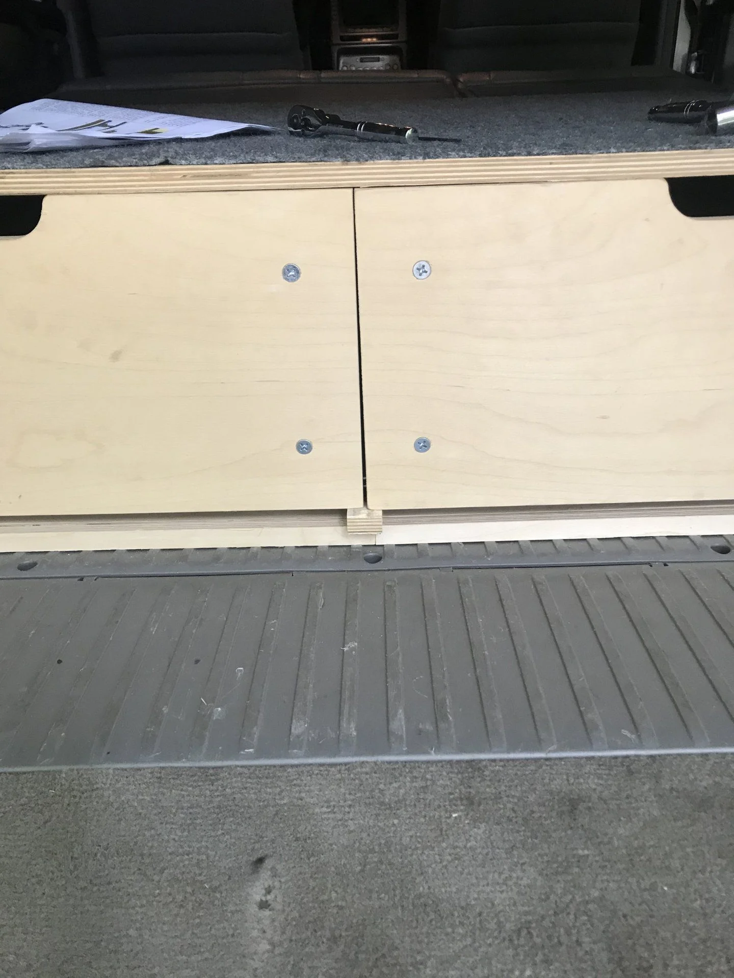

Love these, but check this out. The entire platform slid forward...que pass?

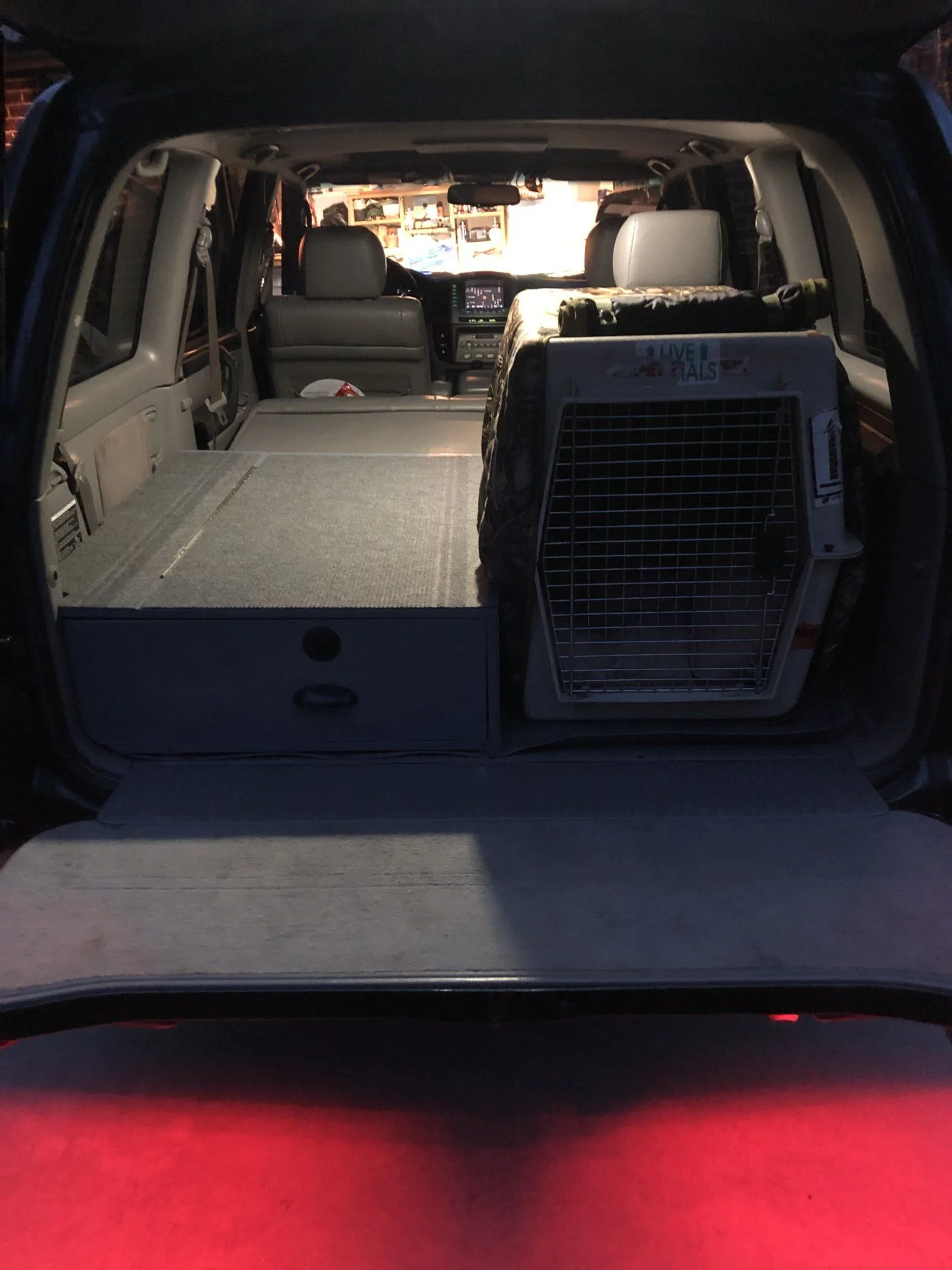

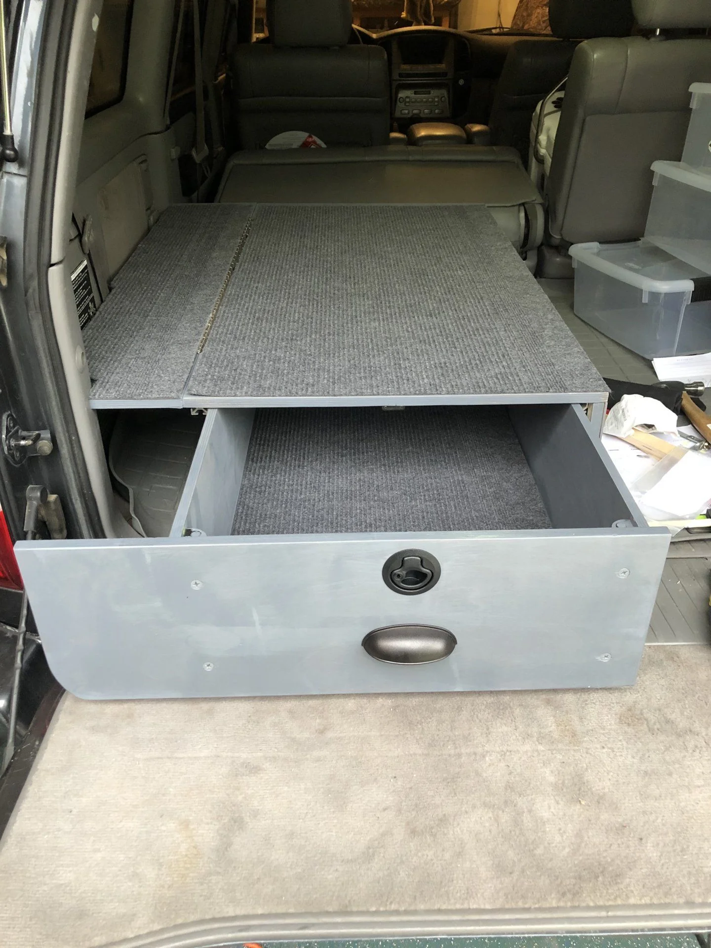

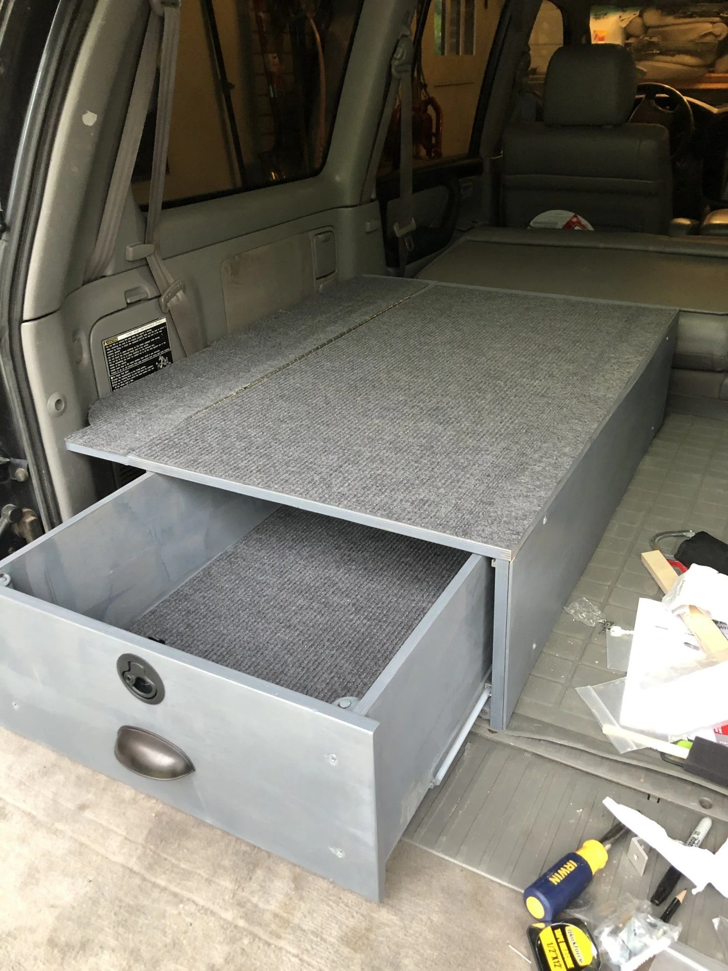

Working in the free hours of my son’s HS graduation, got drawers built and finished. Now I have storage and can still fit a dog kennel. Used locking slam latch and a pull with cabinet magnetic closers.
Didn't tighten down the anchor bolts to the bottom aluminum. Never heard of it happening before - just need to take them out to get at the bolts from below, tighten (I recommend with loctite).

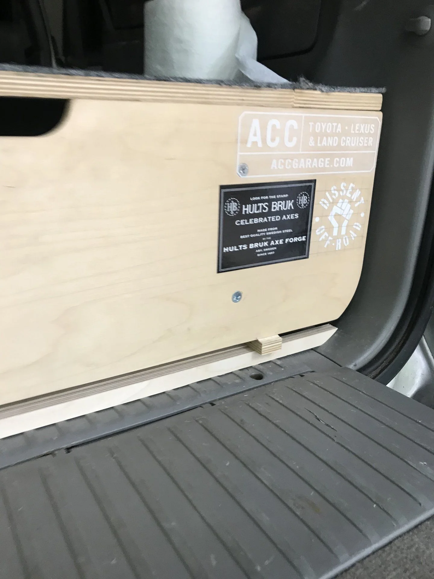

So you mounted the solo over your weather tech mat?
Indeed. I think it would have been easier to install if I had removed the cargo liner, but I use the truck for bird hunting and need a plastic liner so blood does not soak into the carpet. I did cut out a piece on the driver side that was molded in and increased the clearance too much. Cut holes in the mat for the u bolts to go through and bolted it down. I think it maybe caused the skeleton to buckle slightly, as the drawer requires a little effort to slide, but still works.
