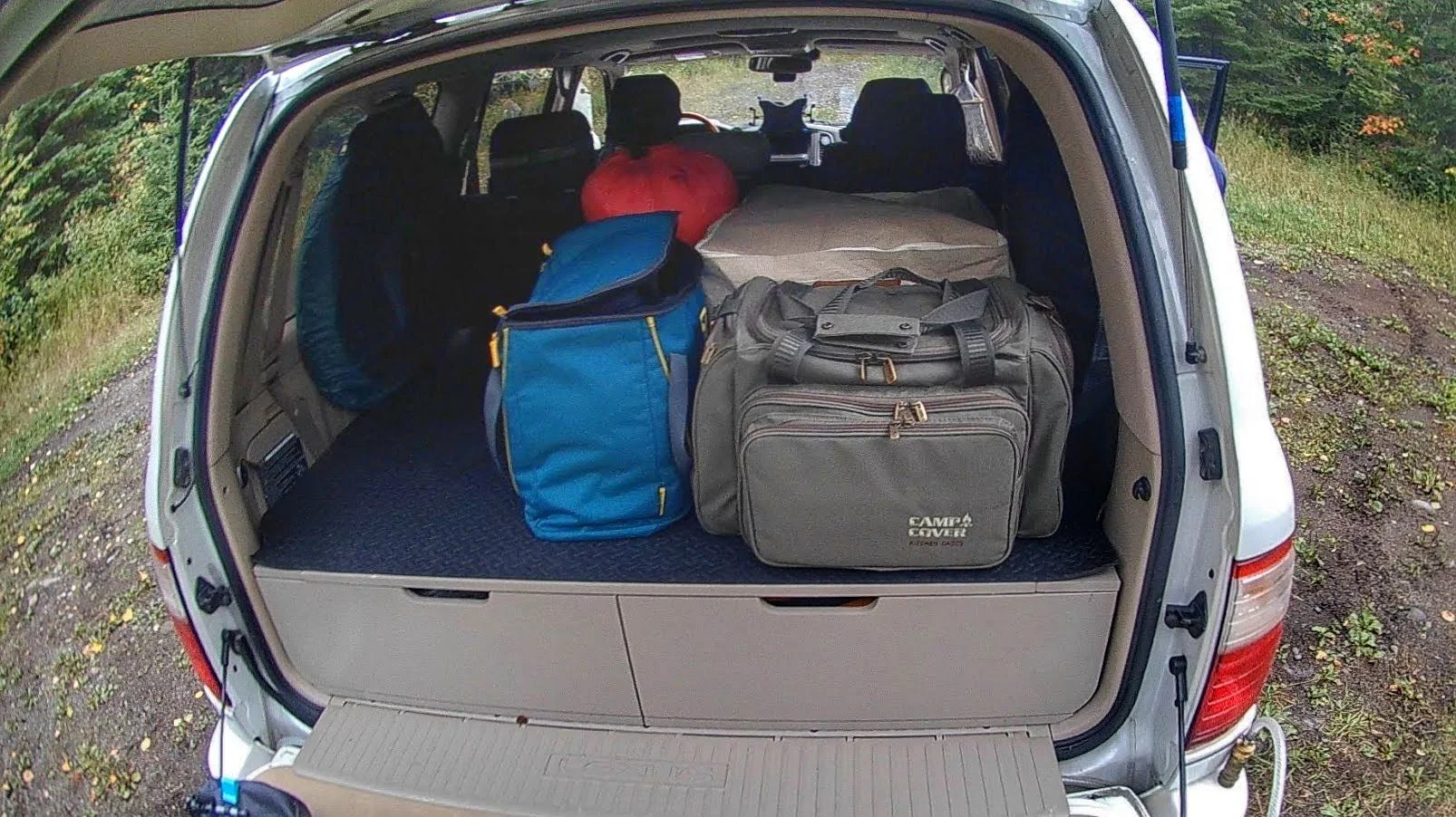

It has been about a year since I installed my KISS drawers and I think its one of the best additions to my setup! Our longest trip was 23 days and we slept inside for 18 nights. And of course several weekenders.
KISS Hotel, note the tents dont have to come out when the mattress is setup:

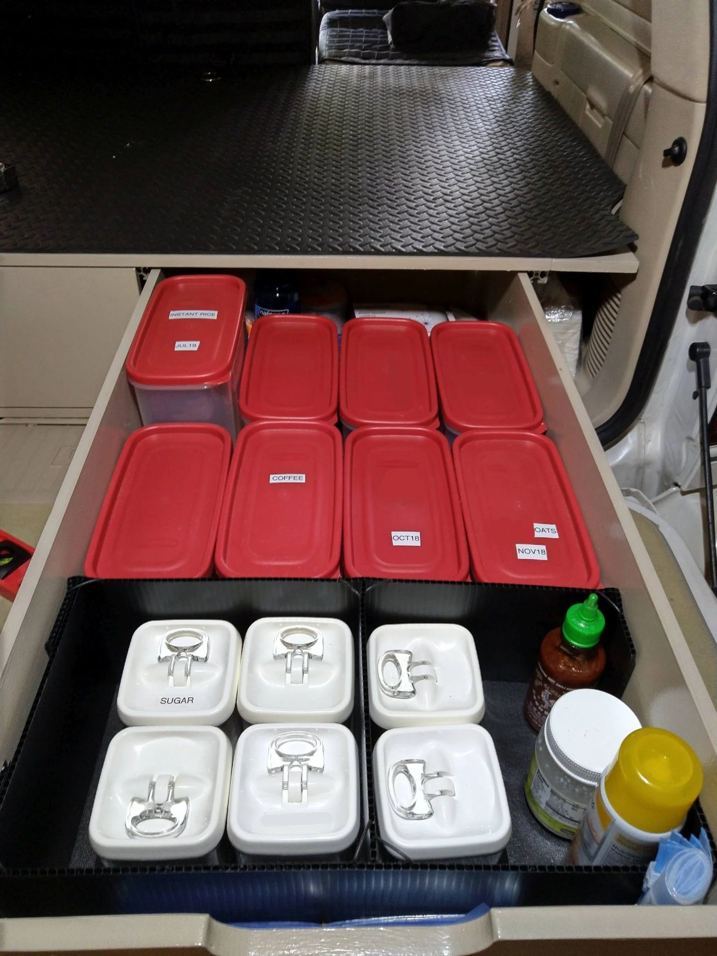

KISS Kitchen:
Ready to roll:

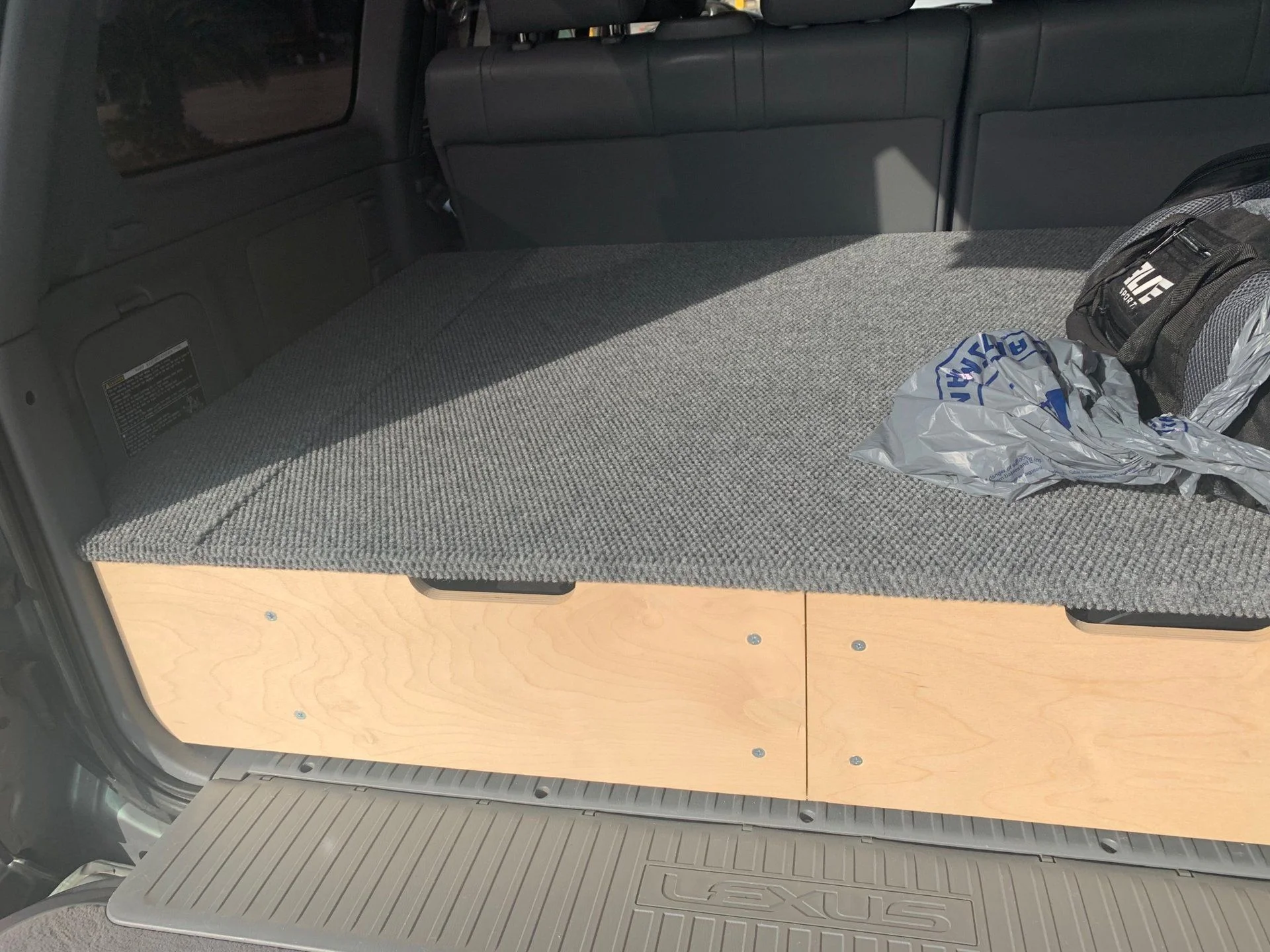

I went to Lowe's to buy some indoor/outdoor carpet to cover my newly installed drawers. They were out of the color I was looking for, and while looking around I found a pre-cut EcoRug in a color that was pretty close to what I wanted. The size was 6' x 8' and the cost was only $22. The color matched my interior and it was easy to work with. It's thicker than PolyMat, but not as stiff as carpet. I'm still finishing these out, but here's the day after picture:

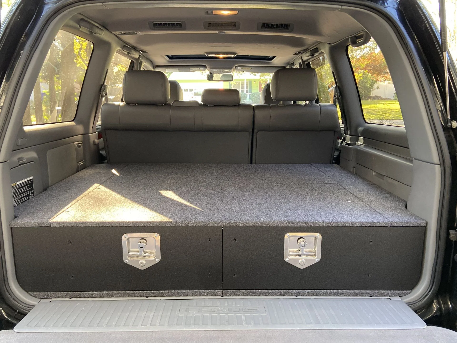

Finally got the drawer pulls installed. Used door pulls out of a Porsche 911 RS. Very happy with how they look and how they open the drawers.
I think my next step is raising the platform just a bit so I can have a fully plywood sleeping platform which hinges out. I plan on using some more 80/20 which extends out and has legs, so I can have a sleeping platform with or without second row seats. I can then prolly stow a camp table and a kitchen counter in the new space above the drawers...more to follow.
My search skills are not finding the door pull with cover plate . Any links for sources?
TIA

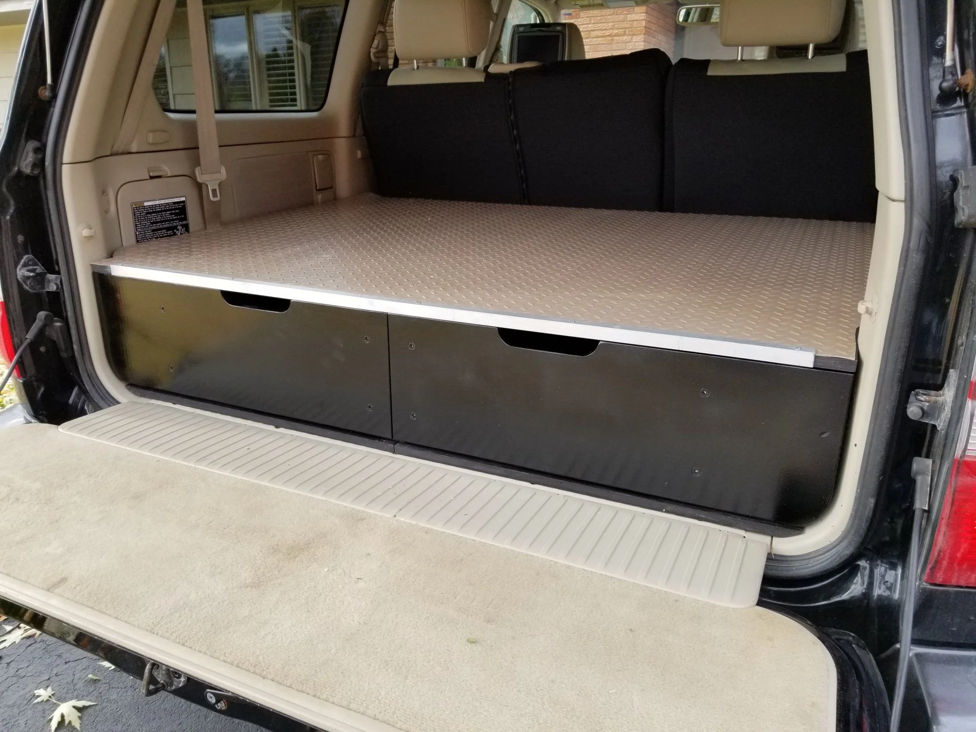

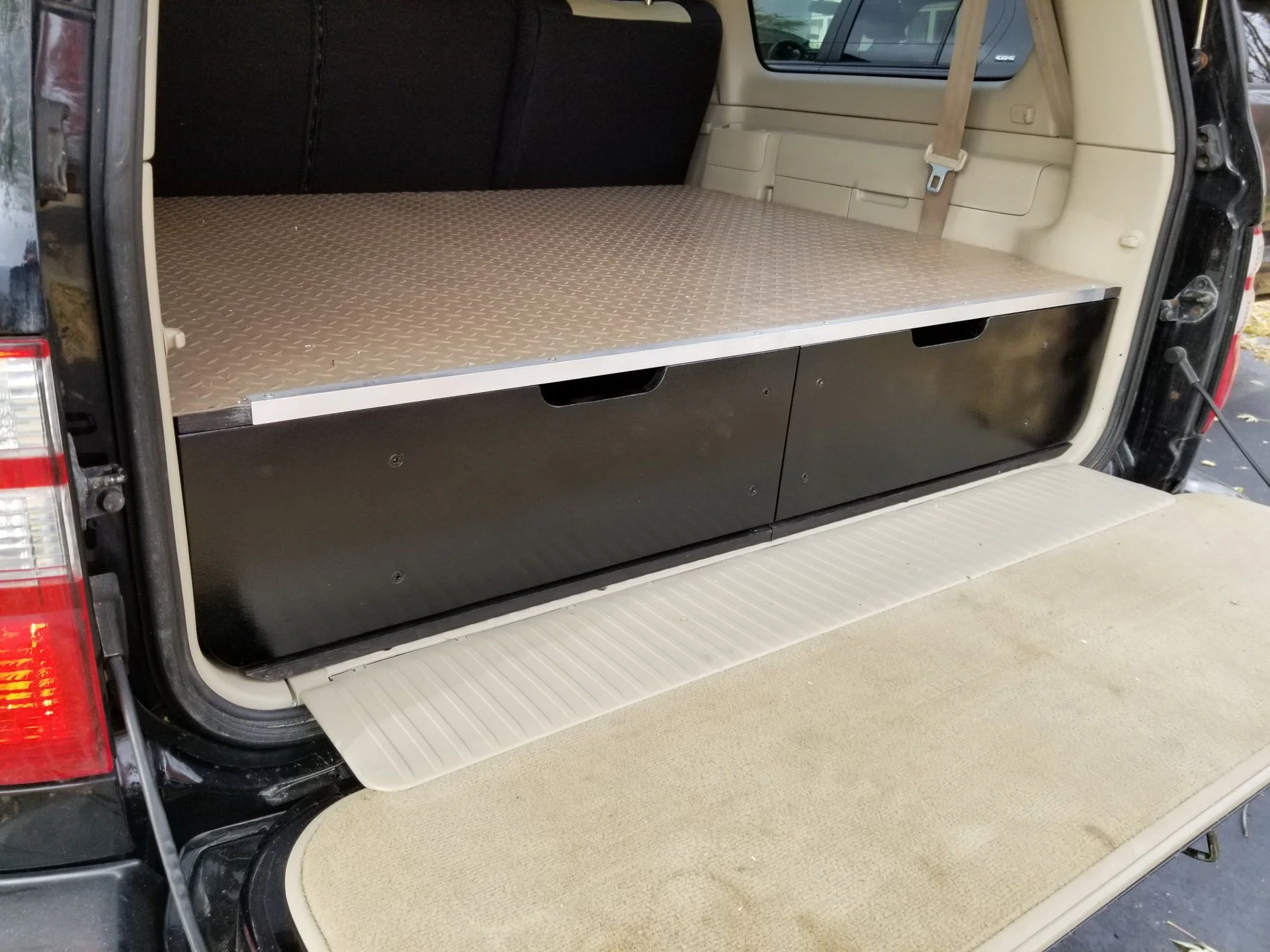

My install. I used Behr deck stain per the Home Depot expert reco, and it worked great. I covered with
Rubber-Cal Diamond Plate Metallic PVC Flooring from Amazon. Decided not to glue it down in case I wanted to take it all apart someday. I only screwed it down with the 3/4" aluminum angle bar on the front. Figured the aluminum was important to protect the front edge. Also put the rubber inside the drawers to protect the wood and dampen rattles. Everything works great!
In all, more than a 2 beer project, but not hard. Dave has done a great job with directions and the "drawer tool" is ingenious!

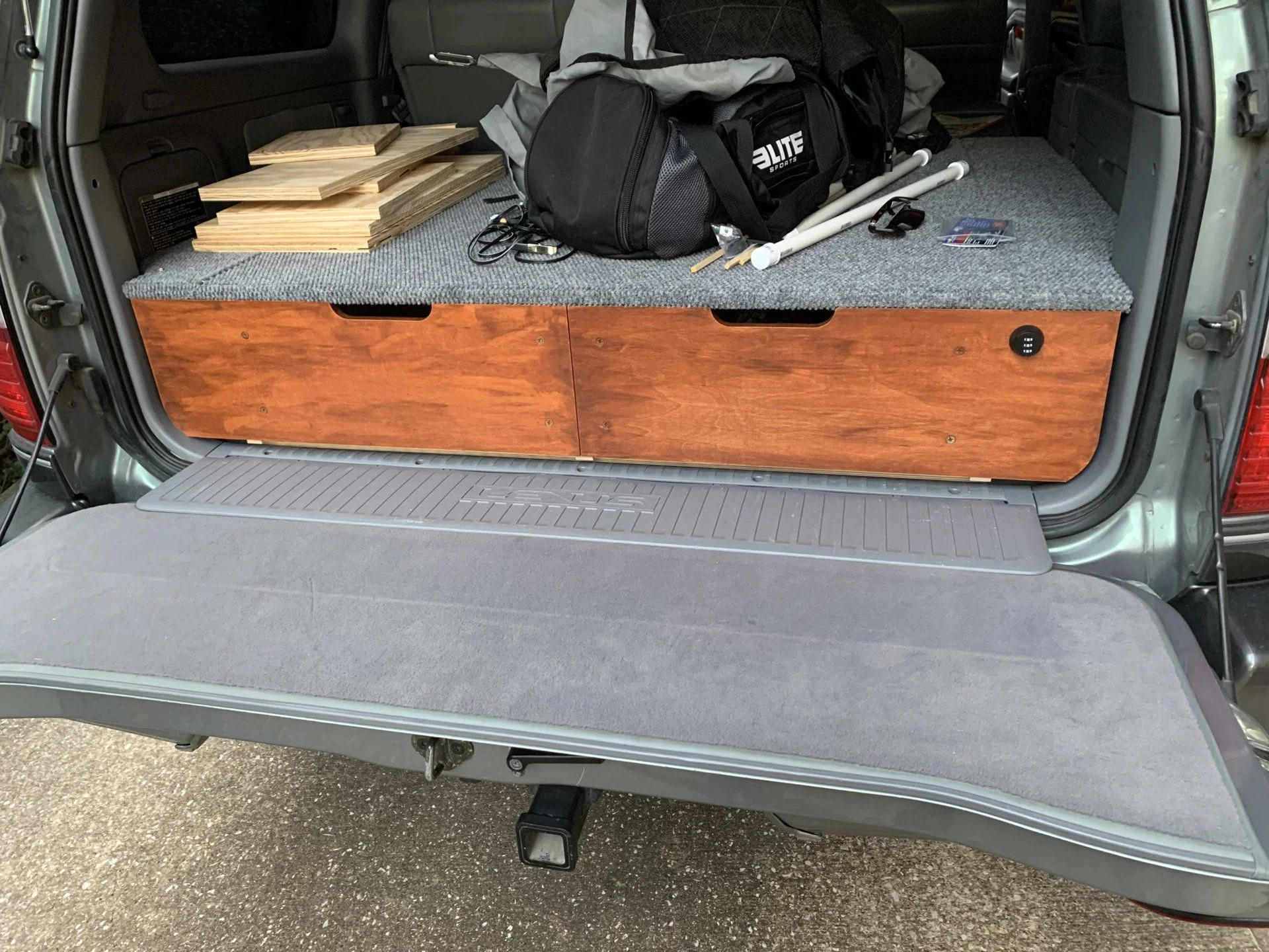

Hey, I'm working on building a drawer set very similar to the KISS design from scratch, all plywood construction, same dimensions. Can you tell me how the top assembles to the frame? I don't think I'll be able to assemble a one piece top (58" wide) and slide it into the cruiser. It's hard to tell from all the pics if the KISS top is one 58" piece (or does it have wings that attach afterwards). Do you have to set frame in the truck, then screw down the top? If so, did you carpet the whole thing first, then screw down thru carpet? I'd like to have the wings fixed, but also have the top be one full sheet of ply. Is your system a semi-permanent install? Thanks for any ideas you may have. Your build looks great!
Make the box that fits in between your wheel well, then add wings to the side on top afterwards using some L brackets and piano hinges. Cover the entire thing with carpet and it'll look like a 1 piece thing.
For the record it's a lot of work, if Dave would stock these i'd bought one already, just was in a crunch for time for my trip. For those building your own, i used scrap woods i found lying around and it still cost over $200 in materials, if you bought good birch wood at home depot, along with supplies, the time you take while doing it, it's much better deal just to buy the KISS set.
