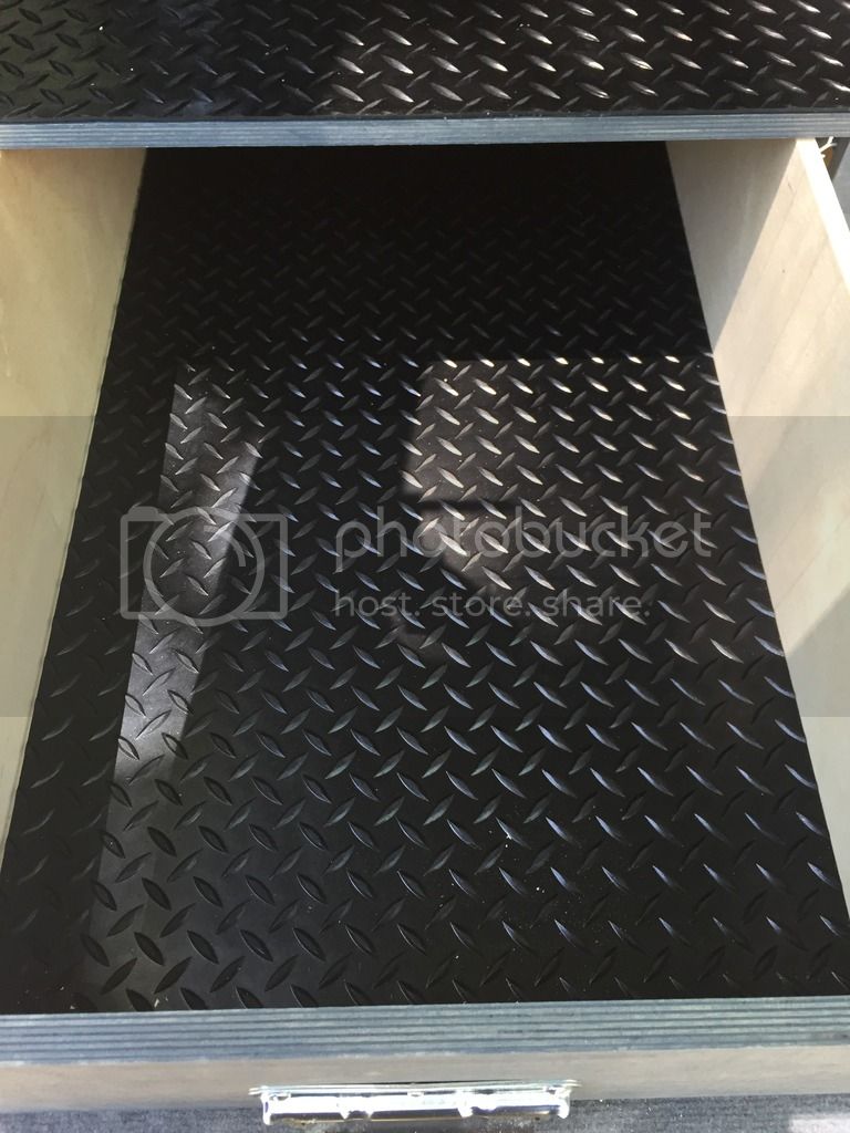

Finished installing my drawers and wanted to show everyone what the beige colored mat looks like. Here is the link which i got from this thread: Amazon.com : Rubber-Cal Diamond Plate Metallic PVC Flooring, Beige, 2.5mm x 4' x 6' : Sports & Outdoors Note: I paid $40 for this 4X6 piece
looks great, and a really close match! Also interested in whether there is any glare with this color?

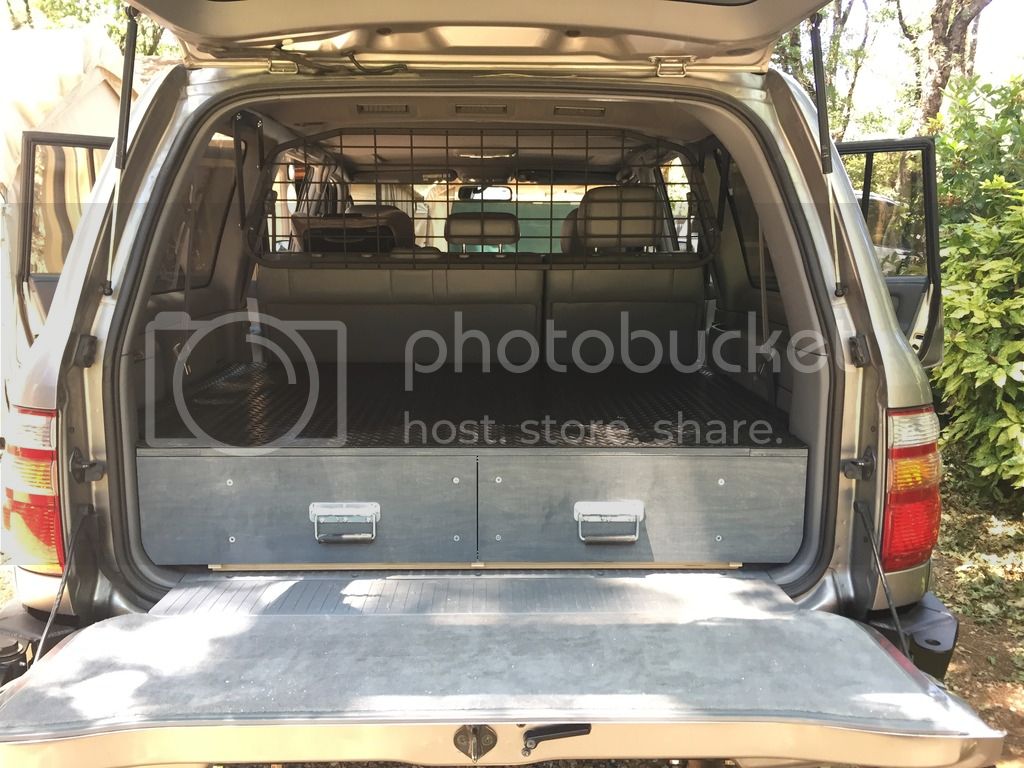

I'll post some more photos as I get things wrapped up next week, but here's a teaser shot.
Can you post some more pics?
Im really leaning toward these drawers and having Line-X also applied but am really needing to see how it assembles afterwards.
As in, did you have to re drill to clean out a lot of holes, did they tape off well the places you didn't want the Line-X?
Really want to see some good pics of different angles if you can.

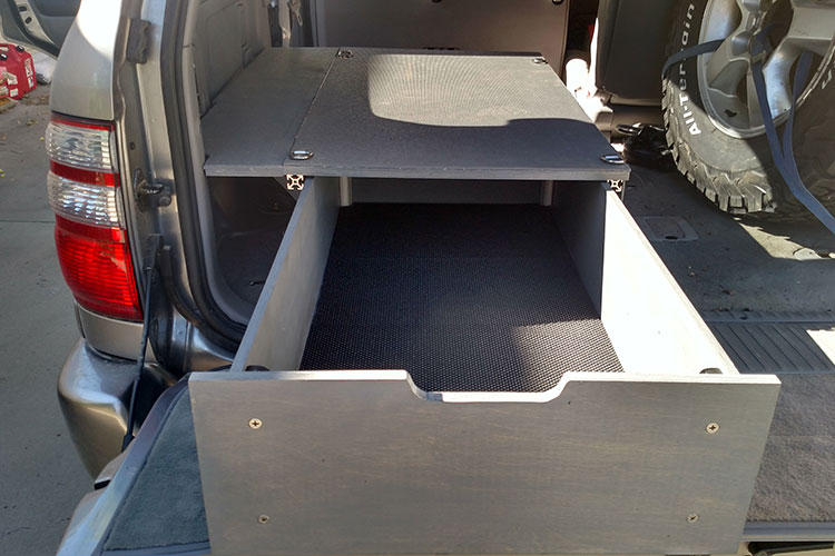

Finished up installation and assembly of the single drawer unit this weekend:
UpJbMqcjth-LLdwIzxanKmWcgW4gtp1DN-ESRByOIx2cpJLPjKQyxdcoeSqVA8P4Yh4u6Cy2K3wejkotiXntSnhM2MYT5KPgtTj8WO6Lbo9OERtKrzpbH8bcj5dvvoyc91-JJC8Ka67l-eEi8xXdNxYPRmYlUS2bl9OyGJYUA9SmGyuk_InWrXFRbwrE3bKI6OS9kMrqCK3xGuGOQMuH_IWz5Fm5yE9t_LyAZAyDXsQEsurVEMckVbw_ZCRjLIpIxH7EF86bwcHFb6Fcsadi9AtRz3NWpO8DgQrfjabtGp44yrn0nztFA5oo0fuIv_3ftejnW0M_Xl4VEwIL9Y6J0uETt8bTPsl5-c243HNS6nXAoN21S2Td3iE9j-7YnVC4xfLp05B8DlYZamqlJbR27ugpDeJ_U-clM5Nbz-nygMnbdM-5MGkdnRy1vJD-KzY_nYup5-u8MpKKrIctoeDVY6MB3SM1sdJ-i-WDx-EzbdHJm7csbYvXbktMdhscpZhjtV8GPKJ_TsPvLiGPUbu6zU7PsM3NBt_wZgQzWFzJ0oMjU7o1XFbjNU827Xc2aUCNj83jYep57OLtCQXaDrK7HD6Rqp4WnID-naOpZ0ILaNhX1RH3SYqO=w1689-h950-no
qHwv5vpJBWmn-zUsYpnzVVHYxZvgSptmRtFSKYMJEvq7WWffyb3Ld3BolXrGjdDcBEMKy3ys9tkRShIPPHAcSaVLZbOddF2GS680pAbQMpV7QSKuSIjLMqw742hqIZ8tmx1bZObaJPnr26tdYQ4yUyQfqYxmysxmXM9TKON8iMyo43om9QrLP55dGKLR6J_MIK-MC1o77KLw6THvFFAZbEqRXtxOxckZIvBLEN6urb-P7G2jKvhcB7jYgklK7B-ujGTg41ZQV7N4V3J0qjo_akAFafhuGWEYDD29NtgI3-udlgfe-pOhwgN7nahtDnvORjMAW94Jk0Je9UizalqQ603DCDxI38YA2aLlgA0scl0vWfoSanUy46lHX-8G36CMP1jhPakf_TqSifjUb9qDYoB415FsEbnPmgwsPOV5p9Kopo_2IipMPUdNIp1ZRbeD96pCsMO-qsQ8g5U__ZyBM9Ux3KL4NJl6n_mNW1QiVUE9uXd4Dvqt75KFOZxB8VxAfH90x-OFikw4pW9-n3XWAuf9aKMQ-HwxKaQCLCyeYM7beu06vPZLMXGPPGcwqNdGhMmfzSpVrtTvqK9hYHw5WmeiJjj3eLWk_fXTeiVzENcveily=w1689-h950-no
4E0xak1bbcgzUvRd1HienniwjpcM8XurRo7ihn5h6vTpPpBdwFj_ydMDSEwjSryJv4tW9cVWLbrb95PfsSSDdd0C5dr3wnP8o1j2SO6f0_wVVuQBRGq9zzPAXrdim3fxyObSnzEutV1ZFRtAvbvvkmhArwKLHOCkkRlVWfHRlbjM3f7riZddlm_Xwr_lw_4x_n53Rki1t67Nv4vwToCTw5IAPYuhFG0EI0VIvT1BtN7txmJU_tFSzFa7Ad6AtehQKVzMpIxspH7IP0lK7k7knBkE7Kku30tiABDZNdwsmtuyltL0ee58Ig1EG3iMXB_vUzT0wNaEta4V9Y24TLgs-NafwnNpwuoymtSQckY9FObqqEBcKmgMNkqETROCp6mXwe3ErCXMC4fG-HkoIWMnv8LhxxwY7qK1sSFrSOGYXwmxfwIEFPqx19p3aAC29HhfDfTlWqLXkBYM5BrJGx_onweqPzXlkoGl5zfRjAQvlwmn0wTBmI2rqXHlF3YiDGt_pz5bgGYX0fklPXrq2mD0AUJGPE7VBf7s-688RTvUIclOA0G32zaFOGN5kT2ZVax03J25KL12N5884SQAvlJhPm0pdHL19JMyWMGfNAEyqO43XWVX=w1689-h950-no
FvQkcxCu5lBxebf6K90ah7o9yiUahGi2k7YUKt7go1BhbT8lsFoS38N0xfYyyuWcW5zf_YId9ApsMcI4ZQ1O_c2m1i9eDKe81feTWGz8zJKfiboi3q2MoAZdn9-lYGqh8Ty2-5uwPRPk4R8PhXOFSUriZRMfyY3v0Z3K_yibphrNlNjEAG1igBgTsAzIw6kVjbiI4_jUzZctj7ebtvB7nDsB8N9b8qxN4_xsEfAILBdwIaUmall9zGQcJg2cOcQq2Zc8rwTRA0M9UyT3mw8atMekExIztwTdb0ZCJnS8jyMYKGSruyIob3DOpD4c18VljgeZuLVl16u4SSRuQEZK2kkzd4UXPMLgxmC1TZ8nxzJi1vWepHYp9I6Arch-pxn9NwevDyVYH7NslAsd4Di-o4TYAD6XDWwngryKGasIWS5rF9PaVry1hjJlGyK36NZHOXSGwnVCFjxTuERg_ZtXiIGTNgEPJdtnK7ug1FaCmM2Aq3irUFC-s04fr7UaweMx7KIEKesT-RL0fBlQ2kxK-qeAvG-RWXKUeQfSIb6QRNQC5UV51nHgbGdhzy5xssKpEXt1n3Y4sITqDesdEDzbiPcZLUdk02Mnql4jMFQyzohC-CBi=w1689-h950-no
I opted for the cutout for simplicity's sake and lined the drawer with tool drawer liner that can be easily removed for cleaning the inevitable spills. Piano hinge for the wing, SS tie-downs on top, and a yoga mat a la @abuck99 on top. Got a lot of funny looks buying a yoga mat and a case of bud heavy at the grocery store...
I used two coats of the following stains and adhesive:
CcV62dbK-g9KSLpU1oCwL5AFXjX3T0SRUpBe5mVtj9G8T-8CFSi7y-2PKfI53AqrJIXbOEdQNw6V2Y3aUh6fAAHvHSAJRmG9aOTUgwehPAKKNZrrqejnVO_N8eN-Q2tXoBWwlPk2SQVlTjN1nJseKIZ9AJERutaas6JITPc4uVI3yK7i39IpTkQm3SyxmlCtV9e4DPTIc5VdLXIc2_yYkFQsm7A34VOxyUVGxKrgs7b4ubIYpuTD1Y33UKgWayKOr5lGGEjau2lxQobD_rlivZbjztlzVjalB8uaV26fA3tisE007RHBzRX3YV1CohjV5X93HjmTGS6p2SaHLPFieX-6WedNRt7yNHIT3icsz4CTTR48gSDiB-K4nDp3QZw1HTJ-OlfgDr4x2OwM7fWeSfVoT23qPXd0YOnqGqRiNcyDSGwU7vOqLqQPueFM99MmQCfDtx77IKixpykLBbQKgSMqvJ4M-GJmcquCWSQHdjU5Sf8KePNbOwHvozojbrZjtjIzOIqESN_d5BUT6saER9EzNy_pEIA7sVDhdPl4kEZw54QwlniNipxn8WqbcIA2qoJ0efnlNO1LyGETw7HrHKyC-NXQfC_hKKaHZqsyLmYF5trR=w535-h950-no
Wound up being a little darker than the interior, but you can still see some wood grain through it.
I was missing a page or two of instructions that @cruzerDave promptly emailed out, and aside from that had no real issues. The side fascia is a little thin at 3mm, but adding another set of bolts would stiffen it up well. The tie-downs haven't made any discernible noise yet, but the wing bounces around a bit so i'll have to go add some padding.
Overall, I'm very impressed with the design and functionality, and I think this setup will work quite well for my intended use (sleeping in the back, hauling around fishing/climbing/moto and camp gear, yeti, dog, and friends). Shakedown trip this upcoming weekend hopefully, definitely for the 4th, so I'll report back further.

Any more pics of how you secured the spare tire?
Currently running without but having the same idea to store it inside...
Using a NRS strap secured to the floor anchor points and grab handle until the Dissent rear shows up, I'll snap a more pics when I get home.

This was my first real project on my landcruiser. Building these was a blast and pretty easy. Used indoor/outdoor carpet for the top and ran into some spacing issues as a result but once I wiggled it all into place I was stoked about how they came out, looks very clean. I used plasti-dip on the drawer faces, after Dave told me he didn't like it much because it collects dust, but seeing as my car is always covered in dust I thought that would be just fine.
Everyone I have showed them off to so far have been amazed, if anyone is on the fence about buying these, don't even hesitate, these are well thought out, very solid and look great.
P.s.- don't mind my crooked drawer pulls... The first set I got turned out to be garbage and these are just a temporary option until I get some better ones shipped to me. I also would love to post more pics from the build if anyone wants to see.
