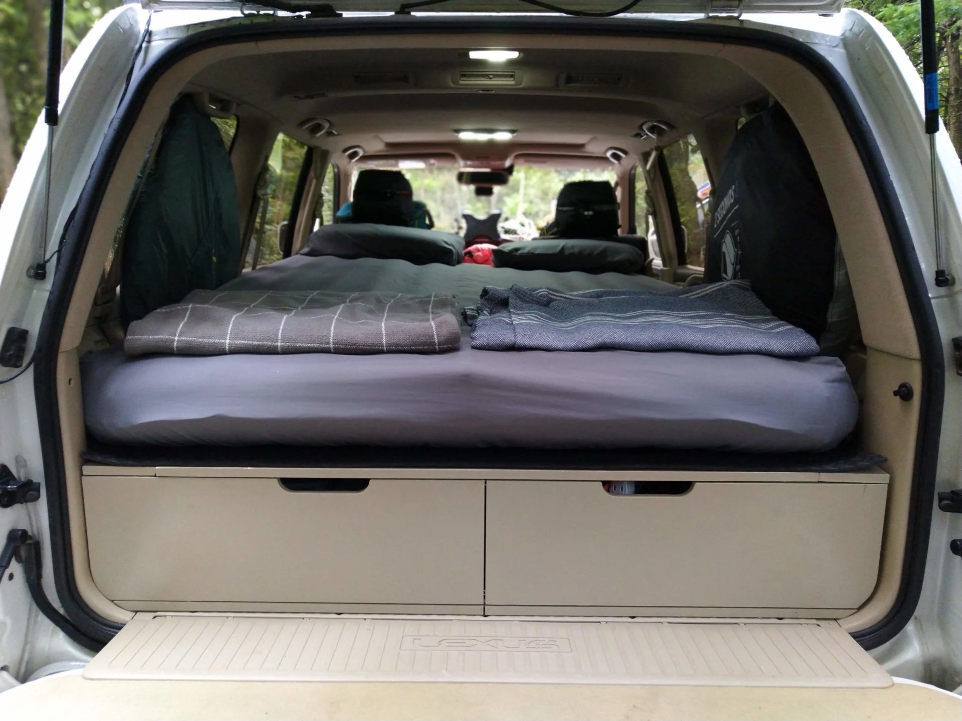

Mine are done, finally. Here is iteration one, already thinking about mods after the first successful weekend testing it out.
I called/emailed several paint companies - Olympic (PPG), Rustoleum, Behr - and asked them what product would have the best combination of abrasion resistance, off-gassing/VOC/smell, water resistance, and every single one of them steered me toward water-based finishes. In the end I chose glossy Behr interior/exterior porch & patio floor paint color-matched to the trim. I think they came out great! Bought a 46x93 anti-fatigue foam mat to throw on top.

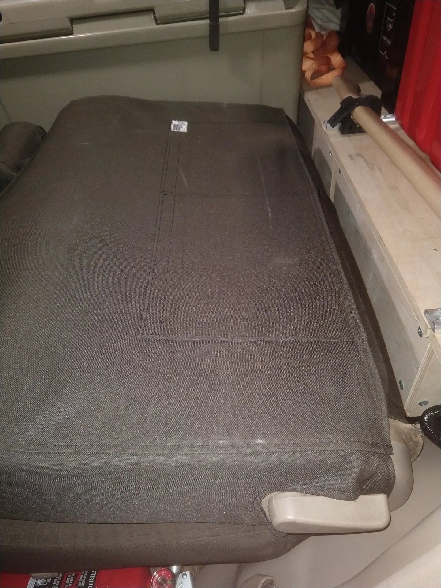

That turned out amazing! What seat covers do you have?
Thats my review. After a year of ownership id consider giving them 6 out of 5 stars. Can't state how much I use them and what a good value they are. As for sleeping platform there is an ever so slight gap and slope from drawers to the middle seats. If you lay the rear seats do you will see they are angled so some have greated a foam wedge to make it flush. Using an airmatress soaks it right up. If I used a sleeping pad I would try to find a way to level it or just sleep head to the rear
What seat covers are these?

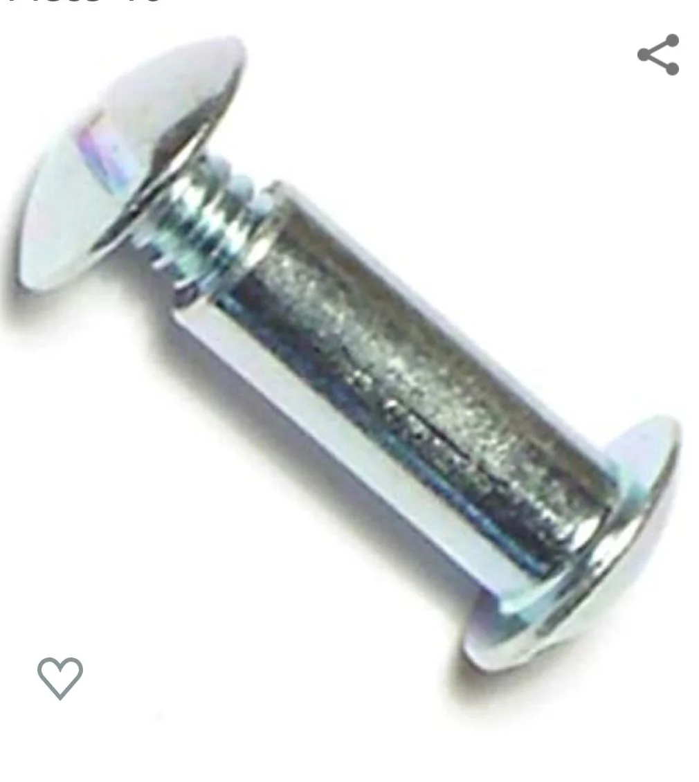

How about a captive screw?

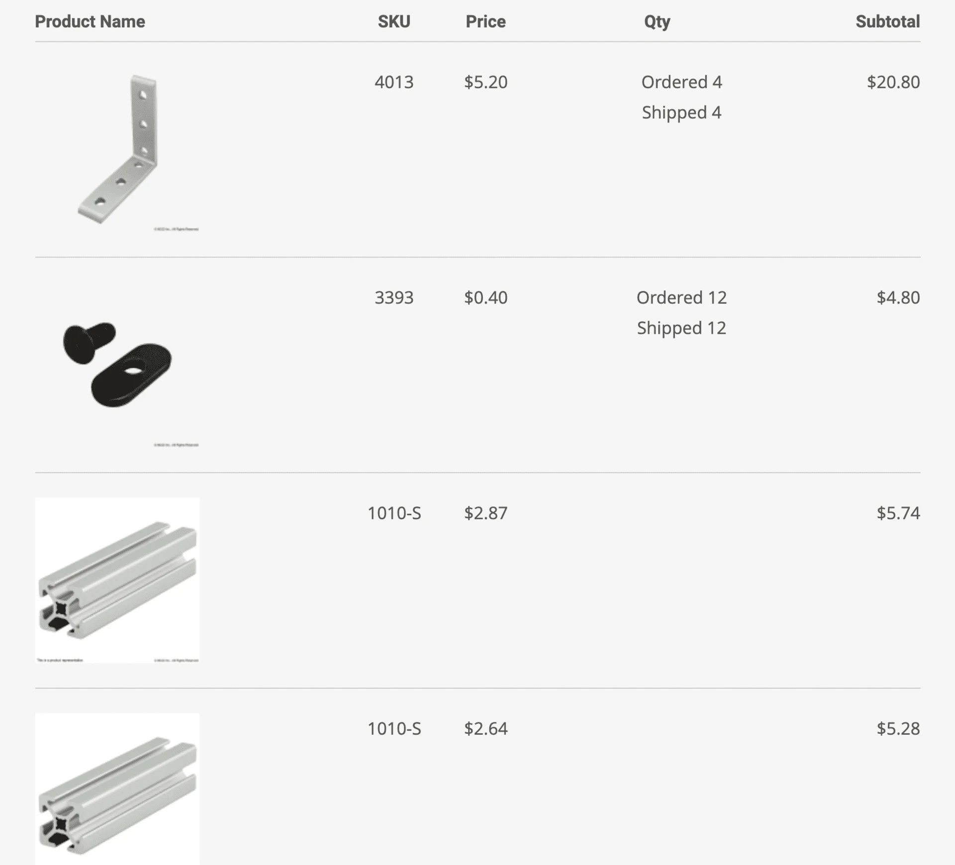

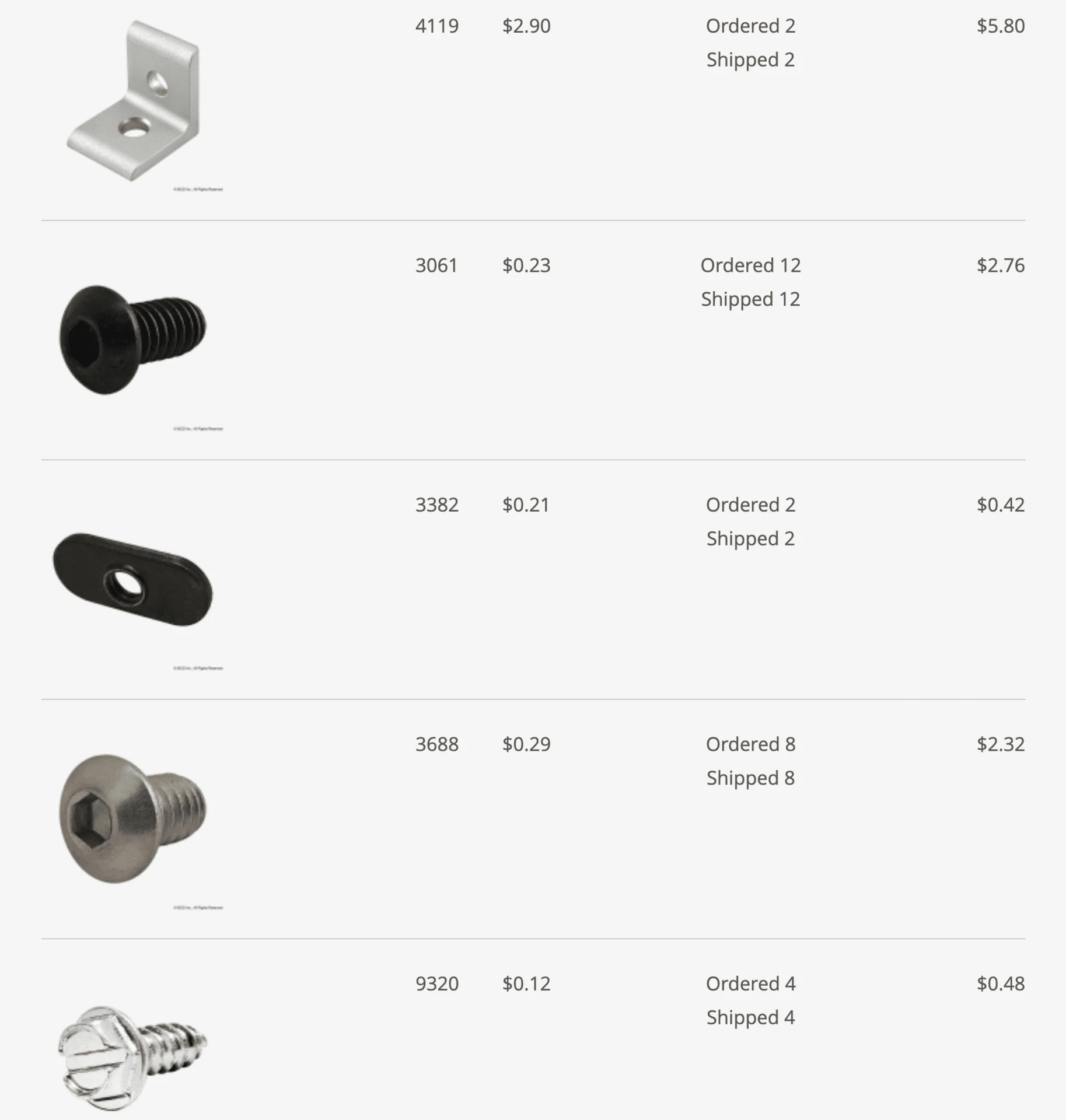

Hello- I'm considering this mod of fixed 'drawer wings'
I searched for the 6 hole angle bracket but only coming up with 4 hole
Materials list /part numbers for components used ?
TIA

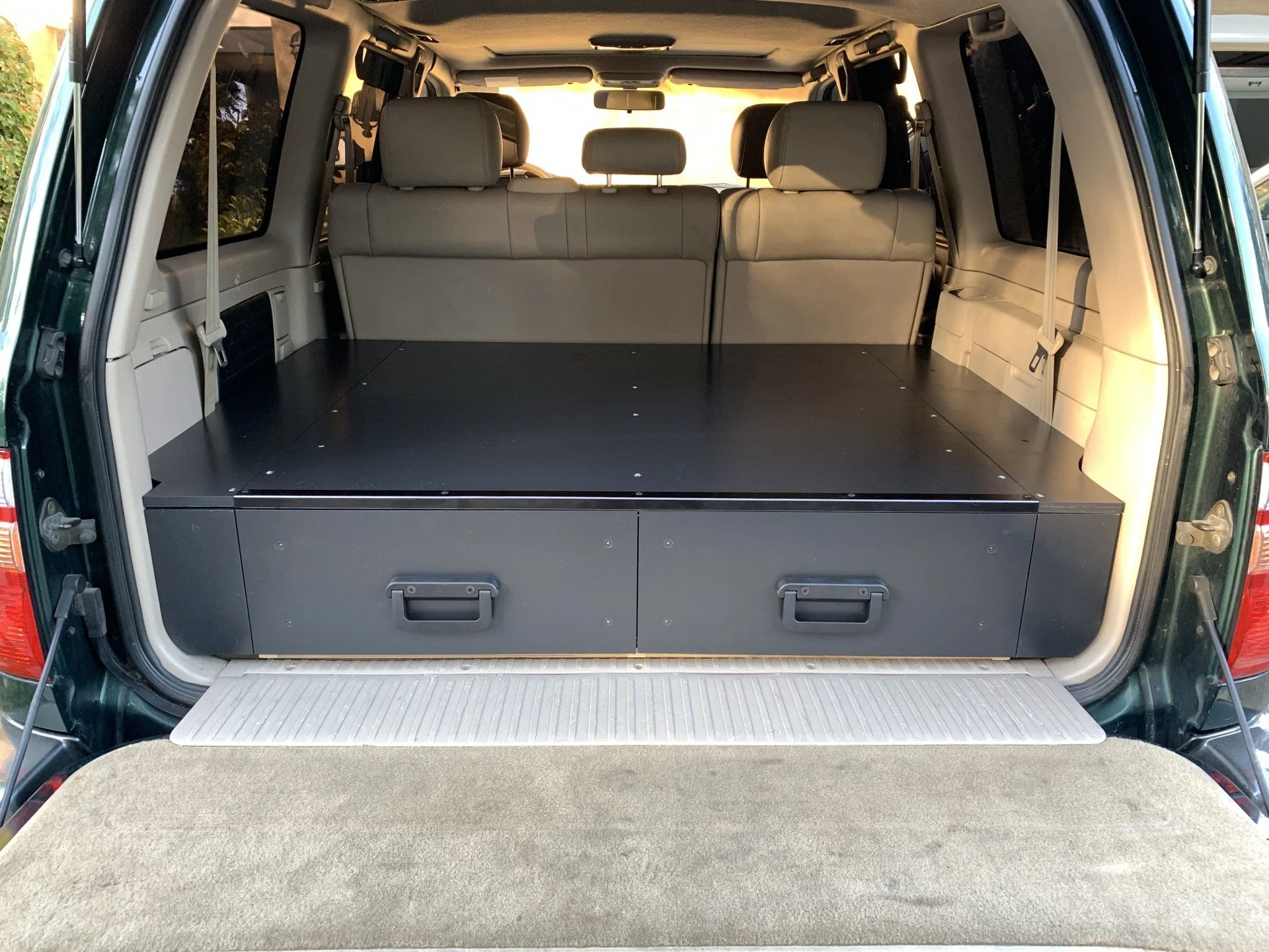

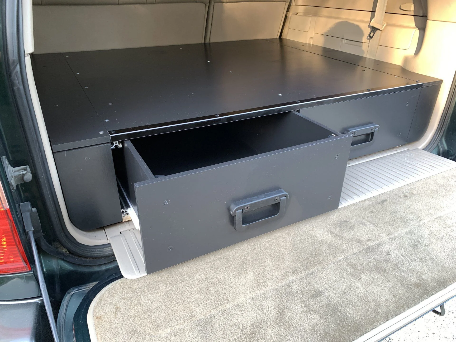

Finished my install today. Really happy with how the drawers turned out. I gotta say, Dave has created an amazing piece of kit. Quality and fitment is top notch!
Customizations:
Paint - Benjamin Moore Advance Satin Black
Edge Guard - Black anodized aluminum from sheetmetalsonline.com
Handles - Spring pull handles from wdscomponentusa.com (link)
I'll probably put a PVC flooring sheet on top and some neoprene for the drawer bottoms.
View attachment 1928219View attachment 1928220
Detail of fixed sides (back):

Here you go. You probably don't need 24 of the 3061 screws, I went overboard. I used some extras (single hole brackets and t-nuts) from the original kit, so make sure you count according to what you have. For the 1010-S, I believe I ordered 2 x 3" and 2 x 4" lengths. Also, you'll need 8 self-tapping screws (9320), not 4 if you decide to go that route.

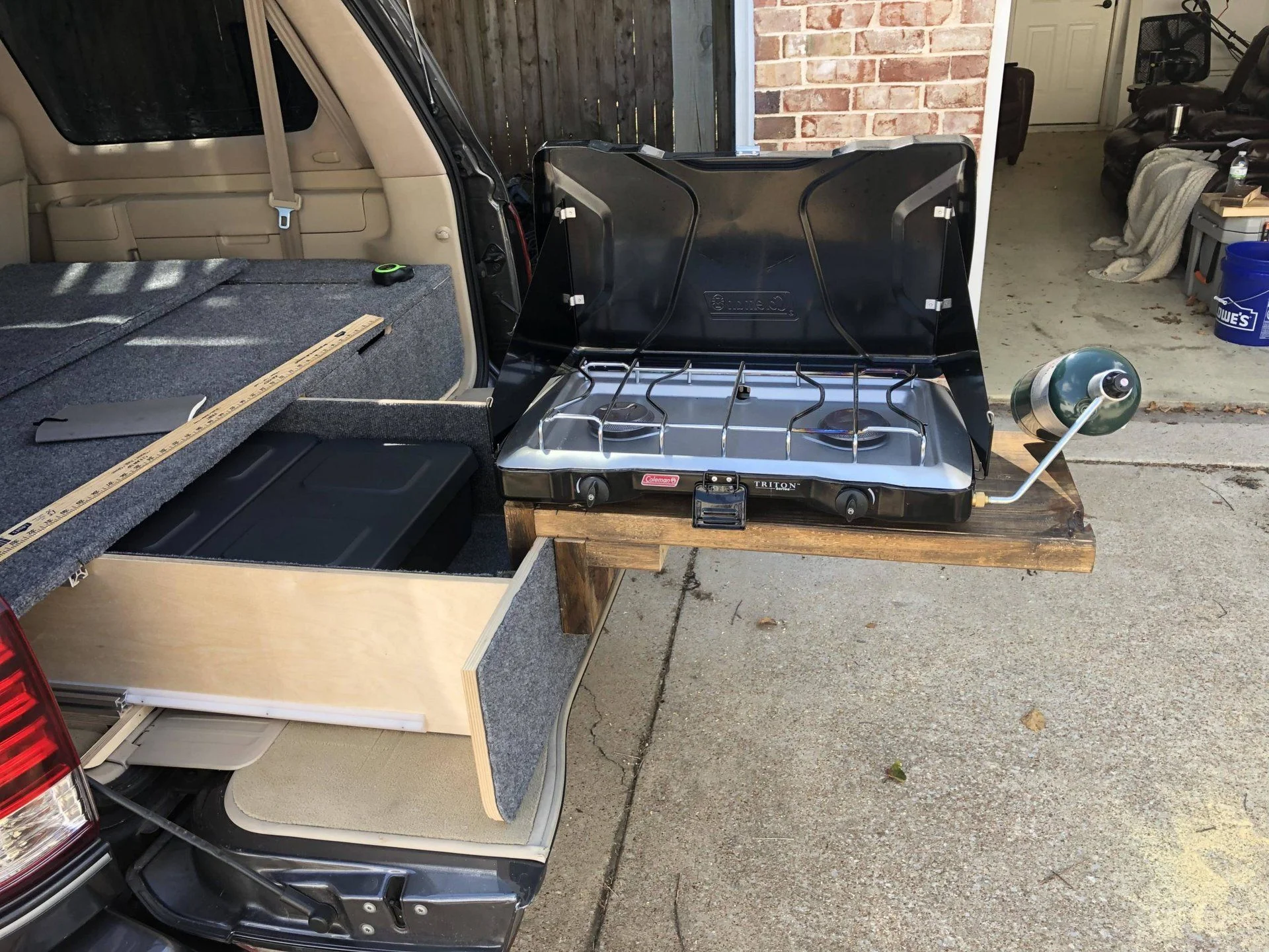

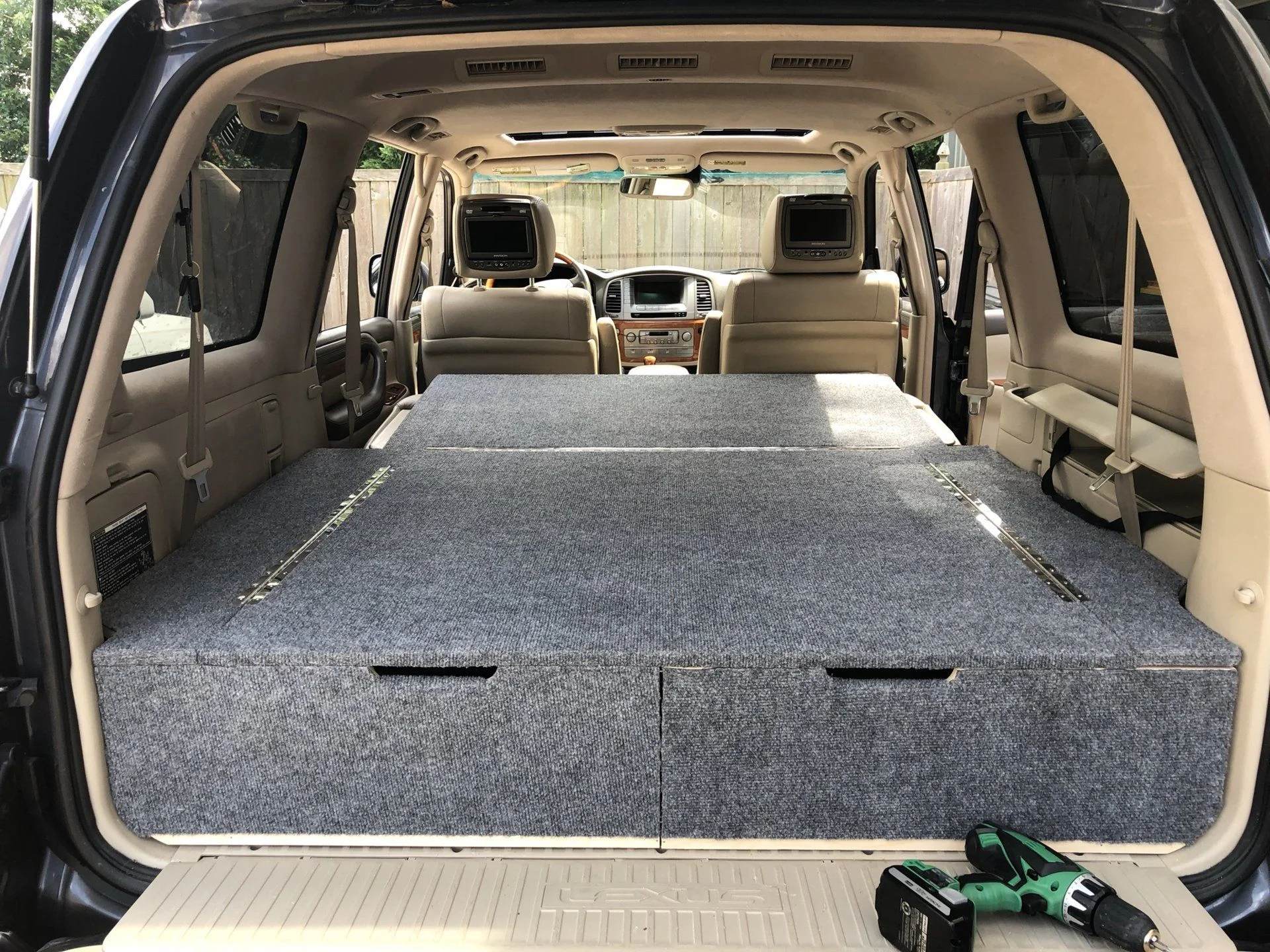

I just realized I never posted my KISS drawers.
Started with the base drawers, added hinged wings as to not lose any storage added an additional support bracket for the wings, added carpet, and then created a flip over sleeping platform.
I did this for two reasons.
I get to keep the full use of my rear passenger seats and when I'm ready to set up camp, I just fold the seats flip the platform over then throw my sleeping pad/bag back there, and camp is set up for the evening.
Then I created a super simple shelf that attaches to the front of the drawers. I've got to be careful with this one because too much weight and the drawer fronts will fail as they're not built to hold much weight.
I'm sure I'll do some more modifications to this eventually, but I really like how it turned out, a couple modifications I'm thinking of is a hinged drawer topper that can be popped up to give more prep/work area or maybe some dividers to better organize the other drawer. Who knows but the possibilities are nearly endless with this design.
View attachment 2102858View attachment 2102859
THANKS !! I started searching 80/20 site and started piecing this together last night

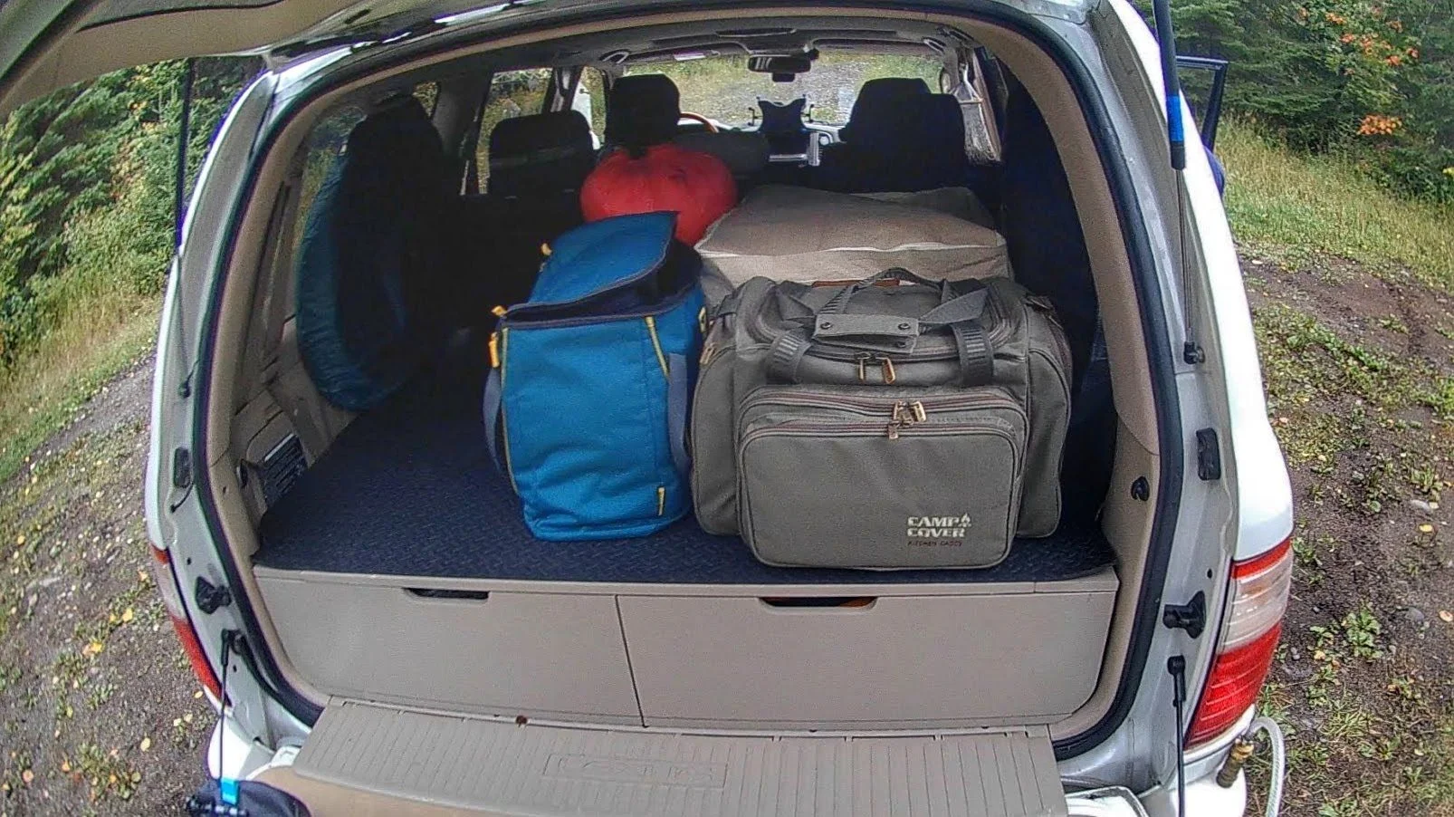

It has been about a year since I installed my KISS drawers and I think its one of the best additions to my setup! Our longest trip was 23 days and we slept inside for 18 nights. And of course several weekenders.
KISS Hotel, note the tents dont have to come out when the mattress is setup:
KISS Kitchen:
Ready to roll:
