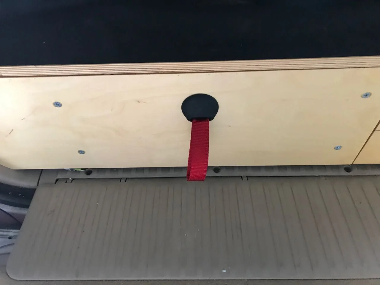

Finally got the drawer pulls installed. Used door pulls out of a Porsche 911 RS. Very happy with how they look and how they open the drawers.
