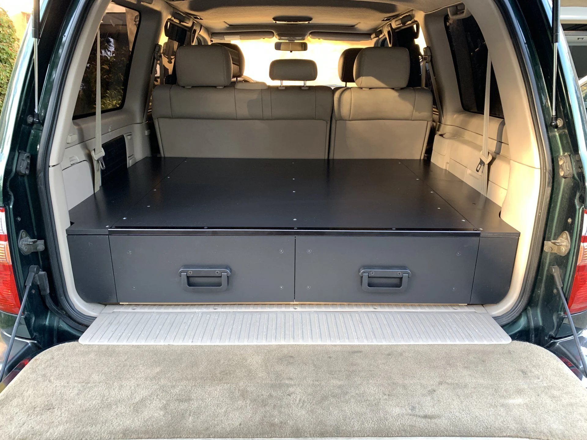

Finished up my install today.
I used the UPOL Raptor roll on coating for the top and drawer faces. I also decided to coat/seal the bottoms of the drawers in case anything ever spilled it would stay in the drawer instead of leaking out.
Also put a radius on the front and back edges to keep them from getting to beat up.
All in, this system is awesome and @CruiserDave did an excellent job designing and implementing the drawers (as can be attested by the numerous kits in the wild today). Cheers Dave.

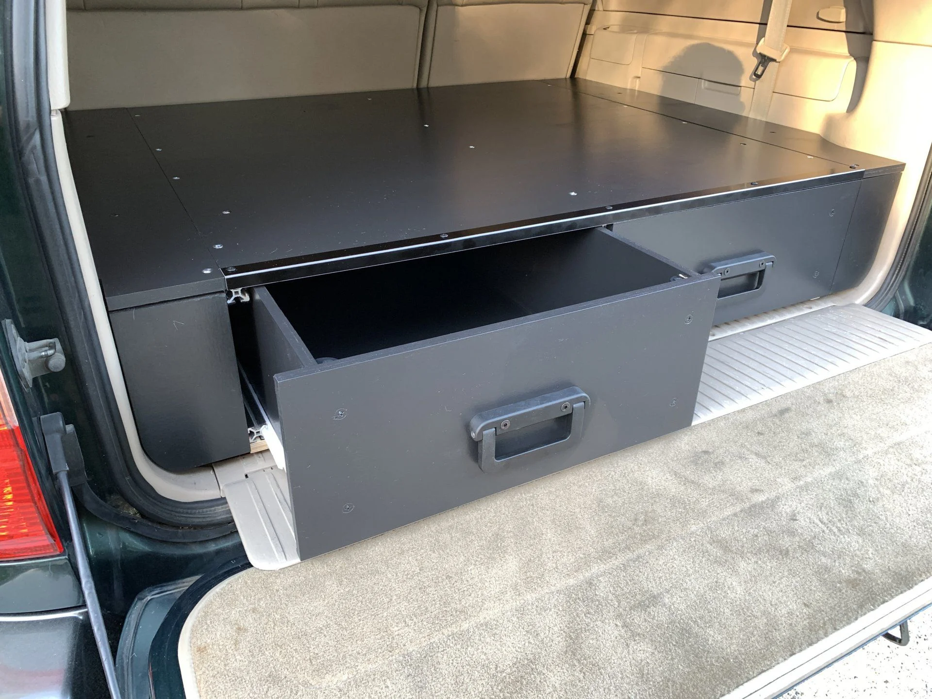

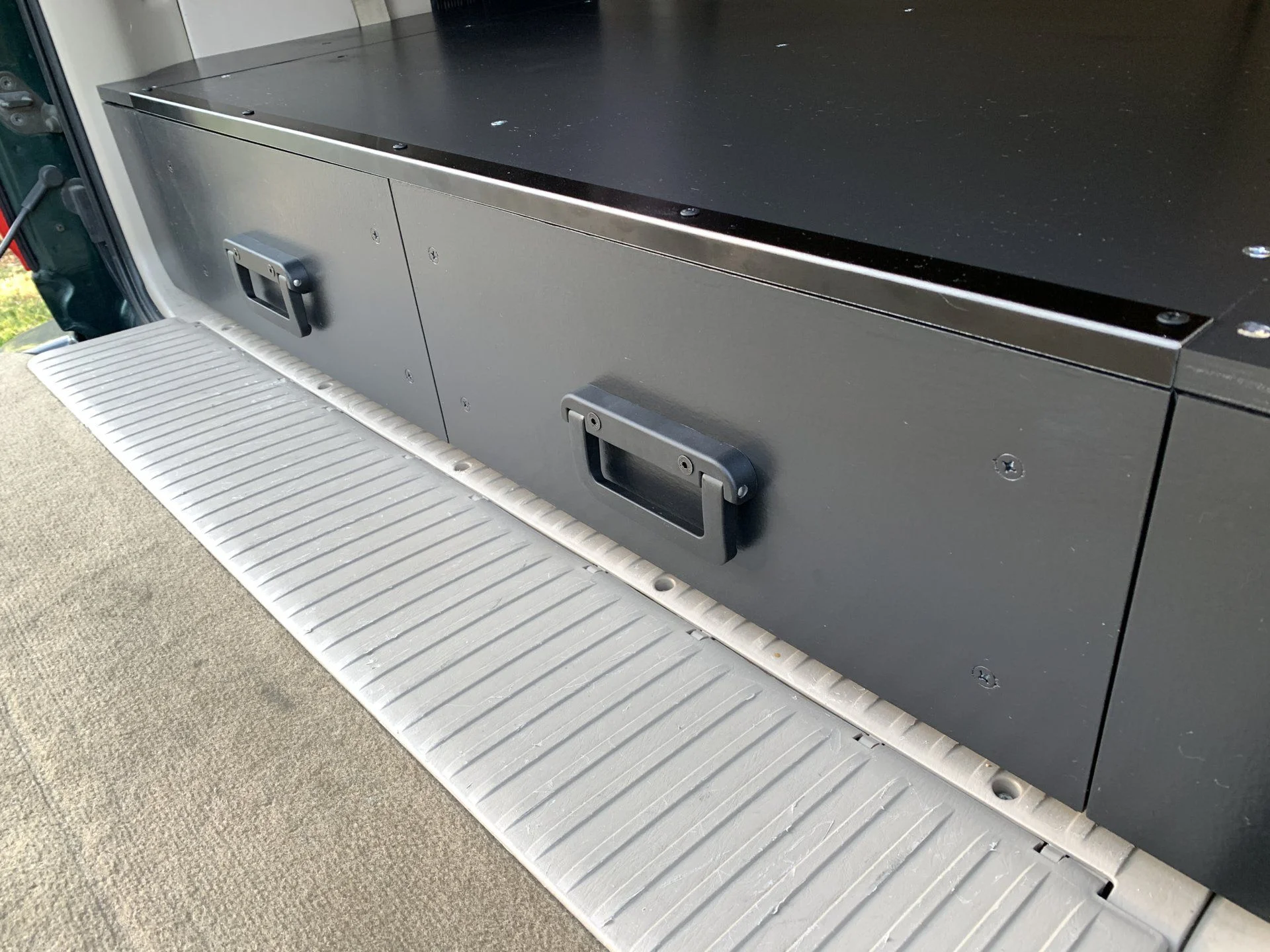

Finished my install today. Really happy with how the drawers turned out. I gotta say, Dave has created an amazing piece of kit. Quality and fitment is top notch!
Customizations:
Paint - Benjamin Moore Advance Satin Black
Edge Guard - Black anodized aluminum from sheetmetalsonline.com
Handles - Spring pull handles from wdscomponentusa.com (link)
I'll probably put a PVC flooring sheet on top and some neoprene for the drawer bottoms.

Those fixed sides look really good! I gotta ask why? though. It doesn't look like you're flipping up the "wings" so doesn't this limit access to this area? I store some soft stuff in those areas (TP, paper towels, extra towels/wipes), things that are ok getting a little squished or banged around.
Just curious!
Cheers,
rjones
Just curious!
Cheers,
rjones

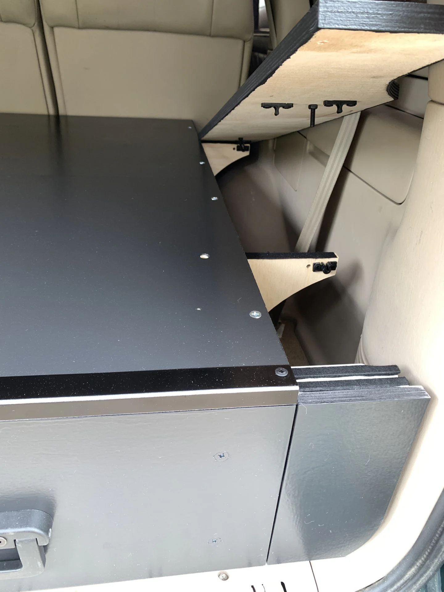

Actually the wings do flip up. I'm planning to add some power ports from an inverter to the fixed side. Also, I find it more aesthetically pleasing to have rectangular drawers :)
Oooooooh, can't say I've seen wings flip like that, and I dig it! How did you hinge them???

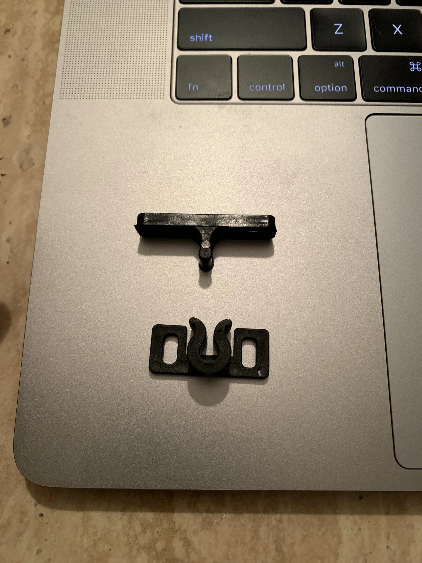

The whole wing actually comes off. In the picture I was holding the front up. I didn't use any hinge but I suppose you could install a hinge on the rear to make it flip up like that. I used these plastic door latches to hold the wings down, very effective (link) :
