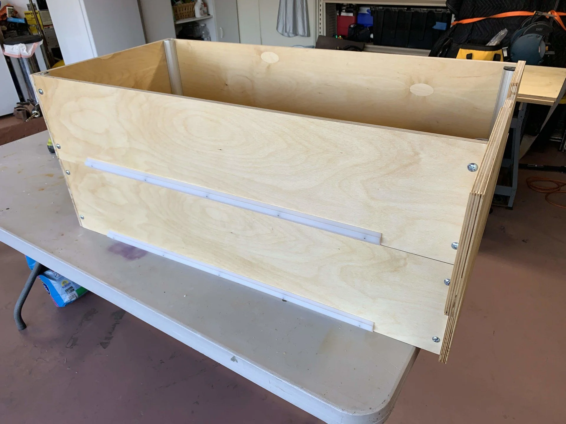

Finally got started on putting these together yesterday. Drawers went together perfect and square without any hammer mashing. I'm thoroughly impressed with the very simple tool to aid in aligning the drawer slides. Great Job Dave. Plan is to coat the whole kit and kaboodle in Raptor liner as a pre-test before I paint the entire LX.

the drawer bottoms fit in the dado channels on the 4 sides of the drawers.
I got these as a christmas gift from my wife. I think she ordered them after thanksgiving and they showed up on christmas eve.
Is the bottom of the drawer also .5 ply? I assume thats what the rest of the drawer is made of??

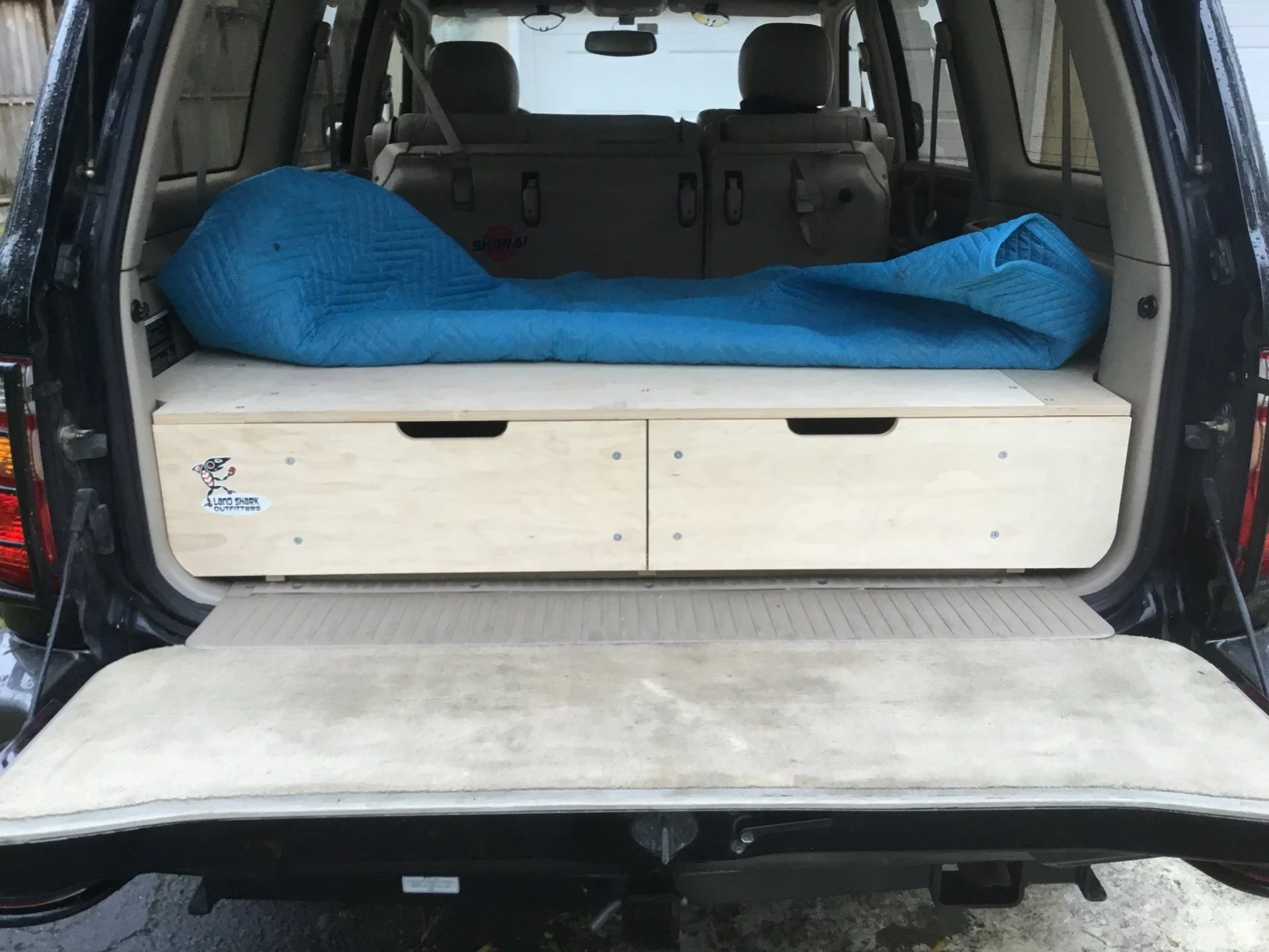

Added piano hinges and foam tiles from Costco. The small strip over the hinges can easily be removed so the wings can be lifted.

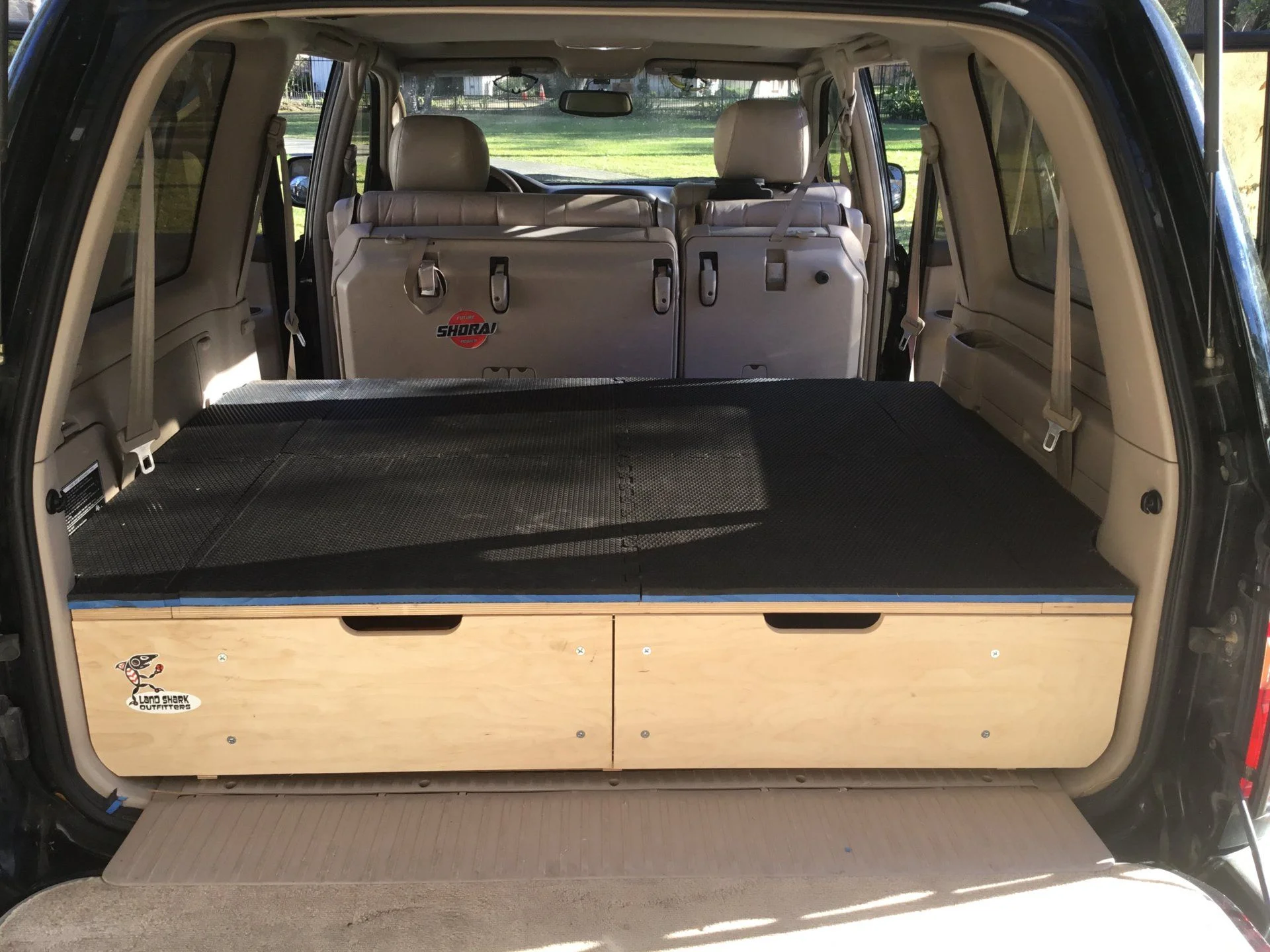

Finished up my install today.
I used the UPOL Raptor roll on coating for the top and drawer faces. I also decided to coat/seal the bottoms of the drawers in case anything ever spilled it would stay in the drawer instead of leaking out.
Also put a radius on the front and back edges to keep them from getting to beat up.
All in, this system is awesome and @CruiserDave did an excellent job designing and implementing the drawers (as can be attested by the numerous kits in the wild today). Cheers Dave.
