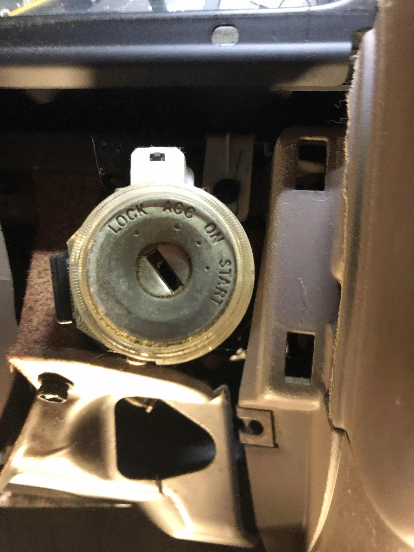

Hi guys,
My light bezel around the ignition switch on my FJ80 is missing. I have been looking for the part name, number, and cost. However, I cannot find it. Any help?
I also posted this in the FJ80 forum, but thought I'd ask my Tarheel brethren (thanks to prodding from @Malleus).
Its called a "Lamp Assembly/Key Cylinder". Part number: 81870-60011. The part is discontented, but you probably only need to replace the bulb. Toyota bulb number is: 90918-11014 and cost $4.
Still looking for what bulb it takes. Sure you can find at any auto parts store or Amazon.
Only bulb reference I could find close to that is 90981-11014
It's what they told me at Toyota. Maybe call the dealer near you and they'll give another number. I'm a bit dyslexic at times. I could of mis-numbered it
Bulb was avail recently. Or I may have one you can have if I can find it. My key ring was not turning off and was my batt drain culprit so I took the easy route to a solution. It’s a small plain bulb with green condom.
