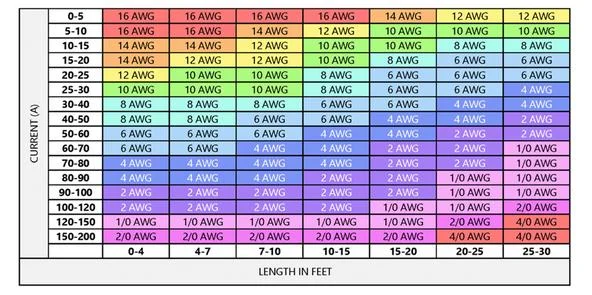

Replacing with an aftermarket amp should also take power into consideration. I am running 4awg to the new amp from the battery, which will hopefully be the most involved part of the process.

Helpful chart for other folks wondering about what AWG to use per length / amps being drawn

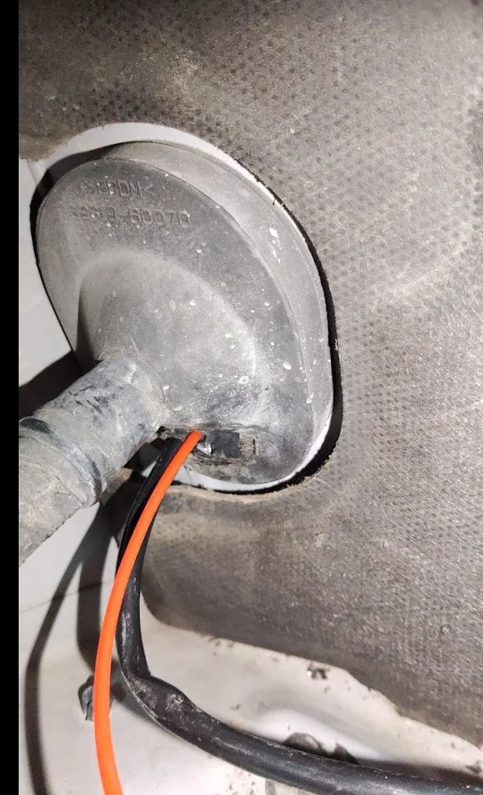

Also since our vehicles also have RHD version available, there is a nice way to get through the firewall via the rubber boot on the passenger side.
