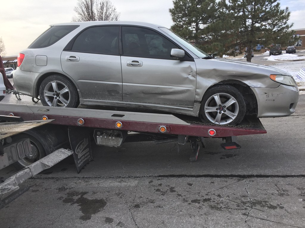

My DD that I got a little over a year ago has met an early demise. Everyone is fine and I have a small check coming in the mail from his insurance company.
