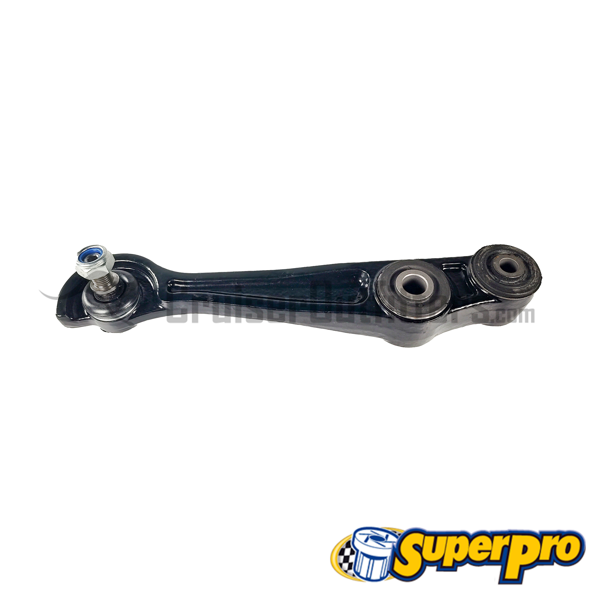

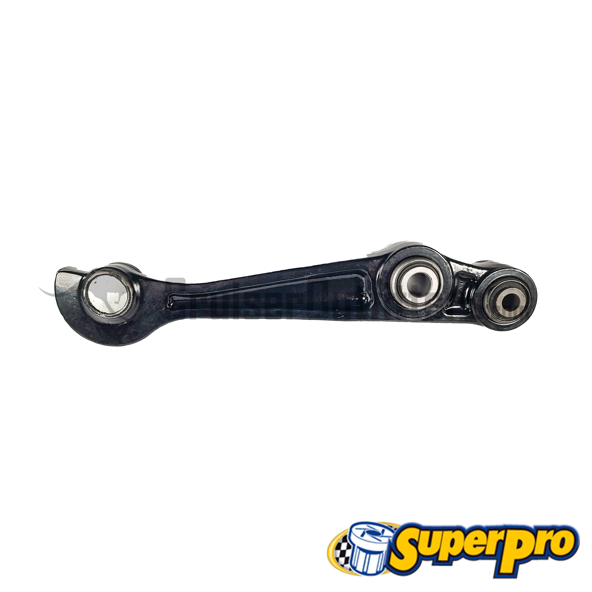

A Facebook friend shared some intel: it is a product from Superior Engineering out of AU.
"The link allows considerably more suspension travel with supporting modifications such as longer shocks and control arms etc and assists with the rectification of the "KDSS Lean" as commonly found in the 200 series.
TRC4308 includes a 50mm extension at the sway bar mount pivot, compared to the OE arm, allowing increased suspension travel for 200 Series with KDSS when modified to run long-travel shocks (length to be checked & confirmed prior to fitment)."
I believe that is only for the rear link. They still use the relocation bracket for the front.

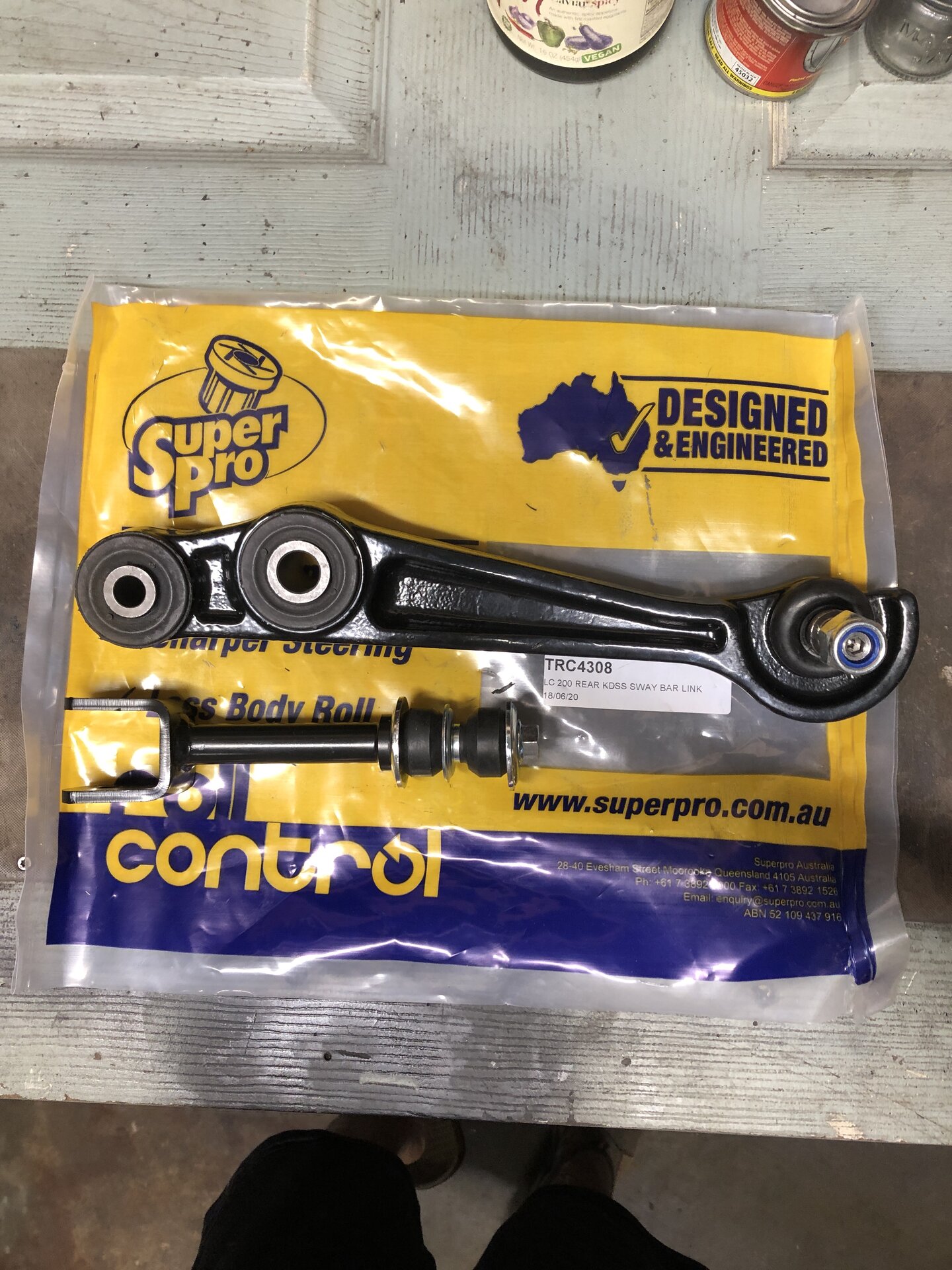

We stock them at @ Cruiser Outfitters, part# SUSTRC4308. Sold/installed a handful over the past few years. We also have the longer link for the opposite side as well as the pair of longer links for the LX570 (part# SUSTRC0041)

Well that solves that problem. So we need two of these?
You might want to replace the rear brake lines with longer ones since this extended links will give you extra drop on the rear suspension. In my case the Russel SS braided rear brake lines were the limiting factor. I replaced them with SDHQ 4” extended length brake lines.
