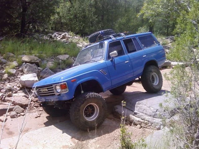

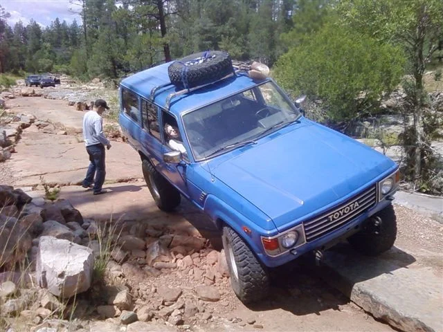

Poser pics from Payette Draw run...
attachment.php
attachment.php
attachment.php
