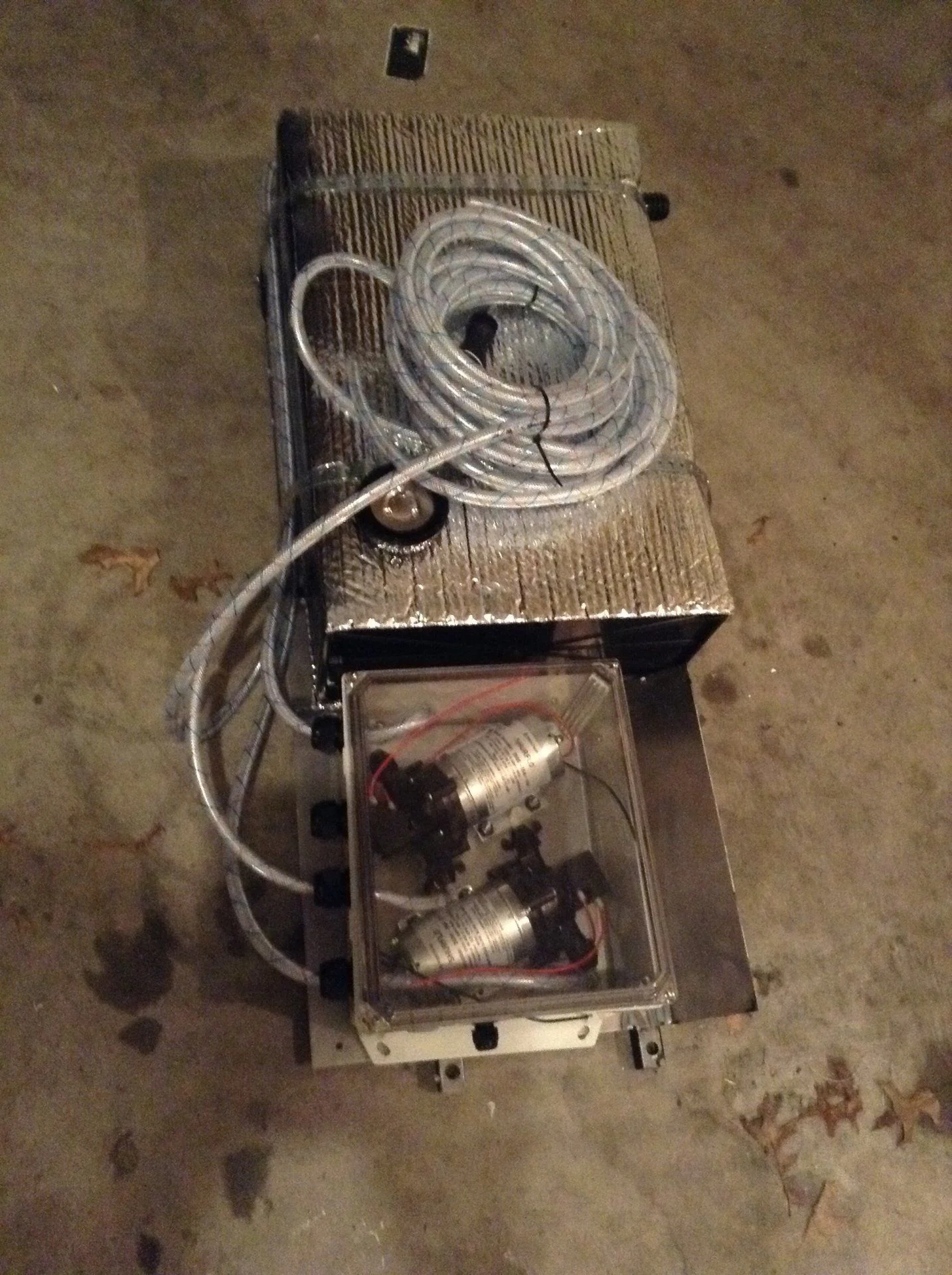

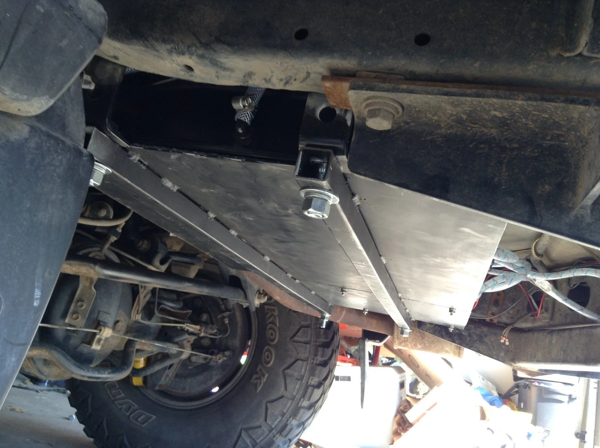

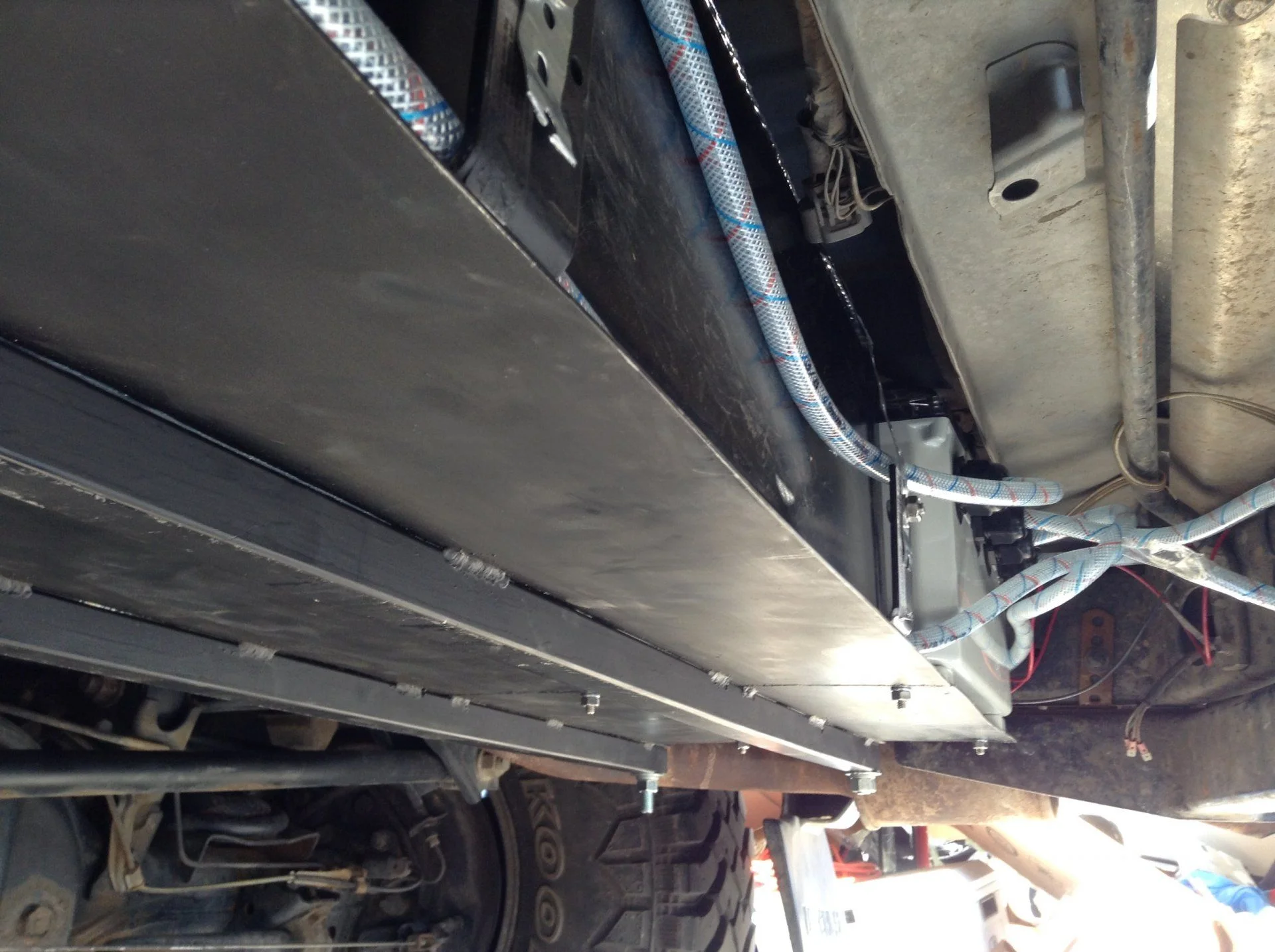

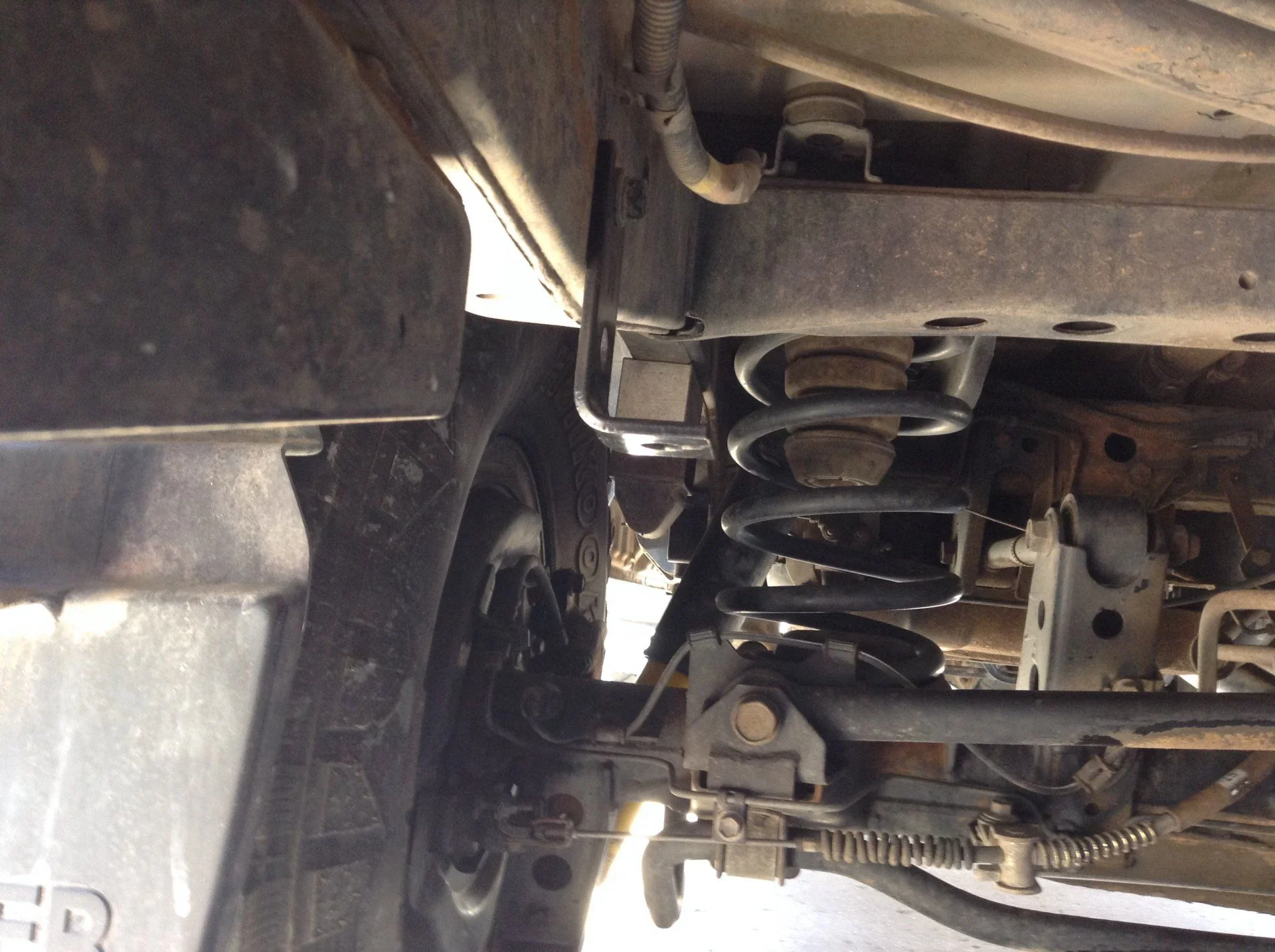

Thanks to @half k cruiser to make amazing water tank mount and shield. We worked many hours on that and it wasn't easy. Here are some pictures.
The mount itself:
Water tank with welded inlet:

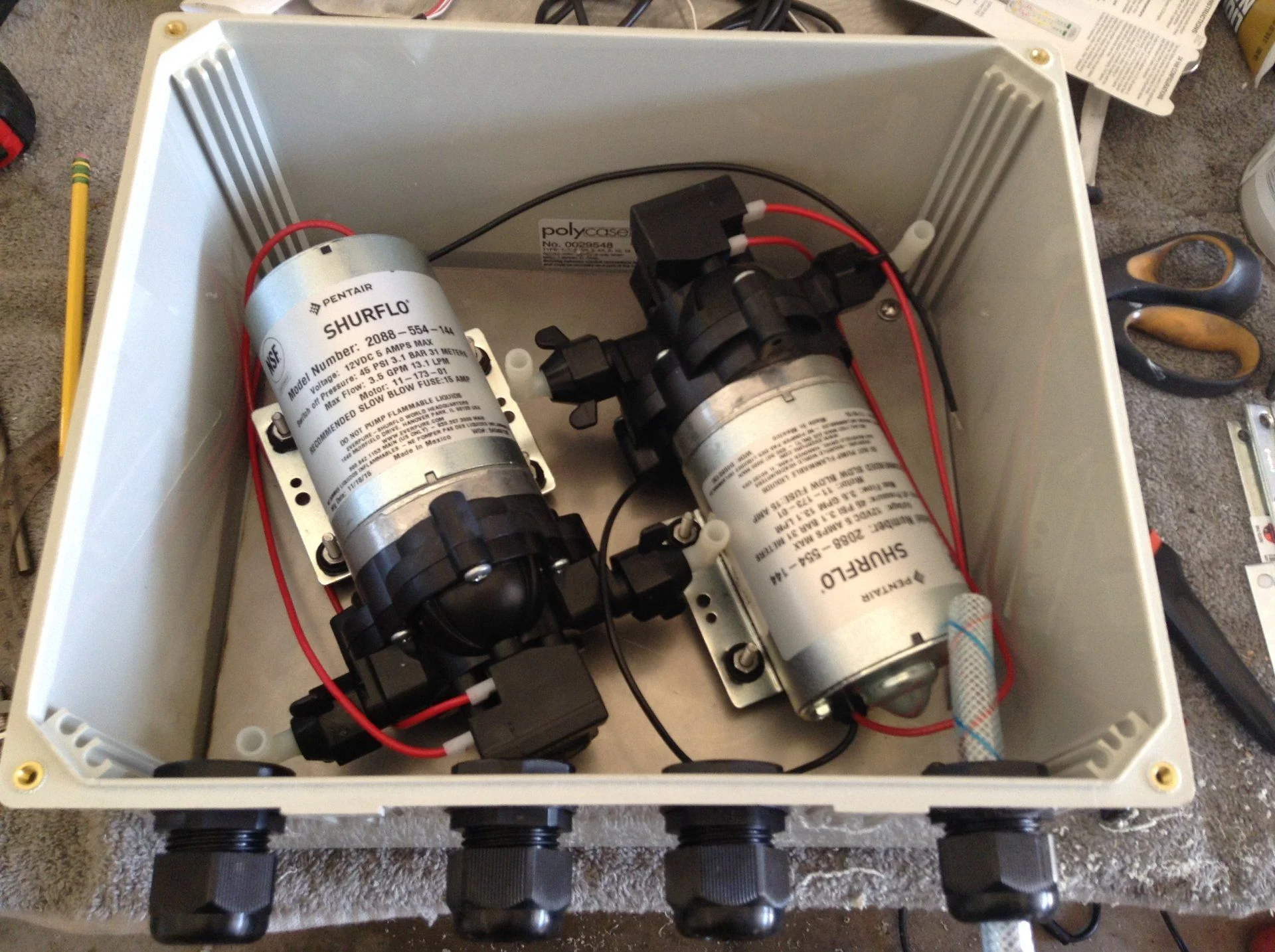

Water pumps in the box:
All together with the shield:

Mounted the water tank. Now only thing missing is the helton heater and inlet / outlet.
Some pictures:

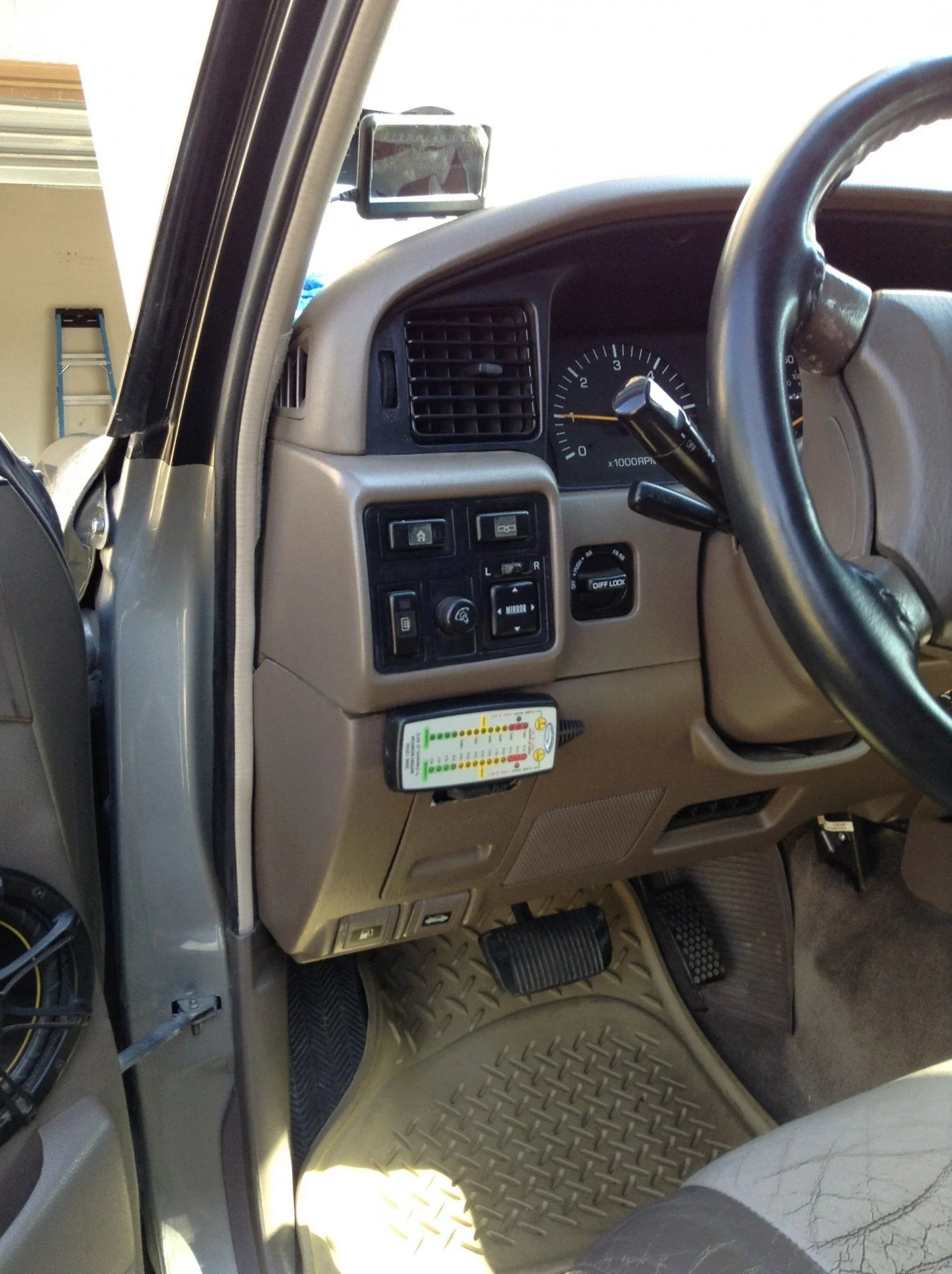

Got the national luna dual battery monitor mounted. I made mistake to not route the cables correctly so had to mount it on the left side of the panel. Doesn't bother me thou.

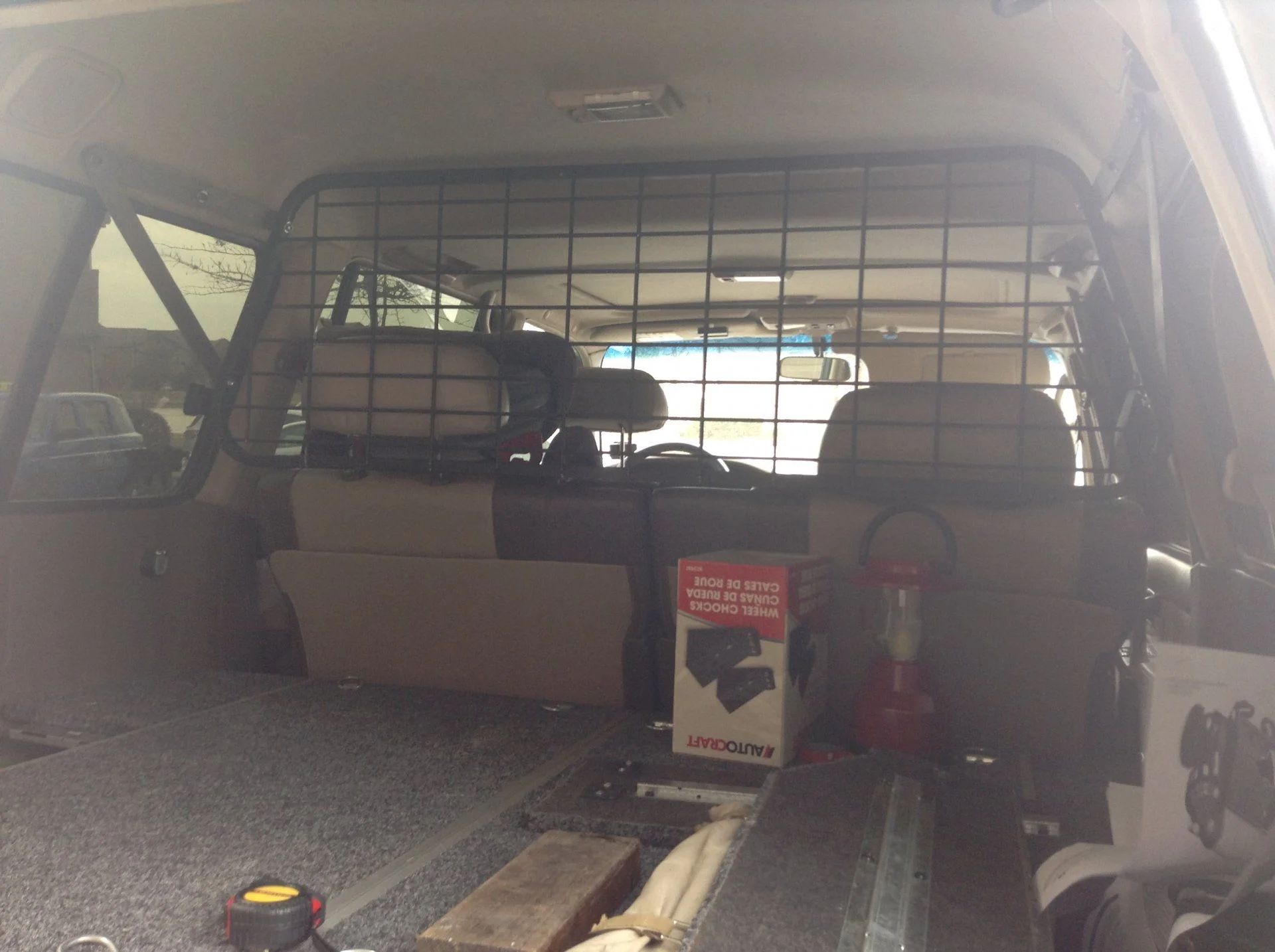

The Speski barrier is mounted. It was pain to do that but looks fine. I did very bad job painting it .

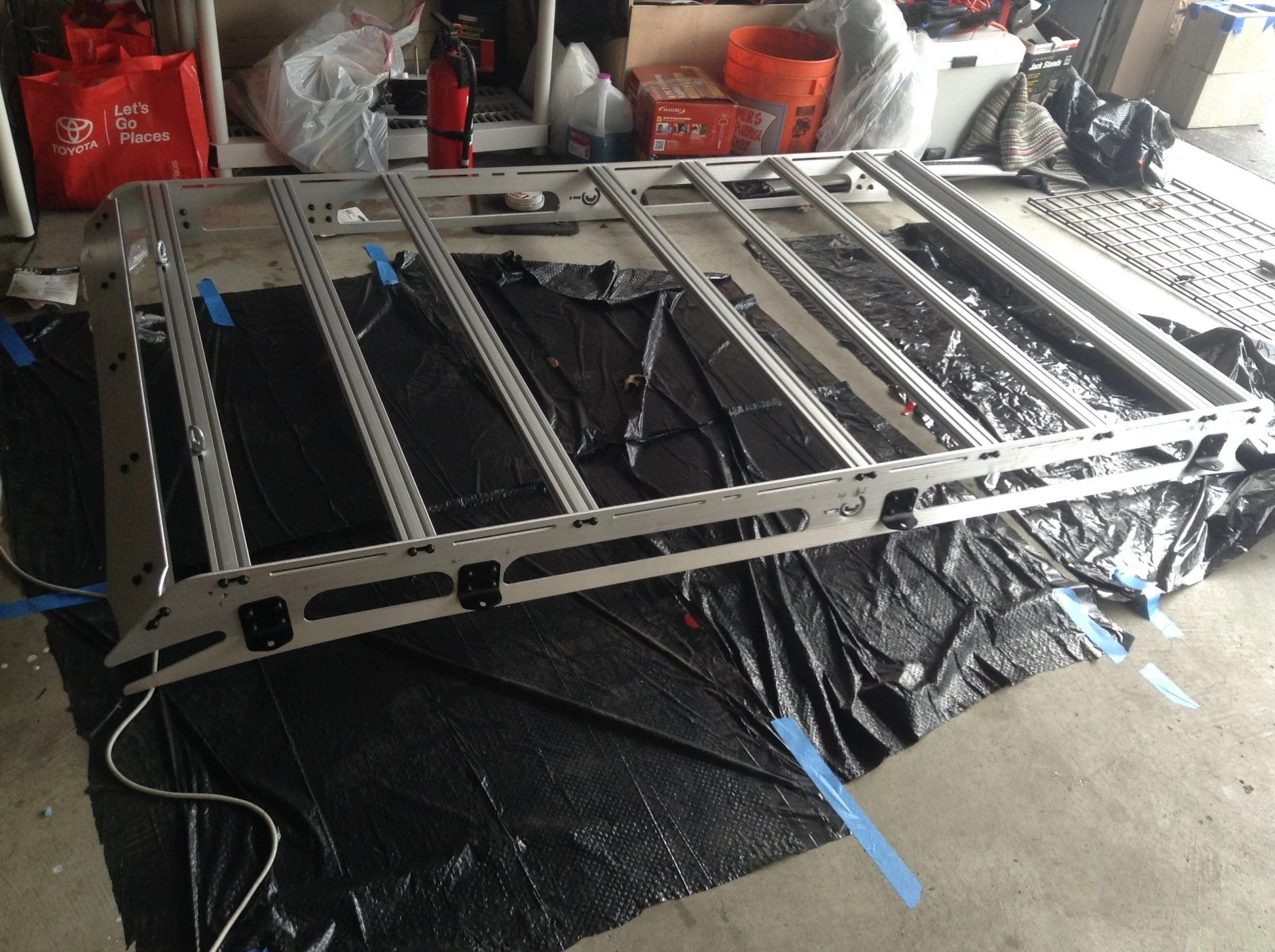

I got the Prinsu rack put together , now looking back I would say it would be better to not mount all the bars to make it lighter to lift it to the roof and then put the bars while the rack is mounted.

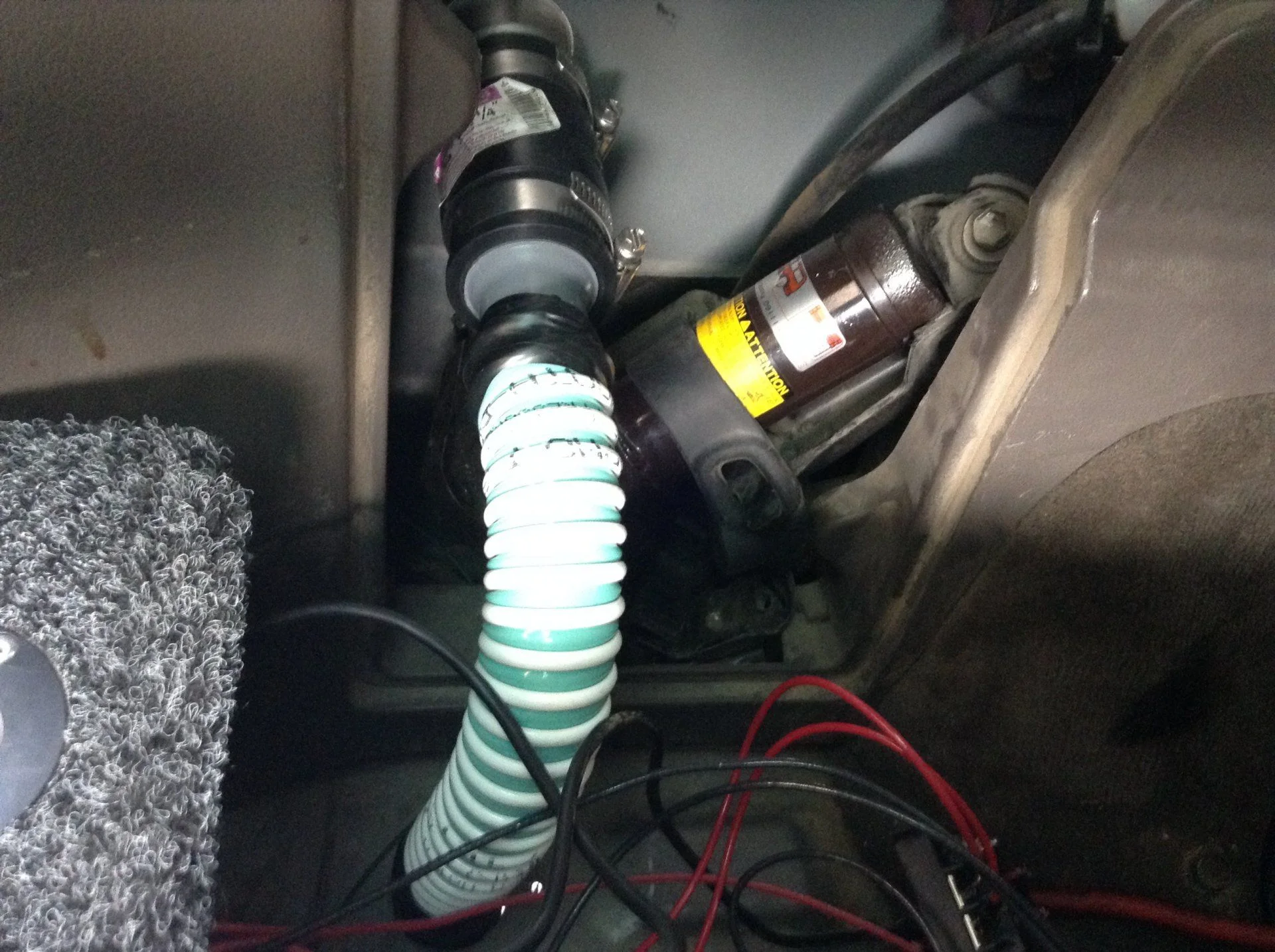

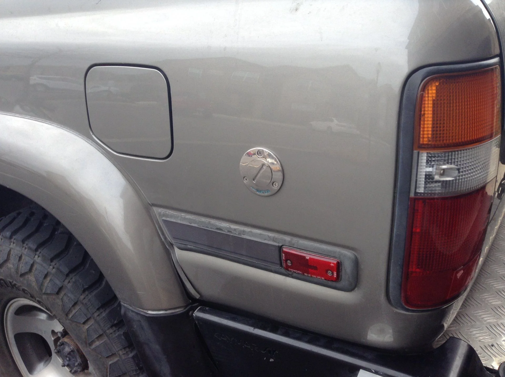

Water inlet done. Unfortunately I have now hole in Kaymar which will not be used (it was too low). I had to make another entry next to the gas cap:
This is how it looks from inside (will be hidden under the ARB drawers sides) , not nice but I didn't see any other way how to do that. Finally tested the system and it seems working fine. The only issue is with temperature sensor which I don't know how to route it to the water tank. Now it is bent in the entry of the water tank and it is leaking a bit.
